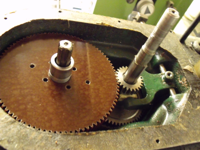

My first ever gear fits like a glove !! :eek::biggrin:
Beginners luck??? :confused::biggrin: Maybe.....:wink:

Yahoo !!! :biggrin:
Hmmm...
And I thought it was a pen that happened to look like a gear! :eek::rolleyes:
Congrats on this new endeavor, and for the record, I would have expected nothing less than complete success. :biggrin:
Looks great Skip. Bet you're having more fun restoring than you will using.
