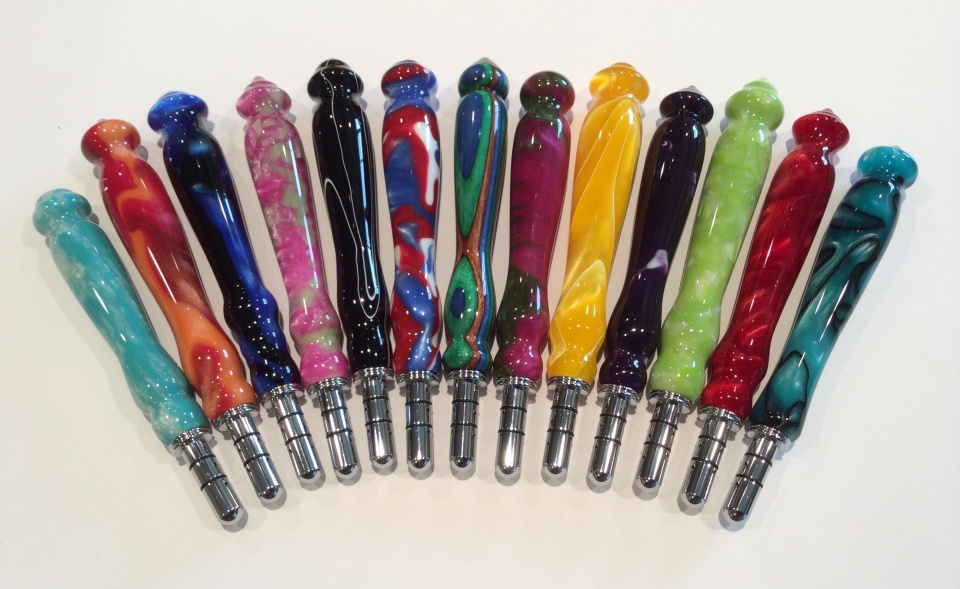

Last fall, our woodturning club participated at a local craft fair and I sold several seam rippers for $30.00. They were closed end acrylics (and 1 colorwood w/CA) using the Woodcraft kit.
A local quilting shop where my wife shops, has bought 8 of these seem rippers so far and have sold 6. I priced them to the store at $26.00 each and the store doubled the price to $52.00!
Here is a pic.

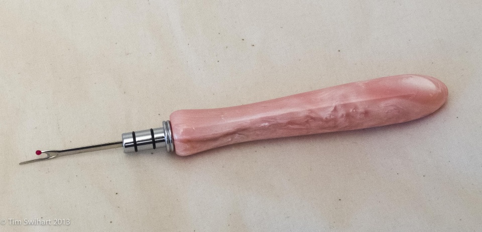

Here's a closed-end seam ripper I made as my final project of 2013. It's "Pink Coral" Tru Stone I think (I know it's Tru Stone but I'm not certain if it's Pink Coral or another similar Tru Stone).
Tru Stone isn't cost-effective on this kit, but this was a gift for my daughter so cost effective wasn't a factor. :smile:
