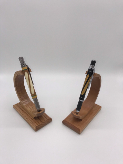

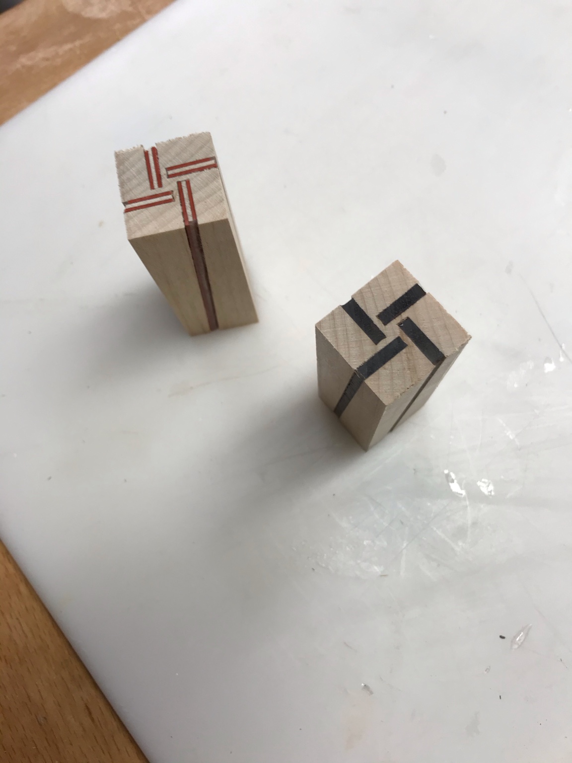

These are definitely not show off pens. My wife likes them, I find them ugly. What do you all think?
mark james
IAP Collection, Curator
Sep 6, 2012
12,752
Medina, Ohio
I'd love to be able to zoom in and get a better look. From what I see, they're a winner. Maybe not as refined as you want, but certainly worthy of further tweaks.
Very cool concept.

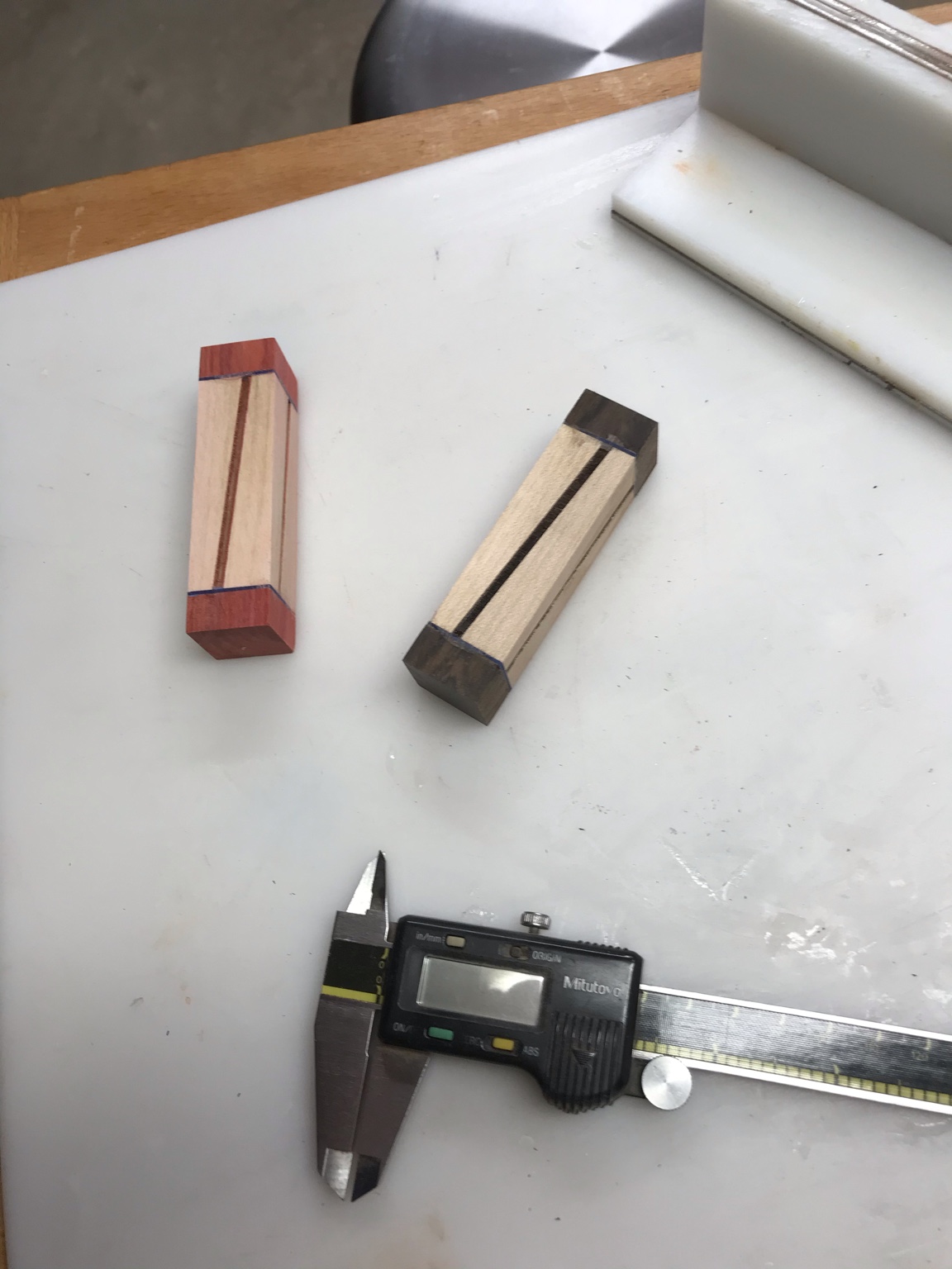

I want to get rid of the radii at the top and bottom and have clearly defined angled stripes. I think it's going to be next to impossible because I think the depth of cut needs to fall right in the middle of the thickness of the finished blank. I'll attach a bigger image if that will helpView attachment 230320
mark james
Sep 6, 2012
12,752
Medina, Ohio
Maybe part off at the point where the radii starts and extend your end caps? (If I understand your thought).

You know Ken I was thinking the same thing. If you could have used thumbnails it would help I think. Would love to see the blank up close. You have me stumped as to your method. If you could at least reveal the tool may help. You are really doing things in the segmenting fields that is getting interesting and challenging and this is exactly what I have been preaching here for some time. New blood and new ideas. great to see. I guess I will be trying to duplicate your blanks now. Thanks for the challenge as if I do not have enough to do :)
My guess is a tablesaw cut and you angled the blank. If that be the case then why not try a router and do the same thing. You will have round ends.

John I post here from my phone, not sure how to post thumbnails,my options when I post photos is small, medium, or original. I will be glad to reveal my method, but I'll wait until I am closer to perfection. Thanks much for your encouragement. I have learned much from you and I do appreciate you and others here.

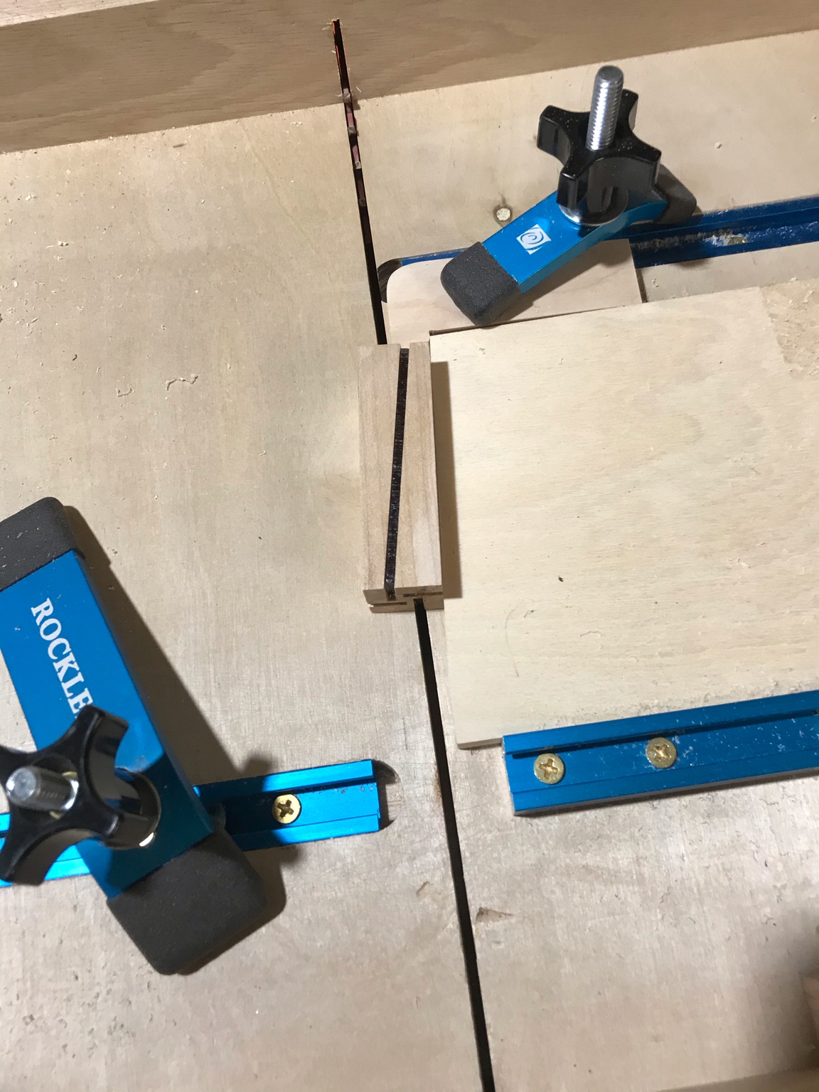

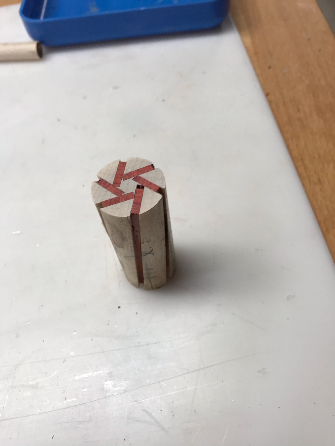

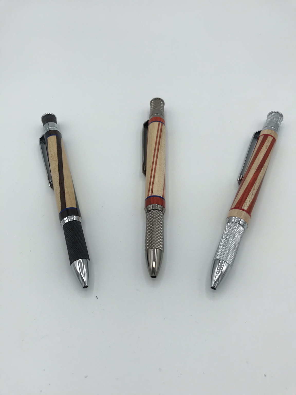

The ugly ducklings have been transformed. I changed the cut angle from 10.5 to o 6 degrees. I'm attaching pictures of my jig as well as some pictures along the way. If you can do a Celtic knot, you can do these, they are essentially a celtic knot at an extreme angle.

Thanks Ken That is what I kind have figured, That is why I suggested a router and then just use stops in the blank and you will have round corners. You could always cast them in different colors then. Nice Now you have to do an X and just reverse the angle. That is what is great about segmenting. Lots of possibilities. Thanks for showing and all great looking pens.
It is funny because I just bought a few more of those hold down clamps from Rockler. I included them in my order of the Cuban cigars pen kits that were just put on sale at 50% off. Someone alerted us to it and I took advantage.

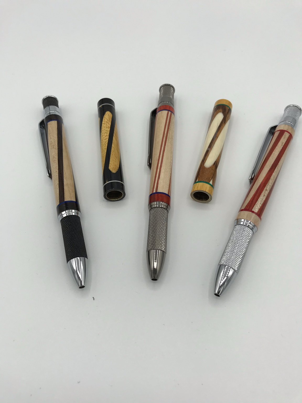

Sheer genius! Always something new here. Question- the three pens and two blanks, what is the blank, second from the right? They are all outstanding.

The "old" aka 'ugly' pens looked good to me.. but apparently your standards are higher than mine, because the redo is excellent, thanks for showing the setup / jig.
