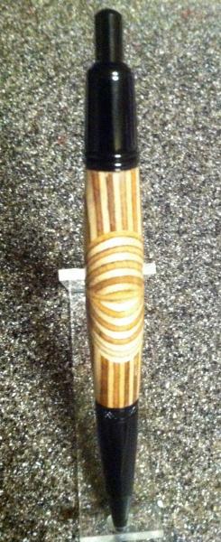

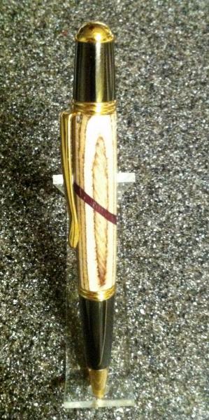

a couple of plywood pen
See more from asyler
asyler
Local Chapter Leader
Dec 31, 2009
803
bryant , ar
better pictures plywood with wedge, and plywood as a plywood 'medallion' insert
thanks
