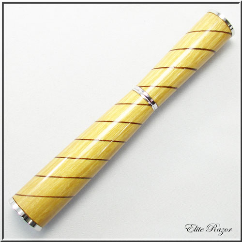

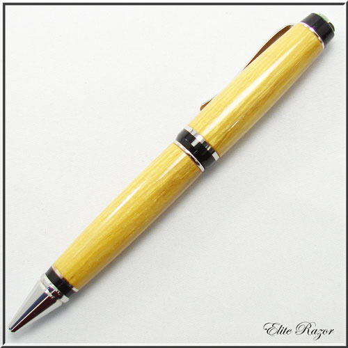

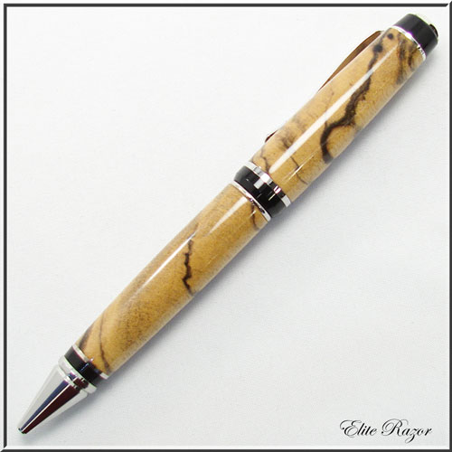

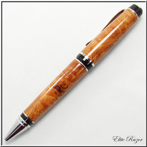

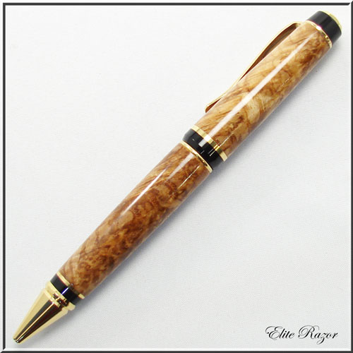

I have been using Waterlox on all of my shaving gear and wanted to try it on some pens. Below are some Cigars in Black & White Ebony, Black Ash Burl, Osage Orange, Red Mallee Burl and a Panache in Osage Orange with Walnut segments. I am very pleased with the finish and, IMHO, it has a much better feel than CA.
