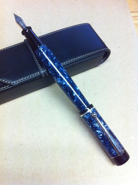

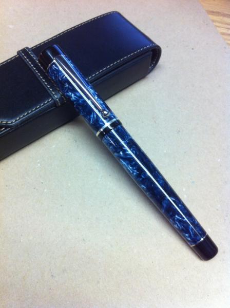

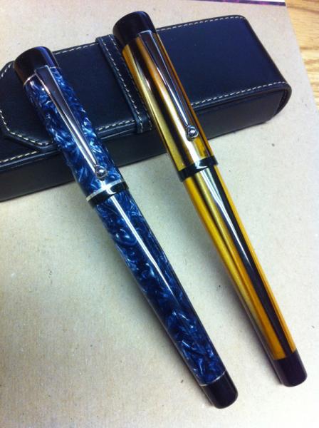

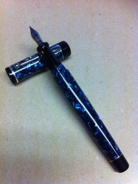

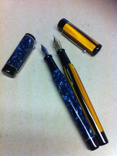

I am not sure what the blanks are called but they are both from Exotic blanks. The blue one has a Jowo #5 medium nib with silver accents.

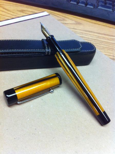

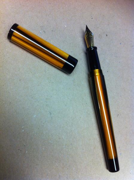

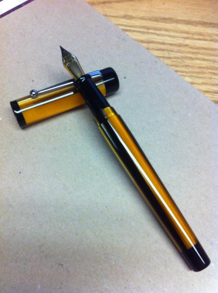

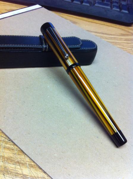

The striped one has a Jowo #6 fine nib.
Thanks for looking

Colin,
Could you give the dimensions?
Tony
My pleasure
Body
14mm diameter x 90mm length
M12 x .75 body to cap thread
10mm Finial is attached with a M9 x .75 thread and the washer is 24g silver.
Taper is 1.5 degree from 10mm diameter at finial to 14mm at 25mm in from cap thread
Section thread is M9 x .75
Cap
15mm diameter x 58mm length
Finial is 9mm thick and is attached with an M10 x .75 thread
Finial accent is 24g silver
Band is 1mm x 1mm square silver formed and soldered
Lower black cap band is 2.5mm thick and it and silver are epoxied to a 14mm tenon in cap.
Clip is Rhodium plated but I don't remember where I got it.
Colin
