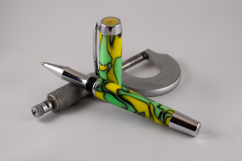

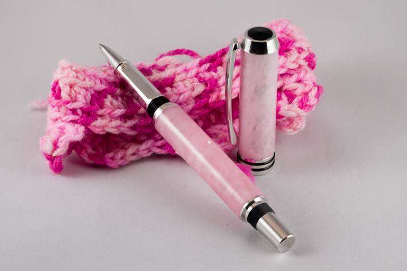

Lately I have been working my way through some different blanks to see how they come out. The pink one is quite nice, but I'm not mad about the green one. Oh well, it's always interesting to see how they turn out.

I like them both very much ... and you have made good use of props to accentuate the colors.
What pen kits did you use for each ?

Both are very nice! Did you add a custom finial to the green one?
Hi Tony, no that is what came with the kit.
The kits are SN Gent for the green one, and Tycoon Rollerball for the pink one.
The pink one is platinum coated.
I made bad mistakes on both of them. The pink one has bubbles in the glue between the brass and the blank. It kind of looks ok though because it gives it some depth. I think it looks like its made of melting pink ice.
I damaged the tube paint on the green one when I was gluing it up. I can see a shadow through the blank which I find destroys the look for me.
Each time I make a pen, I seem to find a new way of stuffing up!!
