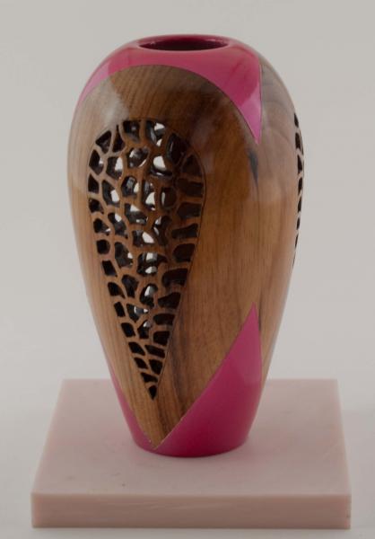

Myrtle Hollow Form pierced and airbrushed metallic Candy Apple Red. Could not get the color balance right in the photo which makes it more pink looking. Around 5" (13 cm) tall. My second hollow form. This offered a couple challenges. The wood really needed an oil finish to bring out its beauty, but that made paint adhesion tricky even with an interface coat of Shellac. My first experiment with Candy colors. Final finish is EM6000 waterborne lacquer.

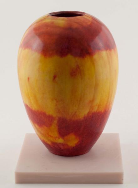

Poplar Hollow Form dyed in a Chris Pytlik style. I saw a demo on this technique by Chris at Totally Turning 2012 and decided to give it a try. Around 6" (15 cm) tall. My third hollow form. Bleaching this prior to dying proved to be a challenge. I used Hood 2 part bleach, and that got rid of the green streaks, but left some red streaks. Finished with EM6000 waterborne lacquer.

Ron - Normally I use an NSK Presto for piercing like this, but on my recent pieces I am experimenting with a cheap alternative. This is a cheap $20 dental handpiece from eBay, add in hoses and fittings and I am probably in for around $50. I still prefer my NSK, but this is not a bad alternative to try it out, and let folks play with. If they over stress it and damage the bearings, a $20 replacement for the whole thing compared to $125 just for a new turbine/bearing cartrige for my NSK is easy to deal with.
Scott - The pink look is really odd, I never seem to have color shift issues in the past with my photo tent. I have the right lighting and stuff.
