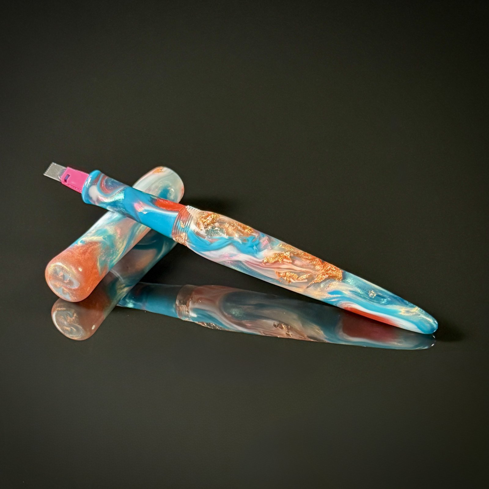

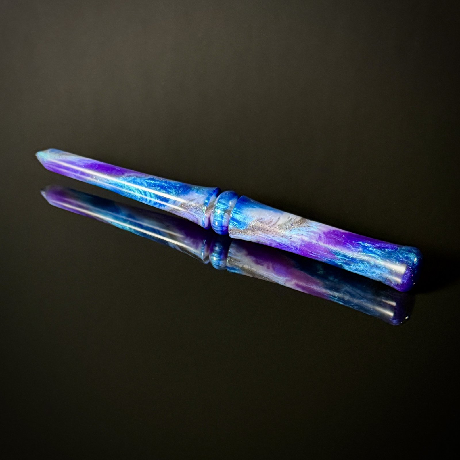

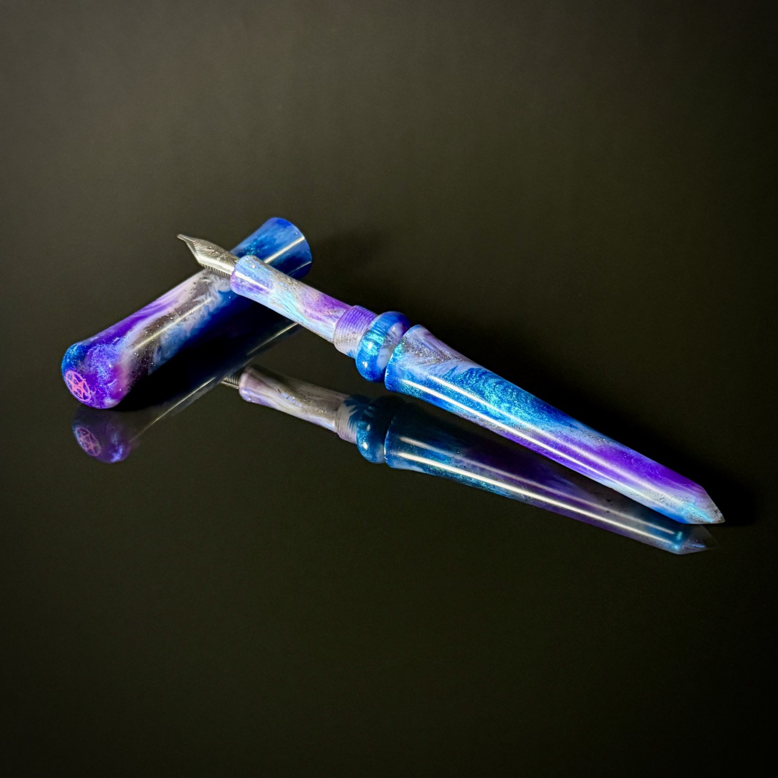

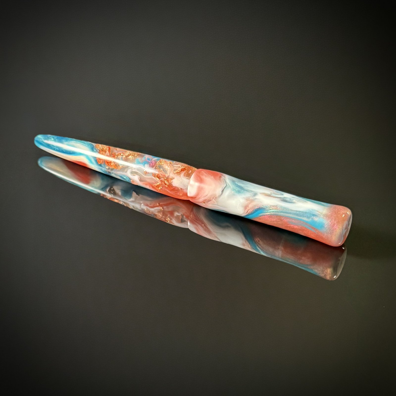

These are two new models I have been working on. The first one is The Battlemage in my Yoru no Ryūjin resin. The second one is The Sorcerer in Crash and Calm resin from Zogg Analog Studios. Both of these will be on my table at the Chicago Pen Show in May.

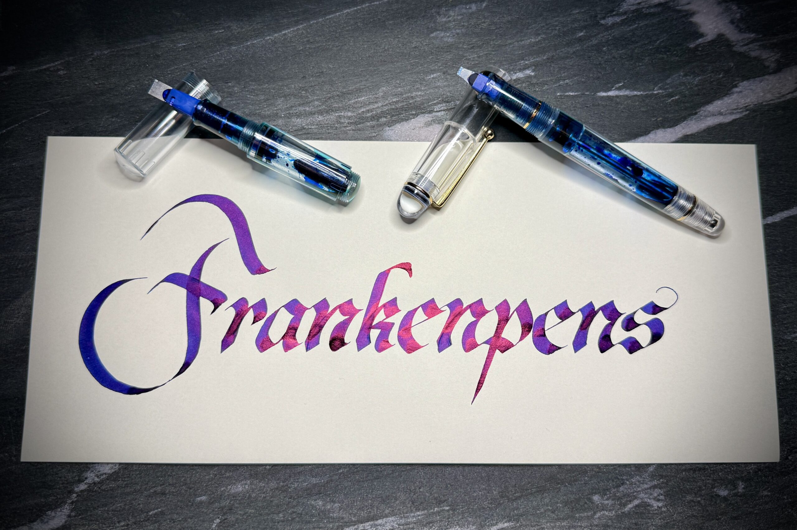

Thanks! The nib in the second photo is a Pilot Parallel nib. They are not sold individually but the pens they come in are inexpensive. I designed my own sections and nib housings to hold them.
I have some links to purchase them on my blog here:
I thought that was a Pilot. I have one and wondered if I could make my own pen and use the nib. I did that with a very old Schaeffer calligraphy nib. Thanks, I bookmarked your site. You do beautiful work.
Thank you! Making Parallel Frankenpens was partially what got me into making my own pens. You can actually fit them in a variety of donor pens, though some things work better than others. It took me a few iterations to dial in the customs, but I have now settled on a design I like. I prefer to eyedrop them, but I also fit them for Sailor Converters for my customers that don't want to eyedrop the pen. My original design used a Schmidt K5/K6 International Converter, but wrote a bit too dry for what I was looking for.
I haven't really kept up with blogging as I got more into penturning, but I have an article about Parallel Frankenpens on my calligraphy website if you are interested. Besides my own pens, my favorite Frankenpen is the Moonman/Majohn Wancai mini (at least the Gen 2 version as I haven't tried the newer ones, and I don't know if they changed anything). Opus 88 jowo 6 models also make great frankenpens, though I have grown to prefer my own sections. I would like to try making a Japanese Eye Dropper myself, but I think I may need to get a metal lathe before I can pull that off.
