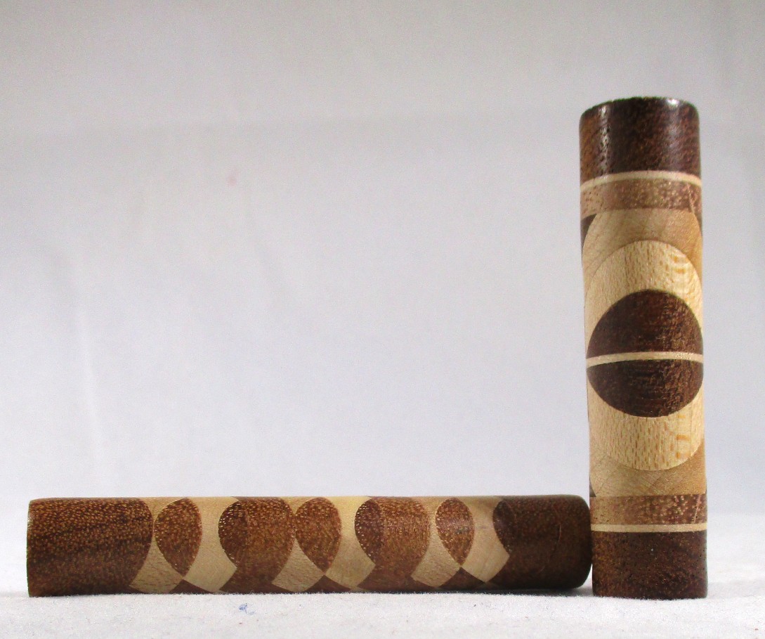

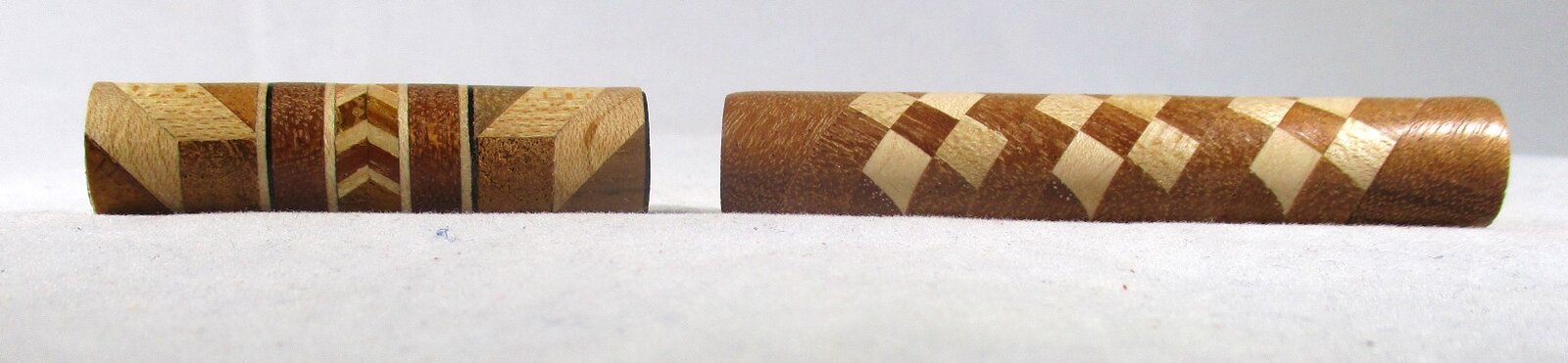

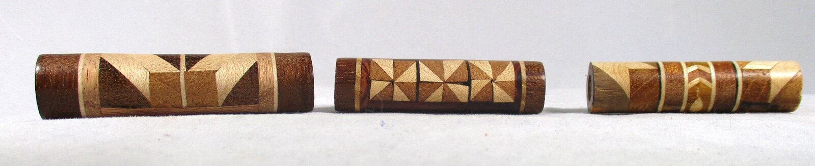

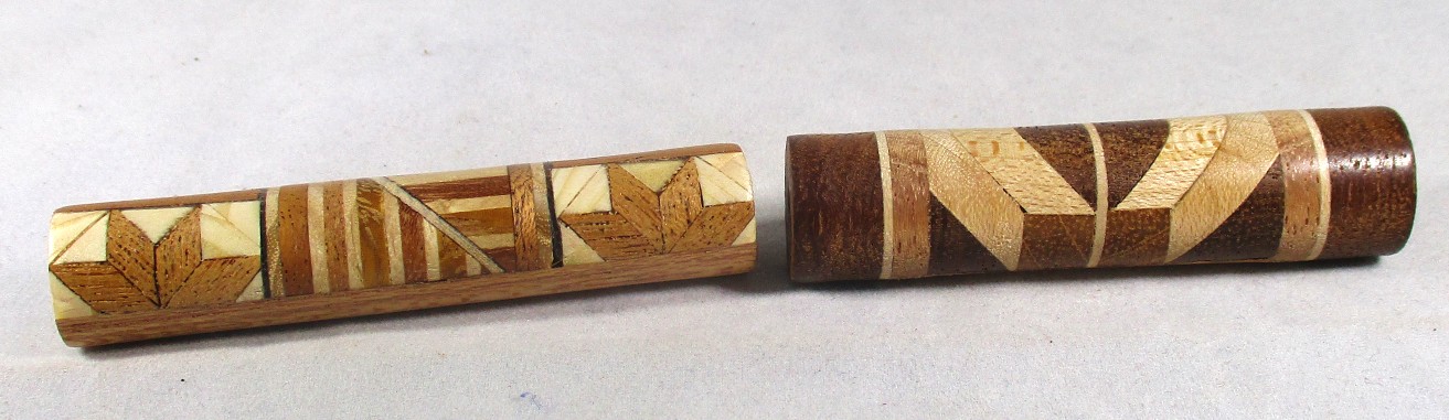

Still playing with yosegi-like patterns ( still a bit rough and they have little inaccuracies in places )
Critiques welcome.

Those are beautifully done !!! . Thanks for showing !!!
Please tell us again what "yosegi" actually means.
Also, could you show us an assembled/glued blank before you turn it ..... that would give me a better idea of the "starting point". . Thanks !!!

Hello Mal. Yosegi is also called Japanese marquetry. The process can be seen on youtube if you look up 'Yosegi zaiku'
I have some photographs in my media though I will try to post more detailed ones when time permits. My focus is getting my veg growing now.

Very nice. I have been researching Yosegi since I saw your last post. The symmetry on the chevrons looks really nice, The spacing looks pretty even. How did you get the spacing to appear even?
