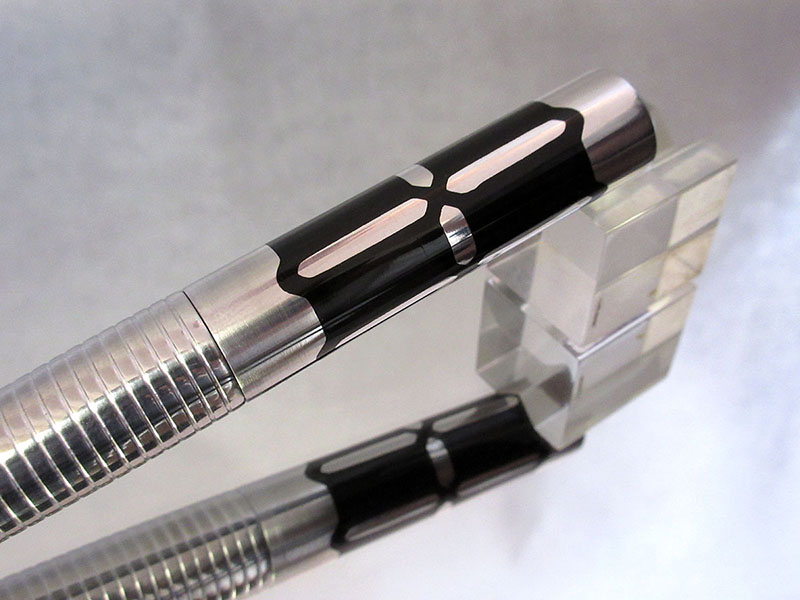

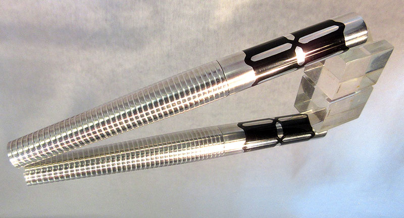

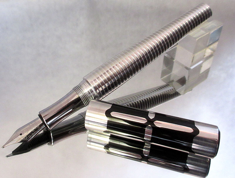

A closed end kitless fountain pen, with an etched & cast lid.
See more from BradG
BradG
Jul 10, 2011
1,735
Blackpool -UK
I turned the pen body with quite a significant taper, and then ribbed it with light cuts spaced 2mm apart.
For the lid, I turned it to size and threaded, then etched to depth great enough to hold Polyester Resin. The piece was then cast, and turned back down to dimension - with a lot of sanding.
Thanks for looking :)
