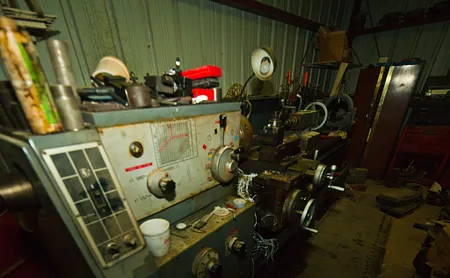

My biggest Lathe is made by Hercules It is a 25x 80 with a 25 hp motor .
I have no idea if its the same company or not , I have never had to order any parts for my lathe yet but the brake isn't working right .
I like my Hercules lathe
I hope your Hercules table saw works good for you like my Hercules lathe has worked for me .
