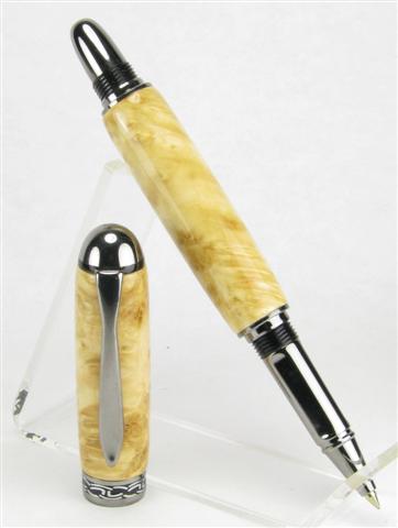

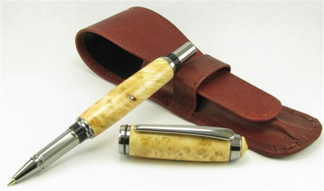

So here for your critiques and comments are 2 of my latest pens.
attachment.php
attachment.php
The pens have been turned from a slab of Manitoba Maple Burl that was sent to me from a friend.
Both pens are finished with 12 coats of CA, sanded lightly with 600 grit after the 1st 6 coats. They were then wet mm'd ( with a few drops of liquid dish detergent added to the water) from 1500 grit to 4000 grit.
Buffing with Formax Buffing Compound (Extra-Fine 515-6165) followed by a buffing of Carnuba Wax.
Any and all comments/critiques will be appreciated. Any comments and/or tips you may have with respect to posing of pens would be greatly appreciated as well.

I, for one, like seeing what you are doing Mac! :smile:
I like that you made the custom finial on the first one. Next time maybe you will replace the black ring on the centerband too! :wink:
Mack it would be a shame if you quit posting your work. It shows us less experienced turners what is possible and gives us something to aspire to. I may not compliment all the time but like all your postings.

You know me Mac so I am saying this as a friend, continue posting and sharing both your pens and ideas. Stop worrying about view counts or post counts. Some people are just too vain. :smile:
I am guilty of it too but i just don't have the time to post to all pens shown and answer all threads. I do try to stay in contact somewhat.
Your work speaks volumes and is always a pleasure to look at. Now as far as the photos go it is amazing how a blank with light colored features gets so lost in a white background. Dark colored blanks get lost in a black background. Unless you have the perfect lighting setup then you maybe able to pull it off. I would say safely to show the light colored pen you need a darker background. That is why I chose grey these days because it is like a middle of the road look.
The timber used on this pen is fantastic and really needs to be seen in a better light. I would not change the centerband because it breaks up the blank well. So that is my 2¢.

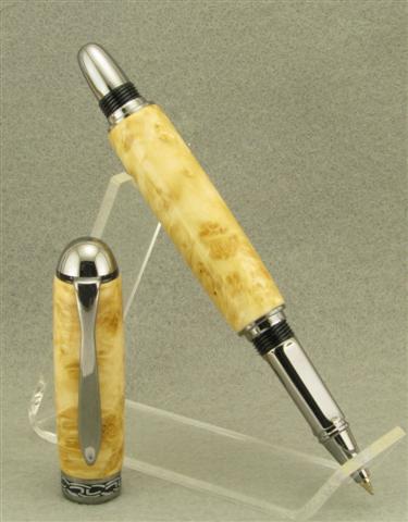

Is this a better pic?
Mac

How many like this pic better than the 1st one?

Great looking pens Mack. I always enjoy seeing your work.
I think that the pen pops out at you in the first pic and I prefer that.

Great looking pens. I would have probably gone with gold hardware, but after seeing these, the silver (black titanium??) really looks great! Good choice
I am no fan of the threads on the Sedona pen but I do like the looks of it and I love the look of Maple on yours. Maple looks like boring every day wood until you put some CA on it, then (at least to me) it explodes with character. Nice pen. :O)
Hi David; When I had the Sedona finished I went to get my Gold Ti. kit to put on it, and discovered I only had Blk. Ti. & one Chrome kit. So, it's the Blk. Ti. that I used!
