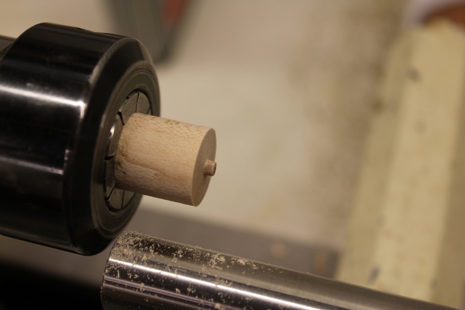

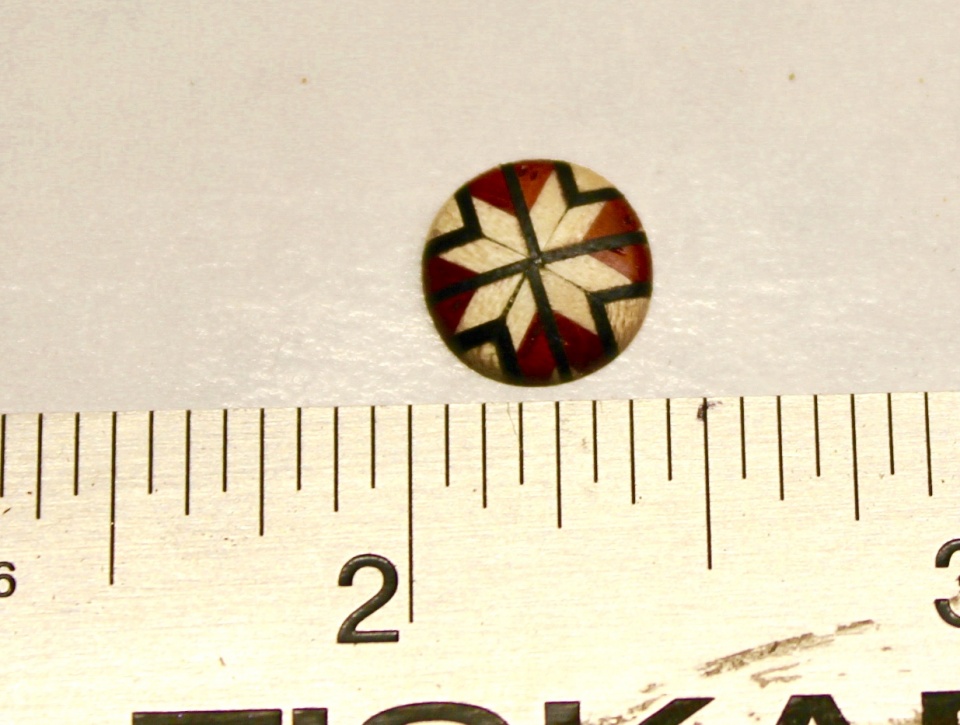

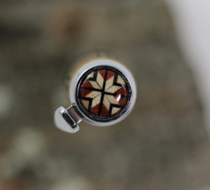

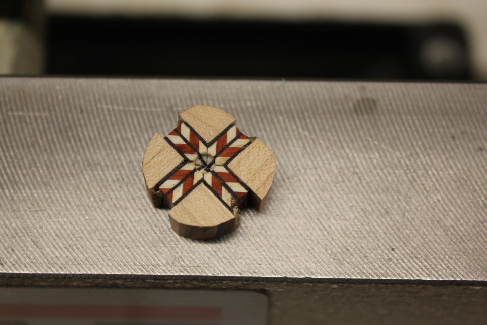

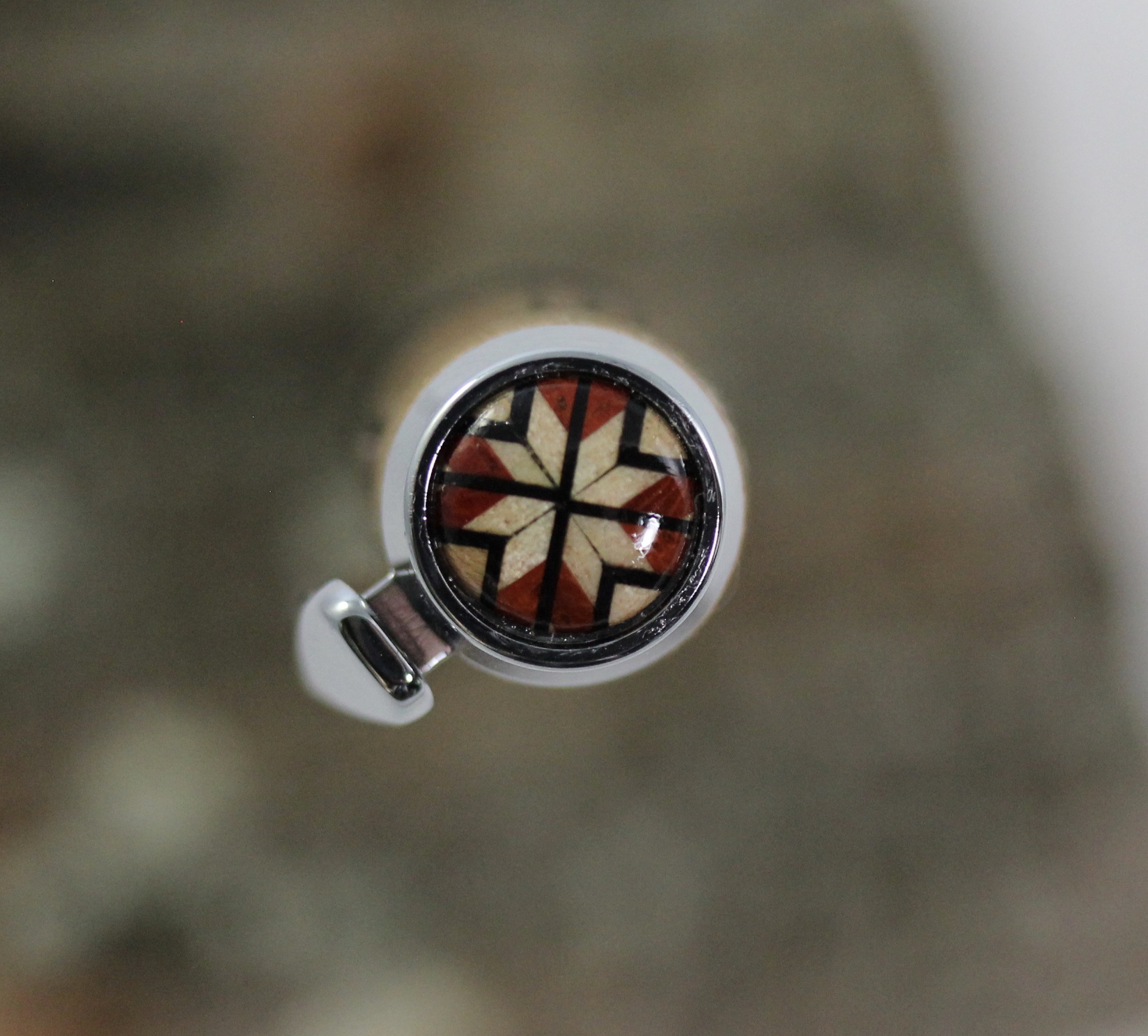

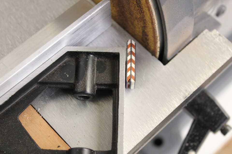

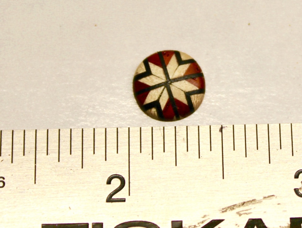

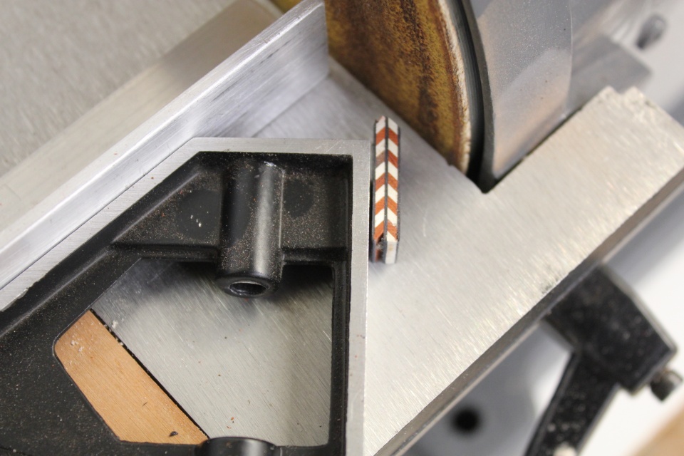

Tried this last year and the alignment was not good, this is better. I won't nit pick the minor flaws, but there is room for improvement.
FWIW: Byrnes Model makers Table saw; Byrnes Thickness sander; Craftsman Table saw; Disk sander; magnifying glasses. Padauk, Maple, black veneer. Finish with 6 coats of WOP.
Comments and suggests welcomed.

Also, I assume you have enough from that blank to do a dozen more or so?

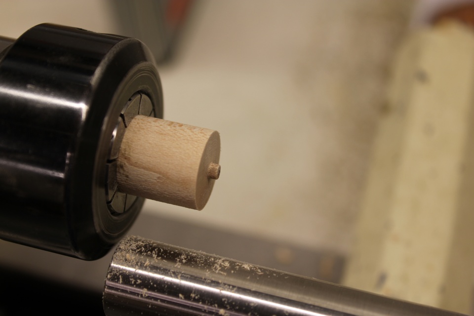

The finial was not made from a blank (ie, like a polymer clay "cane"). It was constructed from left over pieces of the Chevron inlays. So it's basically a one-off. However, I do have lots of left-overs :tongue:

That is really amazing work Mark. Can you put guess on how long you worked on that pen?
Hi Jason, A rough estimate:
1. Making the block for the Chevrons - 2 hr (enough for 3 pens).
2. Making the actual Chevron Inlays - 1 hr.
3. Gluing up the Chevron Blank - 15 min
4. Typical drill, glue, turn, make the end caps, etc - 1 hr
5. Make the Finial - 30 min
6. Turn the finial - 15 min
7. Assembly - 10 min
8. Finish (I use WOP multiple coats 6 hrs apart - 2-3 days).
so over the coarse of a week, about 6 hrs. But then I don't sell pens, just give them away or my wife snags them, so I'm not in a hurry.

G'Day Jay:
After getting the Chevron inlay spacing close to good - the finial was just trial and error for how to get the alignment close. I got lucky and this was only the second try. In spite of a bit of tweaking, I am pretty happy with the result. Close enough is at times close enough! Getting too old to be too fussy...
