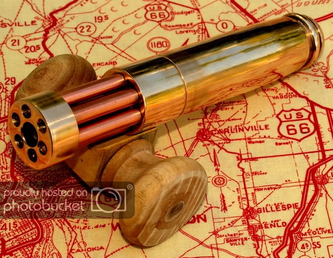

I built this for fun, for the casing pen contest in the activities section that is going on till the end of the month.

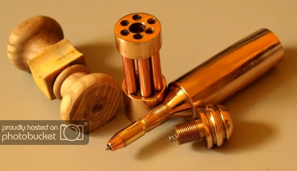

It's a rollerball pen. The end of the pen unscrews to change the refill. The nib is a 9mm luger casing and bullet tip. The majority of the pen is bronze rod. The cap is bronze with copper tubes drilled on my drill press with a collet indexer. The cap is actually screwed together with brass screws and the copper is just tubing sleeved over the screws. The the tops of the screws were drilled away leaving the barrel holes. The cap was a frustrating build for a while, the entire pen was about a 9 hr build.

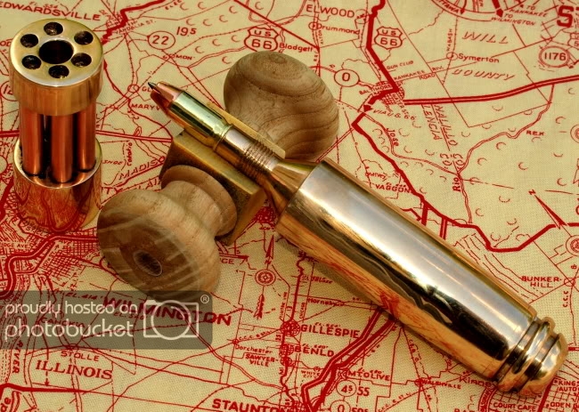

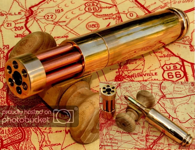

Thanks! Would anyone be able to take pic 2 and shrink and place it in the lower corner of pic 1 so that I can upload it into my album as a single pic? I do not know how or if my camera software does that.

This is the best I could do with Image Cave. Photoshop is on my other computer and we're not getting along right now.
