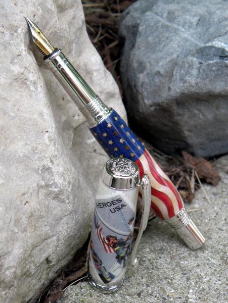

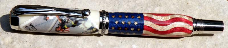

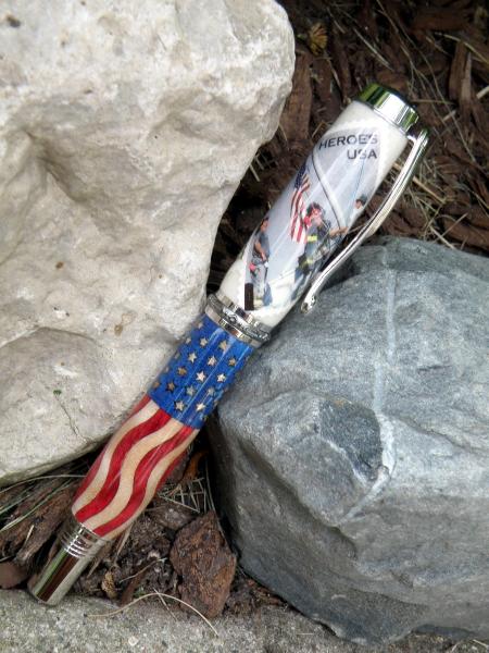

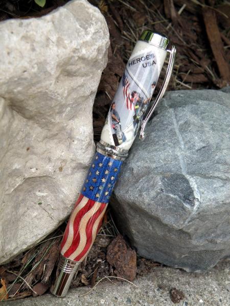

9/11 Tribute Pen...additional photos added
Added photos...
It is a Jr. Statesman. I had Constant create a flag with his laser that fit just the body of the pen.
I then turned some alternate ivory for the cap and layed on the 9/11 stamps covered with more coats of CA then I can count.
It was a lot of fun to create as this was my first attempt at stamps and a flag blank.
Thanks for looking!

Very good job on that pen. Very nice kit to go along with it as well. The stamps and the flag were both done nicely.
Eric, once again I belive this pen belongs on the front page and to me the photo in the box or the second laying on the stone is the moneyshot. Can't say more than that. Great idea.

I have decided that this is my most favorite pen that I have ever seen. I'd like to try to duplicate it so I can have one for myself. I wonder if it possible to find any of those stamps?
Thank you! It is a very special pen, which I have decided to put up on my website as too few people see it at my house. The cap was created with alternate ivory turned down to just below bushings. I then used mod podge to affix and seal the stamps to the alt. ivory. After the mod podge was dry, I applied many coats of medium and thin CA until I couldn't feel the edge of the stamps anymore. I then used 600 grit sandpaper to smooth it all out and worked up through the micromesh pads.
Hope that helps. And I feel it an honor to see duplications of this pen as we remember our heros.
