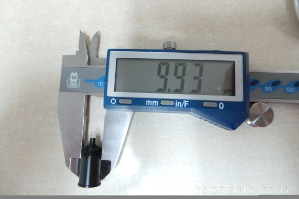

Sorry to argue the point, but the 380 housing is definitely 10 x 0.5 as per my original post above. I'm not sure what Bock themselves may be referring to but if you invest in an M8 tap I'm afraid you're going to be upset and disappointed.
