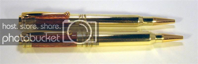

I had a customer request a shell casing pen from some 7mm Magnum shell casings she provided.
"Sure" I said. Everything went smoothly until I realized that the slimline nib is larger then the end of the casing. I know I could use the actual 7mm bullet but I didnt have one and wasn't sure on the drilling anyway so I glued a tube into a piece of wood and turned it round so I could hold it in a chuck. I pressed the nib in the end and with a parting tool cut down about 3/32 of the wide end of the nib. Much closer fit now. The piece of wood with the tube in it then became the blank for the upper barrel,
This makes a nice large pen that feels great in the hand
7mm Magnum and 30-06 casing pens with Caribbean Rosewood
Comments welcomed, Thanks for looking

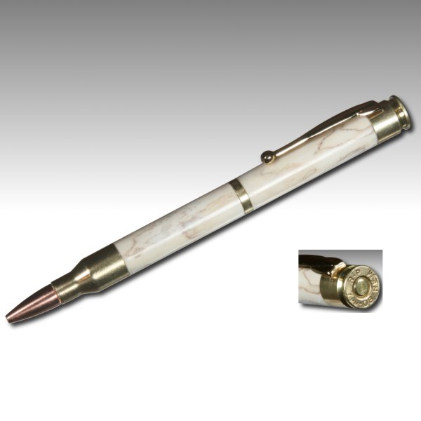

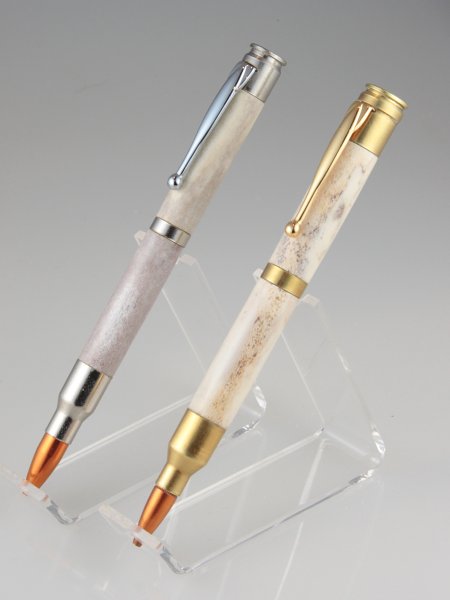

I prefer to stick to the cartridge caliber and use a real bullet. Then you don't have to worry about matching neck diameter to nib diameter. I also think it looks better. For the sake of comparison, here's a 308 Win cartridge pen next to a 7mm RemMag cartridge pen (both with bullet nibs). Also shown is a 7mm-08 pen which has the same case diameter as the 308 Win pen, and the same bullet diameter as the 7mm RemMag pen.

I tried something like your idea today. I am still confused on how you attached the clip to the head. How'd you do it. If you'd rather keep it a secret that's okay.
Beautiful pens.
splinter99
Dec 31, 2005
924
Bunola, PA, USA.
Jgrden..It is assembled as you would any slimline..the cap is pressed in to the tube wich is inside the casing,(the segments are drilled out to accept the brass tube) Looking at the ones posted by Sylvanite,,It appears that he recesses the clip, but I opted for the easy way out (His pens are beautiful though)
I hope this makes sense
