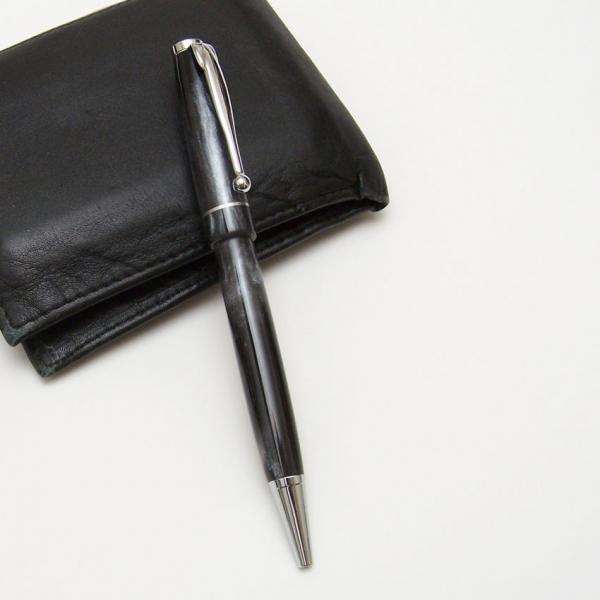

You may want to investigate the many variations on a slimline like described here http://www.woodturnerruss.com/Pens.html
When your ready to try some of the more expensive kits, PSI often has specials that include the bushings, drill bits,and trimmer sleeves included with the kit often for the price of the kit alone.

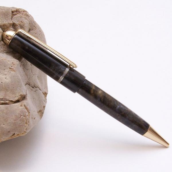

Most of Russ' mods can be done to Euros too, for a pen with a bit more girth.
The one with silver hardware is a slim, gold hardware a euro:
