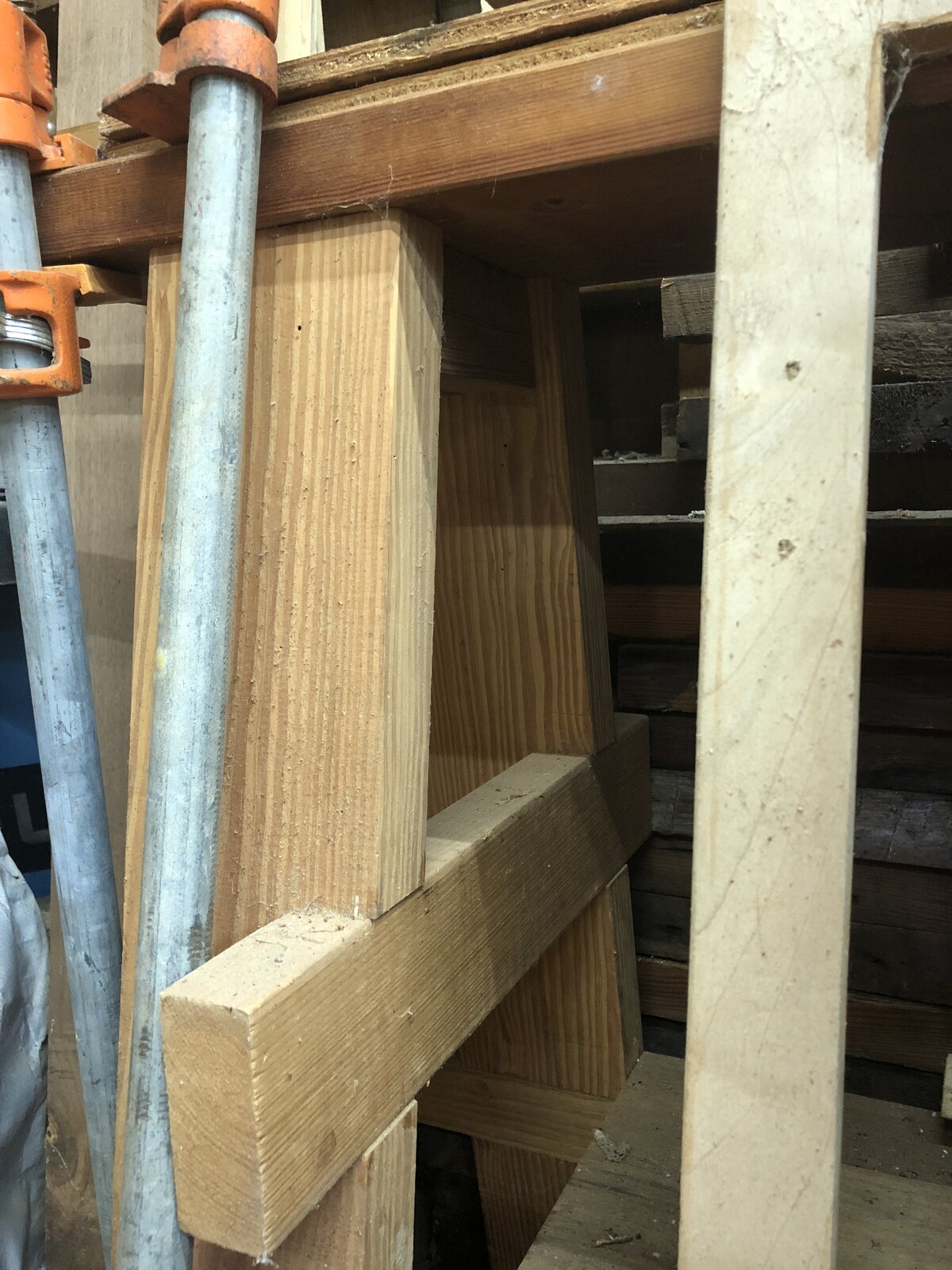

For a stand, make a sawhorse on steroids:
2" X 10" (or 12") top fastened to 2" X 6" legs.
Top and bottom of the legs are mitered at 12-15 degrees, depending on what you're comfortable with.
Cross members joining the legs at the top create an attachment location.
2" X 4" (or 6") cross members dadoed into the legs will be completely stable. No racking. You can add sandbags for ballast if you get heavy, out of round rough stock.
It took me about 1-1/2" hours to make one.
I'll see if I can get a picture uploaded...
I sold the lathe which was bolted to it but I kept the stand. Right now, it's storing 'stuff'.
