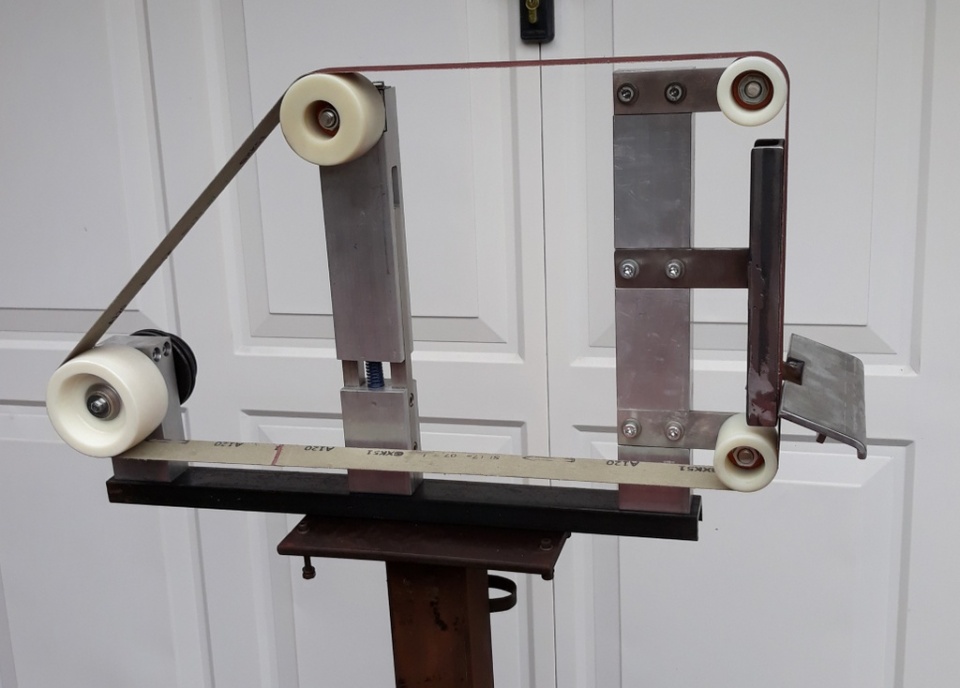

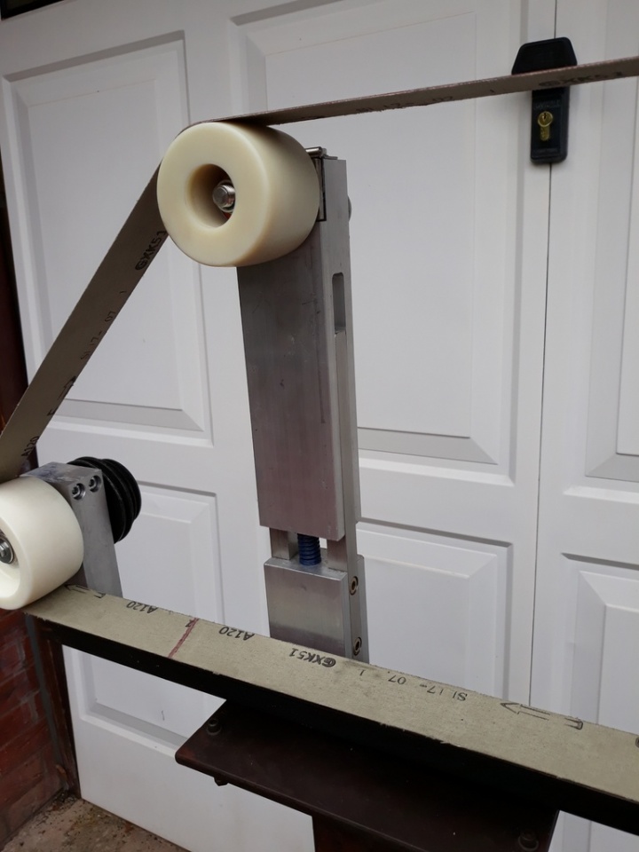

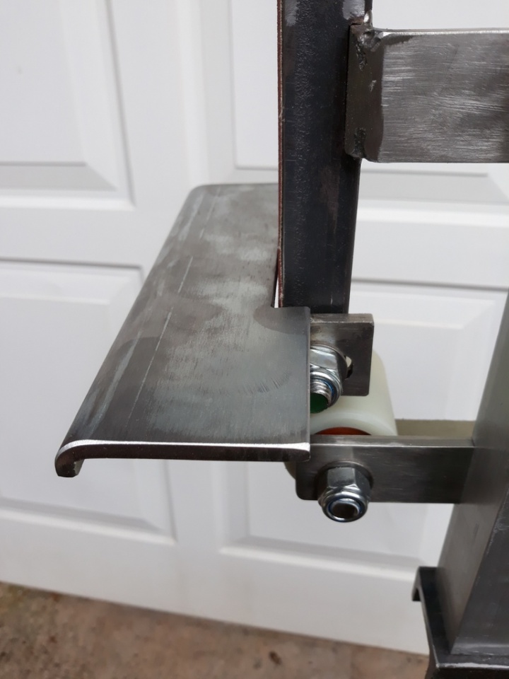

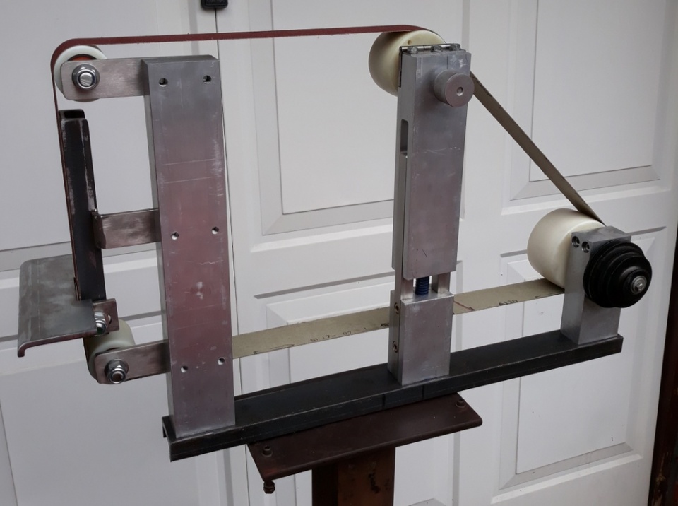

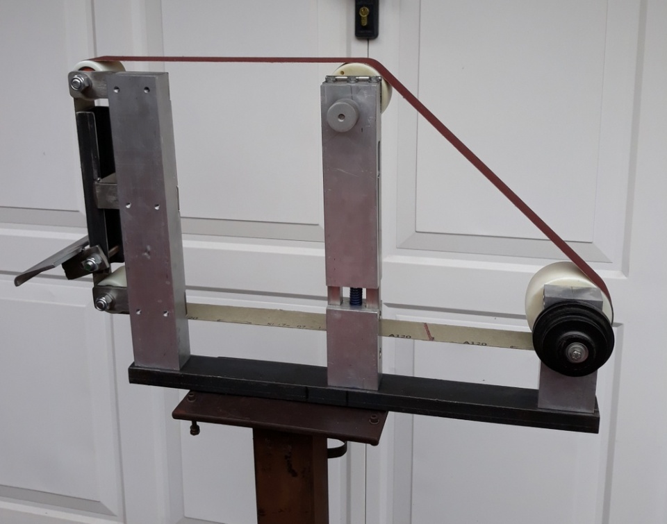

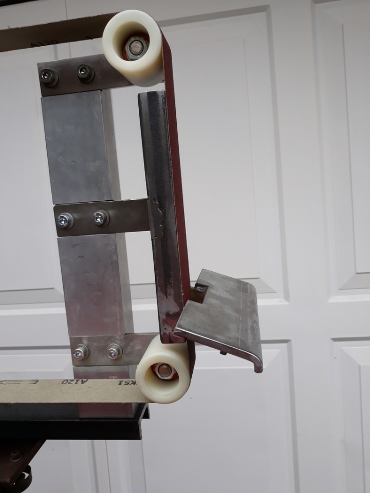

Although I'm not into knife making ( yet :wink: ) I always wanted to make a 72 inch belt grinder.
I could have copied thousands of cool designs on the web but that would mean buying lots of material. I wanted to use what I have if possible.
This is what I came up with.....I'm pretty pleased. I'll make a few other attachments but this should get me going. :biggrin:
Made of T6 aluminium and stainless steel and a bit of channel iron. :biggrin:
Just waiting for a new motor.......apparently lost in the post....:frown:

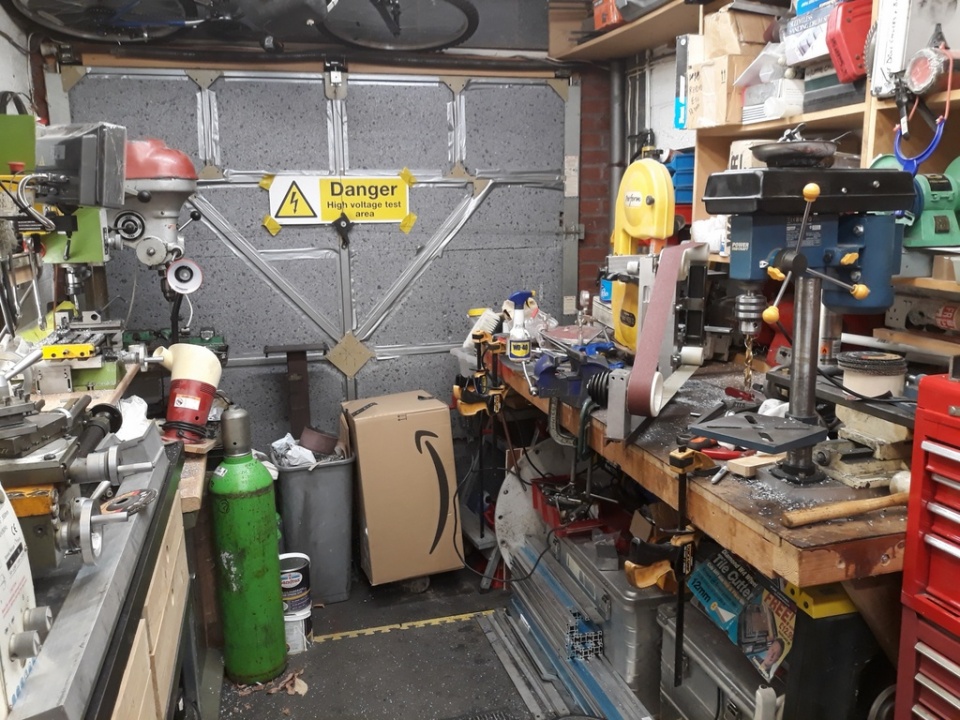

Nice, but the bedroom closet in the background? Wife not home?
LMAO....No Bruce...that is the outside of my Rat Cave ( garage :wink: )
I was going to take pics of it inside......but it's a bit like the 'Where's Wally?' images :biggrin: Can you spot it?:biggrin:
Sure, just right of the DANGER sign (Where's Will Robinson?)

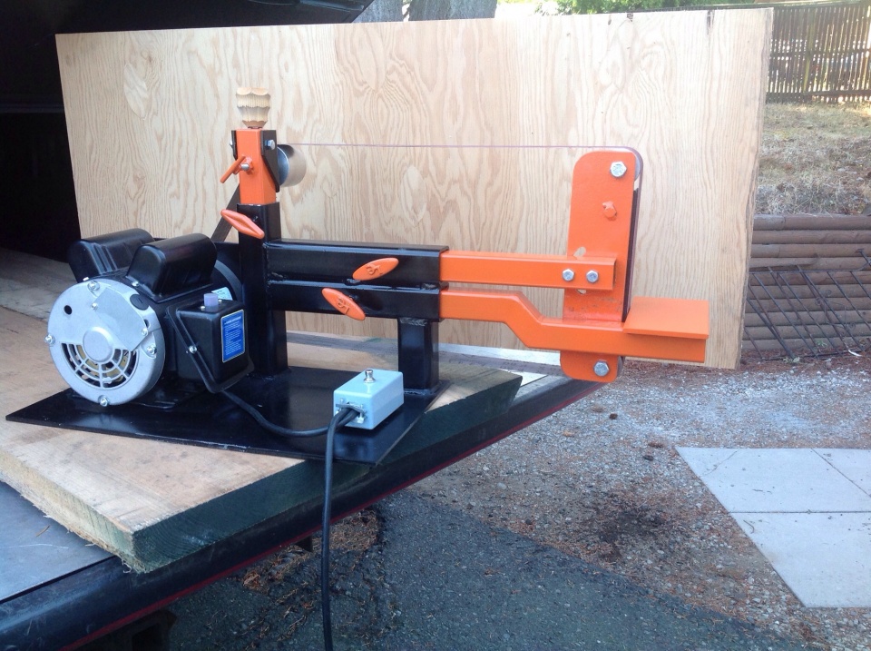

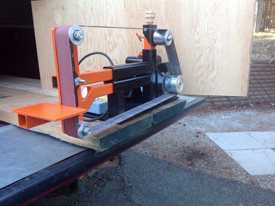

Here is the one I built. Hey I am steel fabricator.:biggrin::biggrin:
Lin

I built my own 2x72 grinder a couple years ago. Very satisfying experience. For your drive, are you going with variable speed. I used step pulleys like on a drill press. For your motor you will want TEFC. Totally Enclosed Fan Cooled. It is impossible to get dust or metal into the motor windings. I used a 110v single phase 1 1/2 HP TEFC motor. Let me know if you have any questions. You'll love the versatility of the grinder once it's up and running.

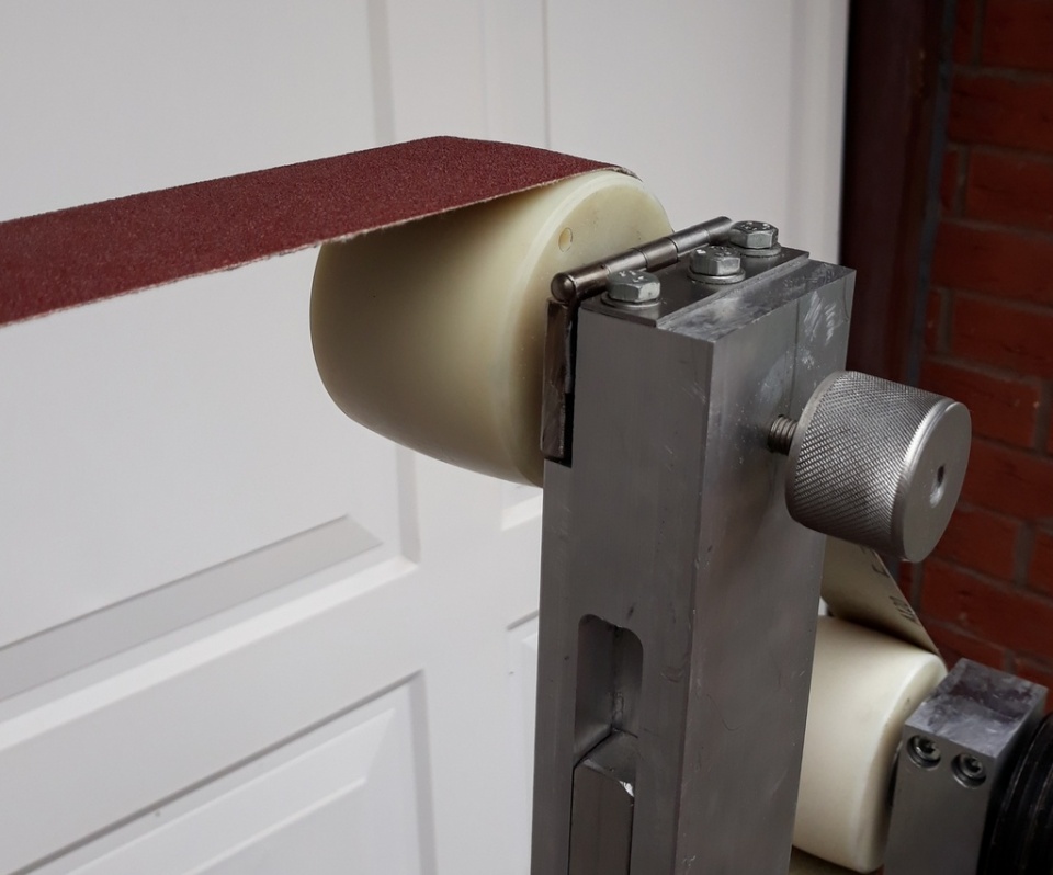

Super job on the sander Skip! I noticed it appears in the pic you are using domed wheels. These help with tracking in addition to your adjustment screw/ hinge.
I have an older(1980's) 1" X 42" Delta vertical belt sander. The original drive wheel was plastic and it fractured and broke some years ago....I had a fabrication shop turn a new wheel from aluminum/domed.....works great.
That plus the flat belt tends to want to track on the crown of the wheels .... very much in the same way that the blade on a band saw tracks on the crowns of the wheels.
Lin, that is a very smart looking grinder. I was going to follow a similar design.
Does it still look brand new..???:biggrin:
Danny, yes...the motor I have coming is sealed. But thanks for the head's up.:wink: also...got a 4 pole motor ( 1700rpm) and 5 step pulleys.
Pete, stock wheels off Amazon. I don't expect the grinder will get massive heavy use, so hopefully the wheels and bearings will last a bit. :wink:

Skip. Yes it still looks brand new. Lol. I have only used it once, I am in the process of building a 10" contact wheel for it. I have offered it to a knife maker I know and he laughs at me when I told him the price. $700 Ca. Have you seen the price of these things new.??:eek::eek:

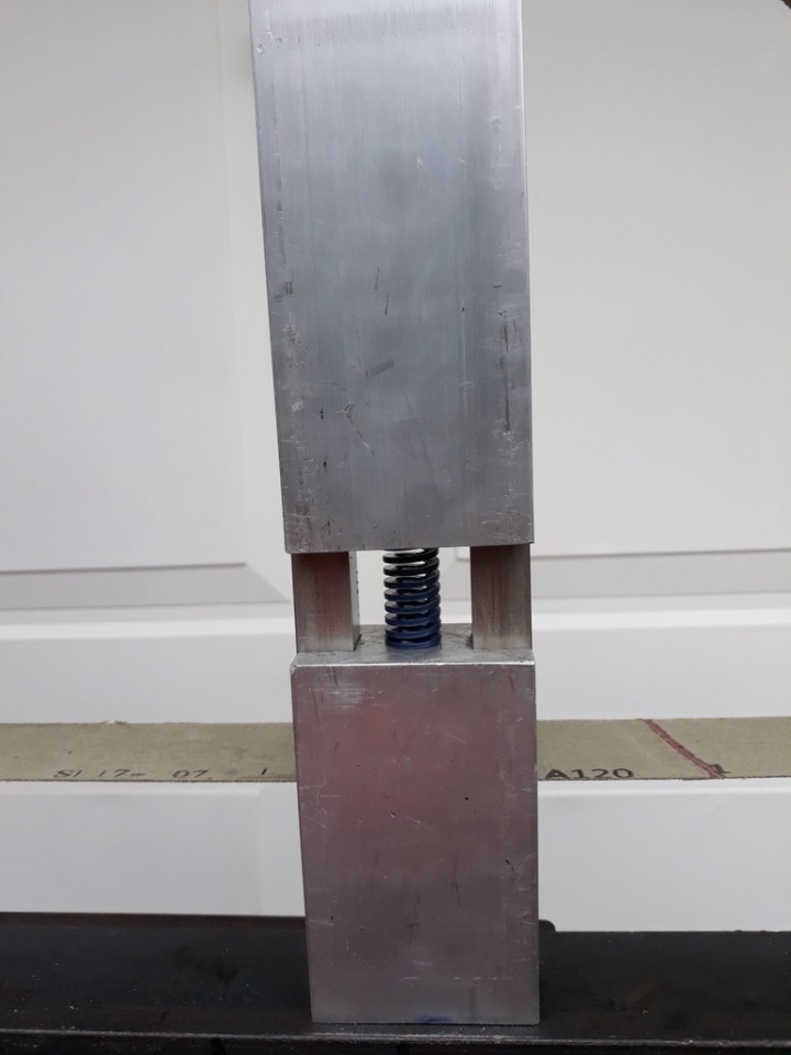

I don't see anything particularly wrong in your design at first glance. I see it's set up to easily change belts from the left side, but you have the tension and tracking at the same location. In most designs I've seen, the tension is in one position while the tracking is at another position, making them independent of each other, so that you can adjust them individually.
You may wish to put together a larger table (for the front face of the grinder) so that you can evenly and safely grind much larger pieces (long knives, short swords, long swords).
If you ever grind titanium ... be prepared for some extremely bright white sparks .... wear a face shield or some really dark shades.
