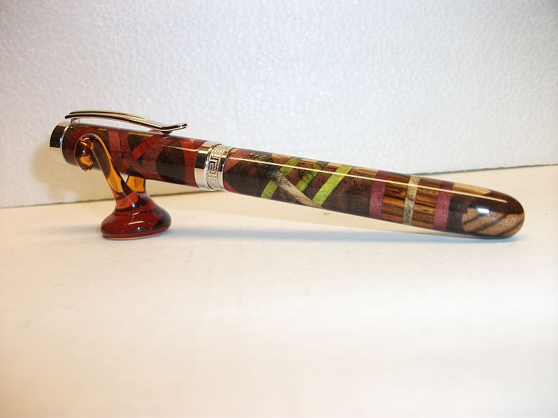

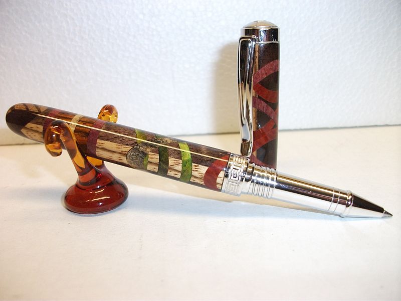

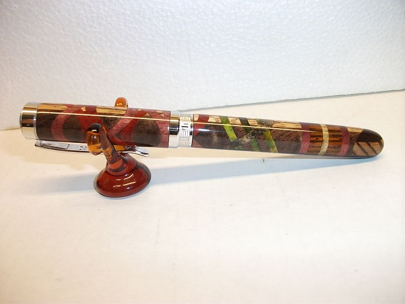

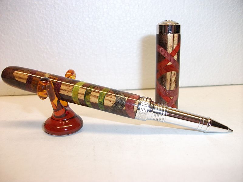

Here's my latest pen.It is a seven wood segmented closed end rollerball citizen.Can you guess all 7 woods?I made this one using my B&D comercial RAS with an 80 tooth Diablo hatb.Man does that blade cut clean,no sanding required.
C&C welcome.

Well all right if no ones gonna guess I'll fess up.The woods I used.I started with a walnut and zebrawood sandwich 8"long.I cut it to lenght and used the off cut for the 45 degree scallops.Next I cut the blankand put in a purple heart and cocobollo sandwich and glued it back together.Next came the 30 drgree triple slash done one at a time of course using green and yellow dyed box elder.The intersecting slash was at 60 degrees using buckeye burl off center by accident.After that I used red heart and purple heart starting on opposite sides switching back and forth.I spiraled 45 degree cuts for one revolution of the blank.Not satisfied with it yet,I thought the cocobolo was too thick and need to be divided.So I split the difference and put in another piece of buckeye burl.So there you have it,one pen seven woods and a worn out imagination.
