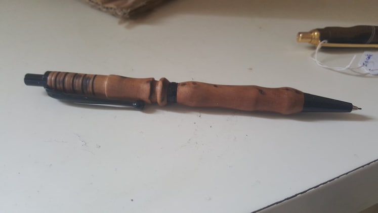

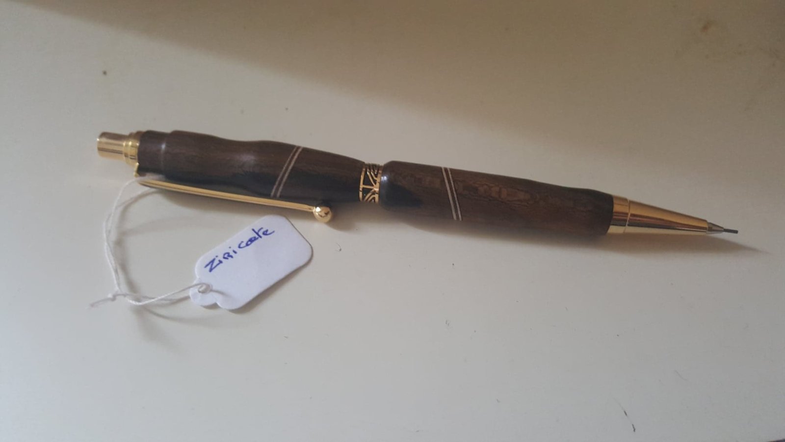

hi there, i like this mecanism its the same as the "criterium" (paper pen) that i've made many time, its really easy to turn and to assemble.
i advise you a dense wood to go very slim

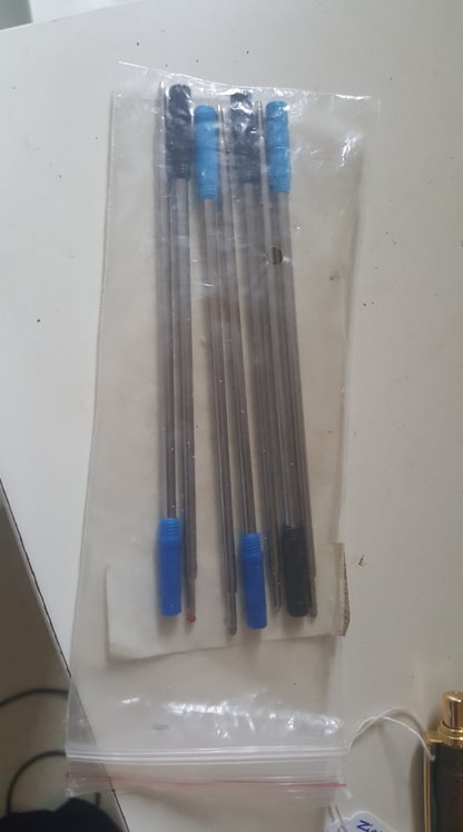

about the refill, i advise you to buy a separate bag of refill for the pen you usually make. because its never lost and you will sometime found some refill that doesnt work or as not good as they should. and i like to give a free refill to my closest clients, and refill are cheap
