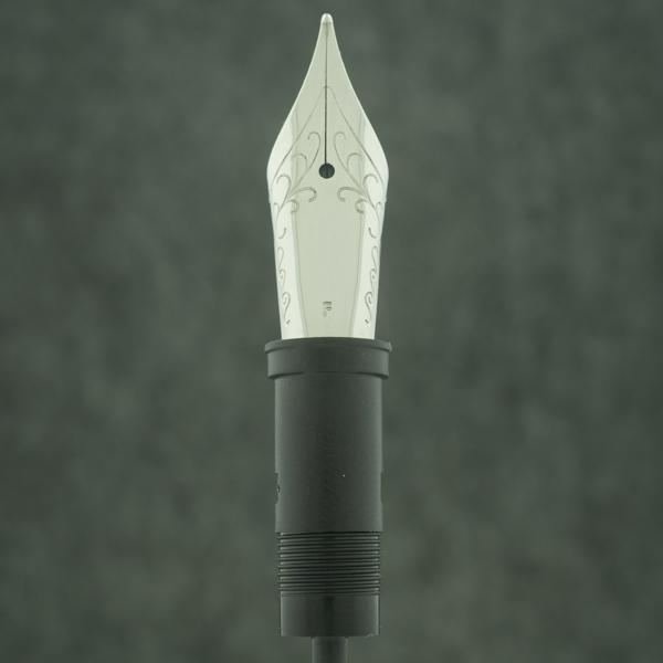

Hi Don
Didn’t mean to confuse. These are the nib sets I get from MeisterNib.
That’s a good price for the nibs. For myself, I don’t like the Dayacom imprint. I was curious if the ones I get are the same housing dimensions as the ones you get from Ed. I just made a section the other day and, for the life of me, can’t remember the length. I’ll check the length dimensions when I go out to the shop.
It’s becoming popular for end users to purchase separate nibs, from places like FPnib or Goulet Pens, and swap them out as desired. These nibs are available in 6 different sizes. They are also available in 18K gold as well. While the Jowo nibs are all interchangeable, not all the feed housings are.

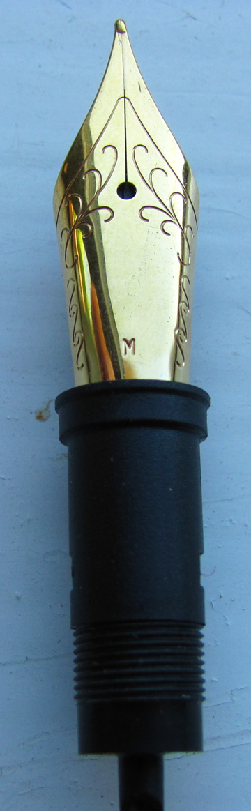

Hi Don
Hi Darrin,
This is the nib unit I get from either Exotic Blanks or Classic Nib. The threads are M7.4 x .5. It comes screwed into the housing as a complete section. It looks to be the same as the one in your post.
Don

Hi Darrin,
Don
It sure looks the same Don. And it doesn’t have a branding on it. That would make it a good deal.
With that knowledge, you could get the other Jowo triplets as an upgrade to different nib widths.
