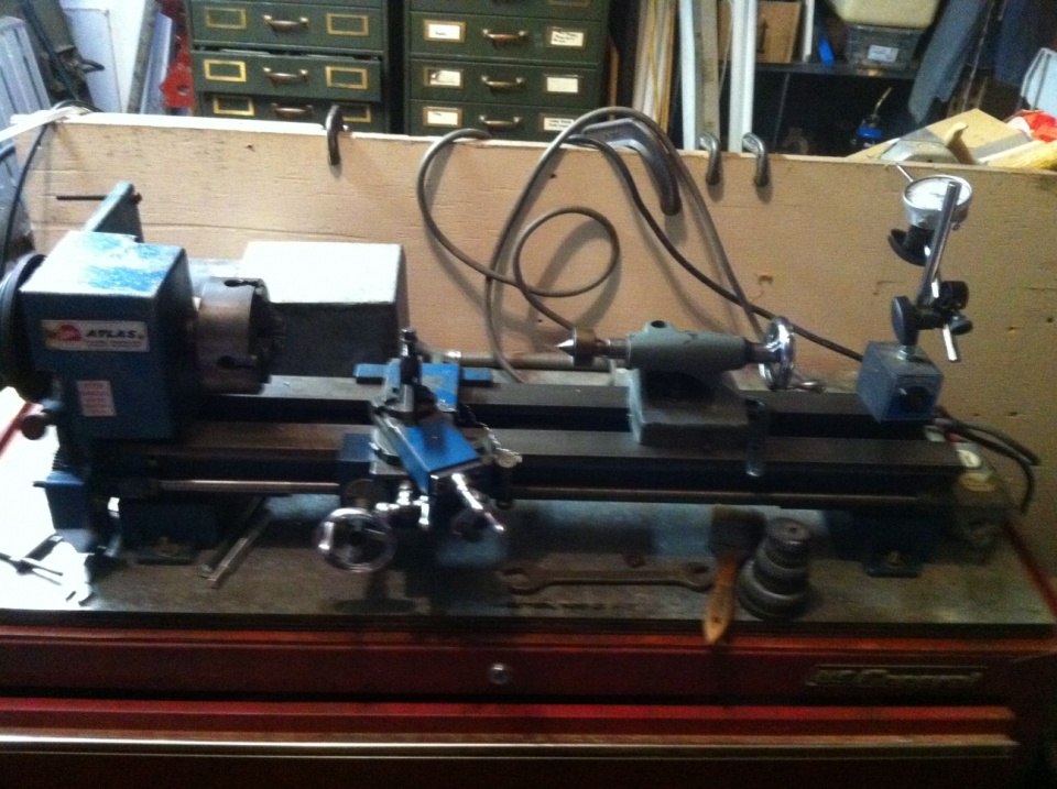

I don't think the guy had even got around the corner after buying the little lathe I had (7x12 Microlux) before I thought, "I should have thought about that a bit more". Oh well. This little jewel popped up on CL and the guy lives almost just around the corner. Got it for a bit of a trade and some cash. I turn and refurbish roller skate wheels for some folks, and this is already working well for that! Came with a 4 jaw (no 3 jaw) and the change gears plus live and dead centers.

Some guys get all the deals.:biggrin: Awesome. Is that your dial indicator? How does it read for run out? Thanks for showing it Paul.

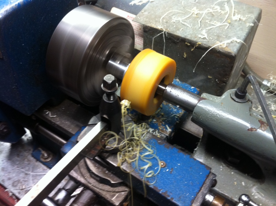

Wheel turning. Talk about a challenge, the urethane skate wheels varies in hardness. Takes a special grind on the tool.
And you have to get them all the same diameter? Close? Is that a special cutter/grinder? Sorry I have questions! But this is interesting.

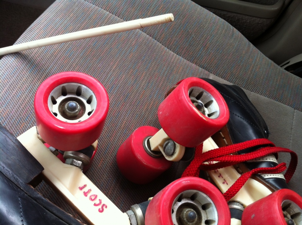

I shoot to get them within a couple of thousandths of each other, not much problem there. It is a special grind on the tool, a piece of HSS with a full radius on the end and quite a bit of positive rake. It also takes a good feed rate so the material doesn't melt back to itself or just tear. This guy gave me 96 wheels to do, this time. Did 40 a while back, and he says he has quite a few more to do later. He collects them, I guess :) I did mine a bit ago. Currently skate on some original fan jet wheels with Labeda 'tires'. Still go regularly. Actually found these skates at a thrift store. Bought them just for the wheels as the boots were small. Wheels are cool!
