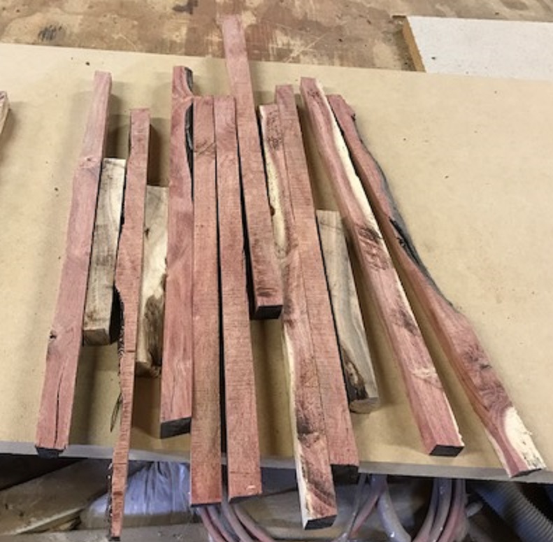

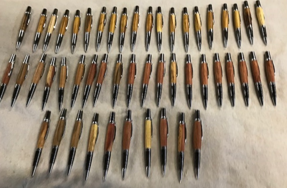

Had an order for 50 pens from the foundation of our local hospital. Then wanted to give them as gifts to donors who support the work the hospital does.

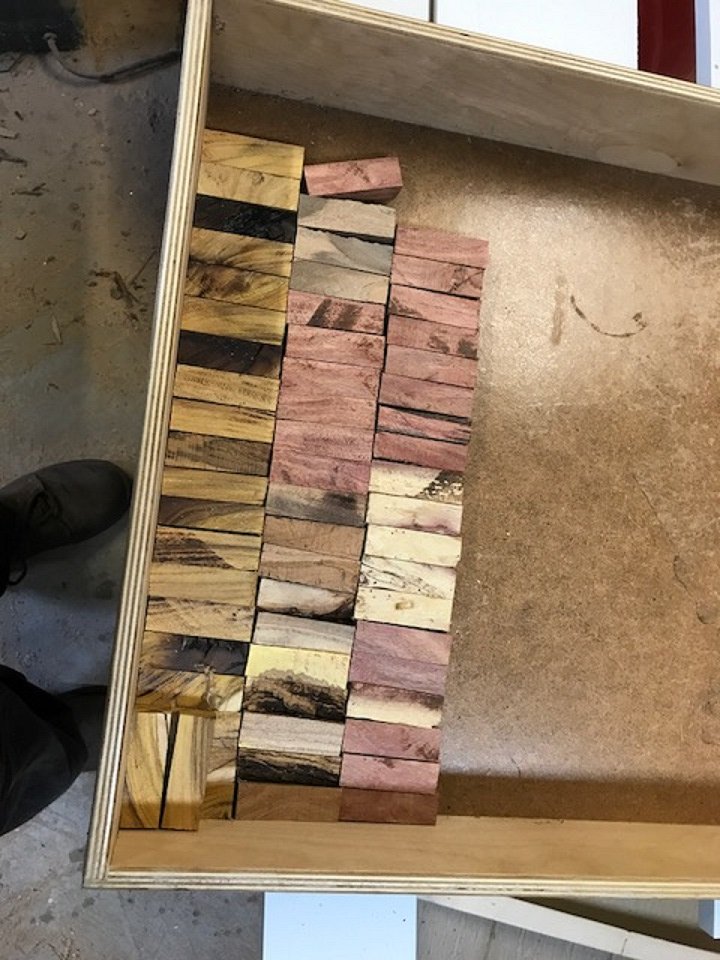

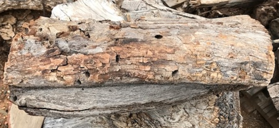

First is a dry and worm eaten mesquite log which I ripped into 3/4" sticks. The sticks were cut into blanks waiting to be drilled and tubes glued in the blanks are a mix of mesquite and mulberry all from this area. Lastly the pens awaiting their presentation boxes. The blanks were finished with an orange oil mix and CA.

I did stages I cut all the blanks (did extra). Drilled them all on the lathe then glued in the tubes (I ordered extra tubes in case I messed one up) using thick CA and let them cure over night. Started turning the next morning (I can turn two sierra blanks at a time) took about 6-7 hours to finish. Then my wife inspects them for anything I might have missed. Assembled and took photos.
