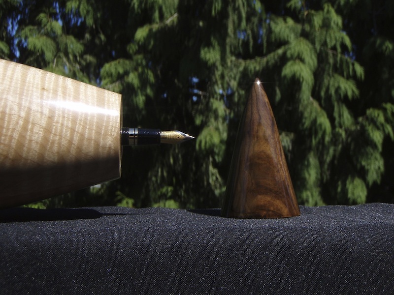

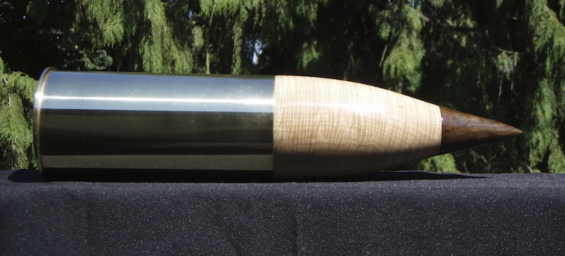

I made a "pen" using and El Toro fountain pen kit and a 105mm howitzer shell for a cartridge challenge here a few years ago. To do the same with a 50cal would be similar so I would use a Euro/American style kit like a Flat-Top from Lee Valley. It uses a letter V bit (.377) or a 3/8" for the tubes, which should leave lots of room to make an insert for the cartridge, as Mr. Brooks suggested, with a wood or camo blank for the projectile. The projectile might be a little longish but unless you do kitless work it would be a reasonable compromise.
