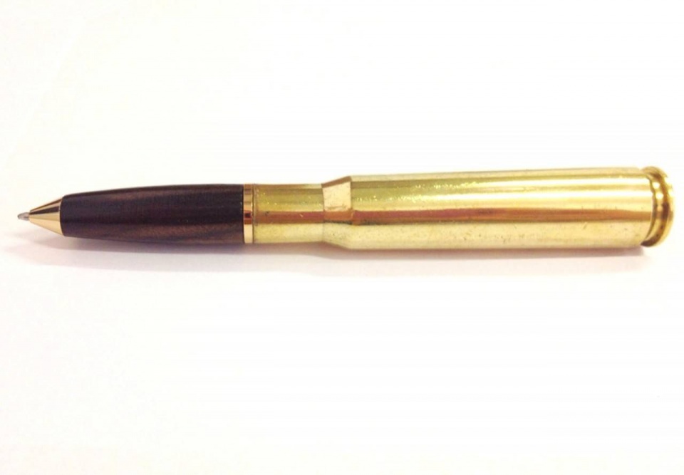

Here is what I will be doing with the spent cartridges.

I have been taking a Wall Street III gold kit and using the nib assembly and transmission for the pen. Take a 1/2" dowel cut to length for the "insert" in the .50 casing and drill it to work for the Wall Street transmission. 25/64" drilled 1" deep and a 5/16" (not sure, can't remember exactly) drilled the rest of the way. Glue the dowel in the casting and have a nice day. Your mileage may vary. My method is a slight deviation of the methods in the tutorials.
