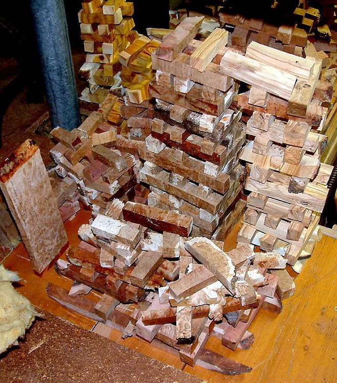

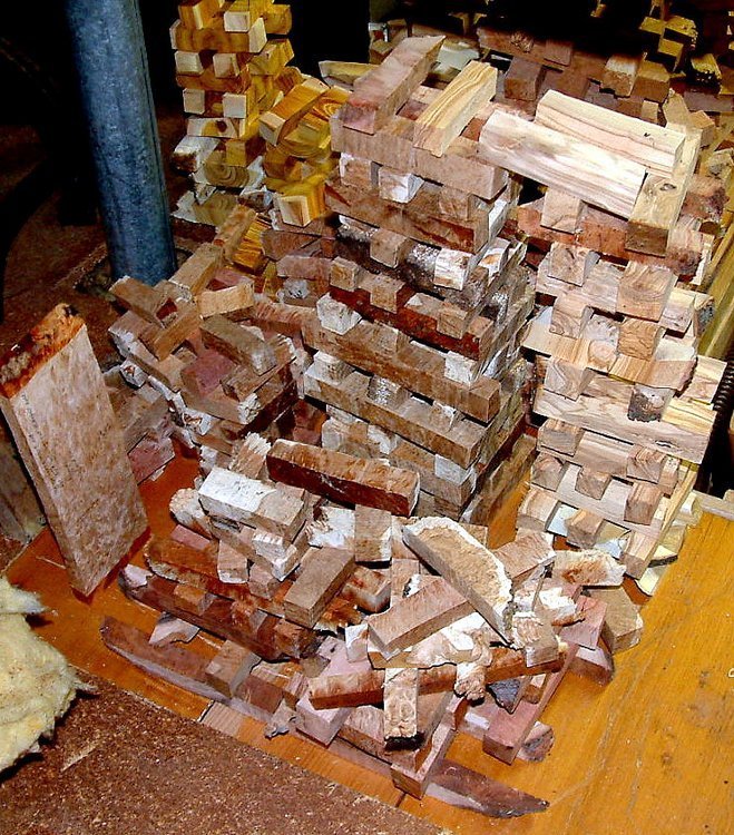

Waste of time using 5/8 blanks even though I can drill them there are heaps of blanks that can be improved by using another centre to gain the best grain etc.
False economy IMHO to use 5/8 blanks.
I have successfully drilled umpteen 1/2 inch Corian in my drill press, used to drill nonstop hundreds at a time. I do prefer timber.
Peter.
Pic shows some of thousands cut on the bandsaw and dried in my Roof Space.
