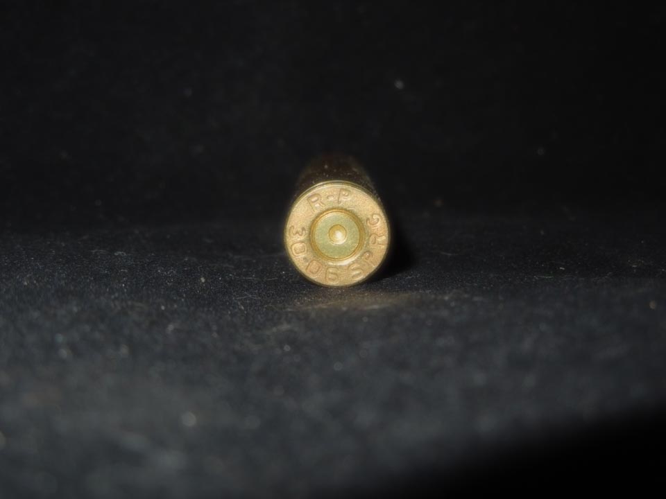

I got hold of a bag of 30-06 brass cartridges, so I thought I'd prep a bunch of casings for pens. Started out trying to drill a hole in the end. Turns out getting a smooth concentric hole was a lot harder than I thought it would be.
First try, I used my drill press (12" Delta with a pen blank drilling vice to hold the cartridge. Between the side play in my spindle (need new bearings maybe?) the fact that the dimples in the end were often off-center (see Pic 1), I couldn't get a smooth concentric hole to save my life.

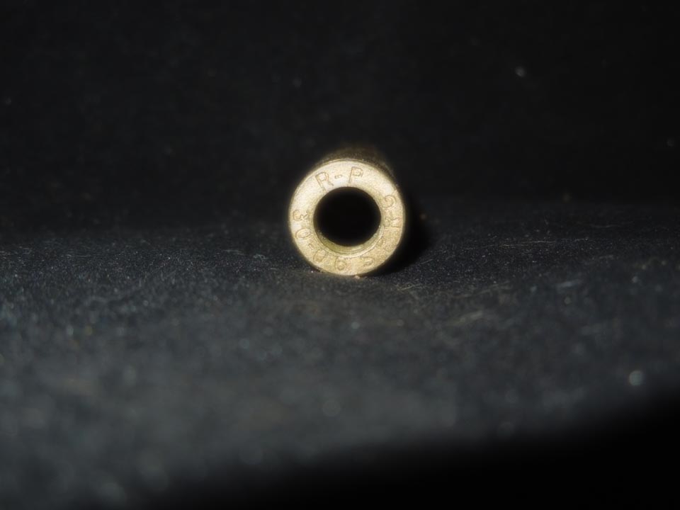

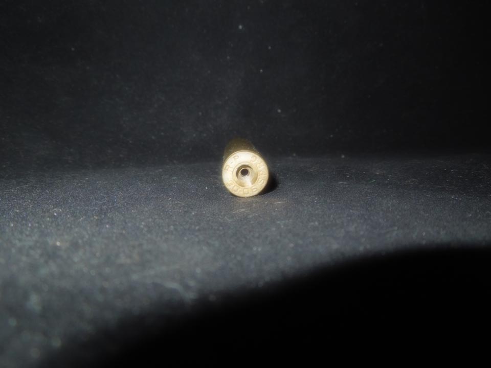

Was about to give up when I started rummaging through my tools and hit upon a 3-flute, 82 degree countersink. Chucked it in the drill press, brought the table up close, and bingo! I was able to get a nice, clean, concentric countersink in there (Pic 2) that cleaned up nicely with the drill bit (Pic 3.)

When I need to drill 30-06 casings, I drill a small hole in the fired primer and then remove it by prying it out using a small awl. then I can drill the casing with the proper bit for my kit. by doing it this way I get more consistant results. Keep turning!
First thing is to get the fired primer out of the way. I do that with one of those cheap precision screwdrivers from the inside(or I do it in the press in the house) then drill a 9/32" hole centered in the flash hole. Simple and works.
