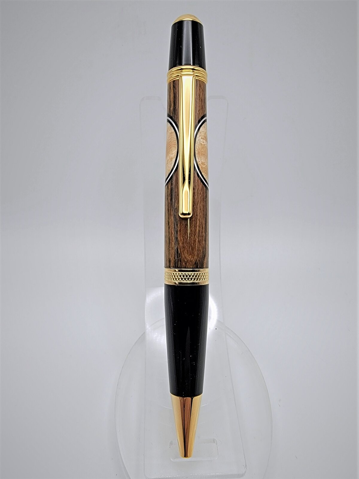

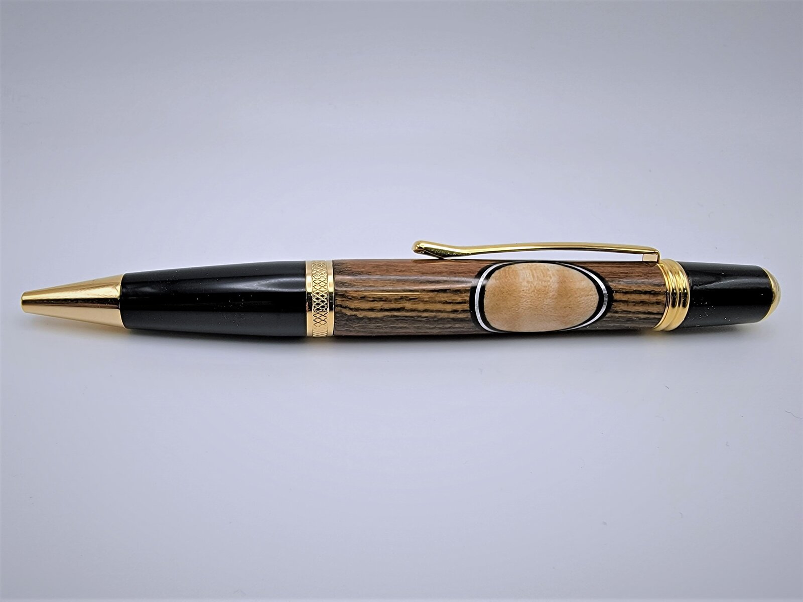

#41 - Tried new segmenting pattern. Bocote and Maple
See more from Painfullyslow
Painfullyslow
Mar 5, 2022
378
Connecticut
I am kind of surprised that I got this right on the first try which is why I didn't embellish this further. I would put something in the maple 'picture frames' the next time that I turn this pattern.
I slapped it on a wallstreet II/III hybrid which is why the segment is aluminum but the finish on the pen is gold.
Bocote, black abs/aluminum/black abs, and a pretty unremarkable piece of curly maple (I really wasn't expecting this to work out).
Finish is CA with Abranet, Zona down to 1 micron, then Novus 3,2,1

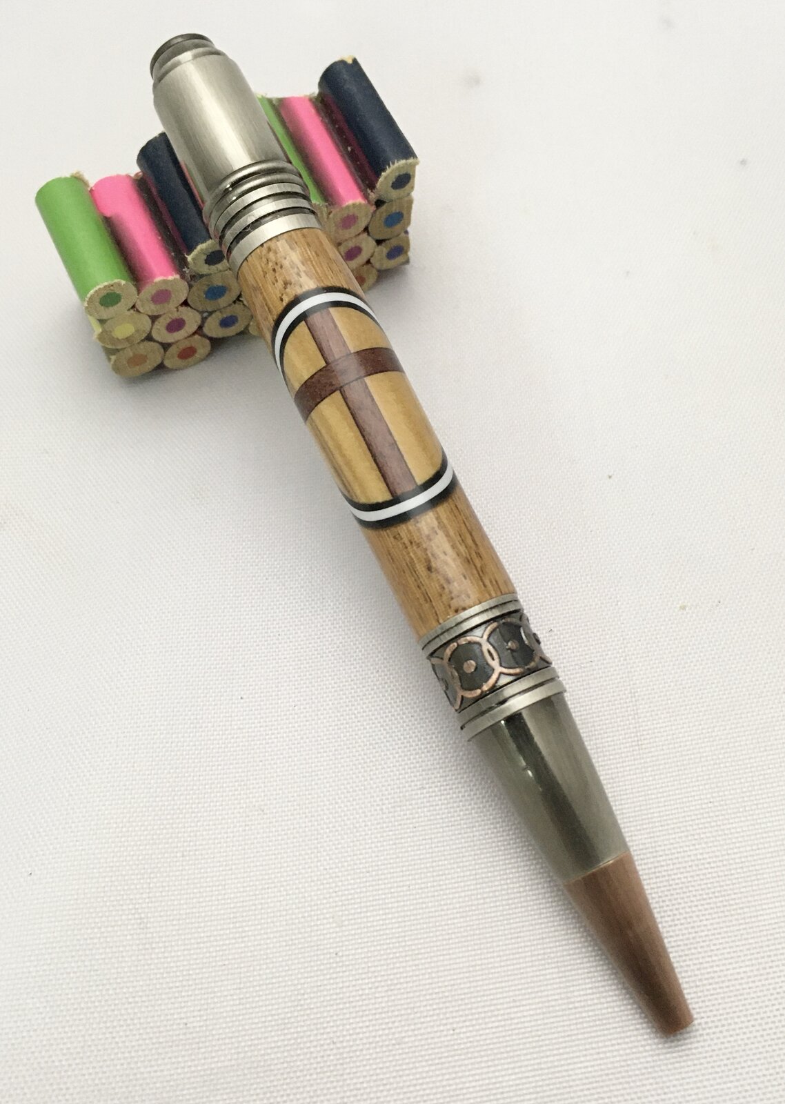

This is one I embellished. Fun project.
