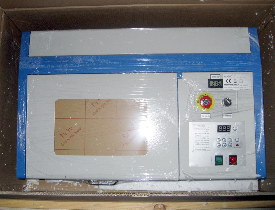

The machine he started out with is 40W USB DIY Laser ENGRAVER Cutter Engraving Cutting Machine Laser Printer CO2 | eBay
I had a blast a couple years ago when I got my K40. The old Moshi software was junk and the control board was horrible. The thing would routinely just take off cutting a line at a 45 degree angle, destroying any piece I had positioned in the bed.
The newer version has a redesigned control board, has solved most of the software issues he encountered. 40W USB DIY Laser ENGRAVER Cutter Engraving Cutting Machine Laser Printer CO2 | eBay , "It is the newest 2015+ version with the upgraded M2 control board and such. It uses CorelDraw and CorelLaser instead of the old moshidraw software. I actually find this setup quite easy to use but still plan to do a smoothieboard upgrade at some point to do true gcode and color coded operations such as PWM power modulation to the laser, etc..."

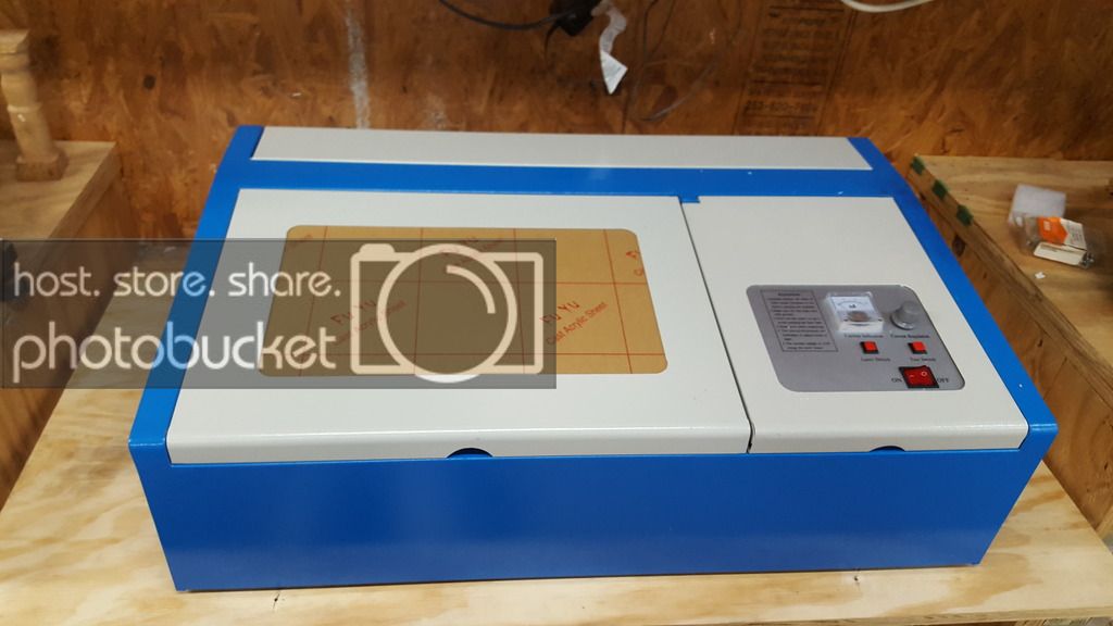

This guy was found on my porch. It wouldn't have been kind to just leave him there so the wife said we should give him a home. She's the best.
Hope to have him running early next week.
Nice! I sure would like one, but I know I'd quickly get the urge to do all the hot rod upgrades to it, along with the expense that requires. Right now I hope to get the little NEJE back into service after I burned it up.

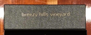

I bought one off ebay about a year ago. I haven't done any of the upgrades but manage to engrave pens and boxes as needed. I think it takes some time to figure out but works well once I had saved a few template. The bed that is in there doesn't really bother me as I use 1/4 inch wood to raise the surface or as a bed. I use Win 10 without issues.
Here is a box I make for cousins winery:
Really just takes a lot of trial and error.

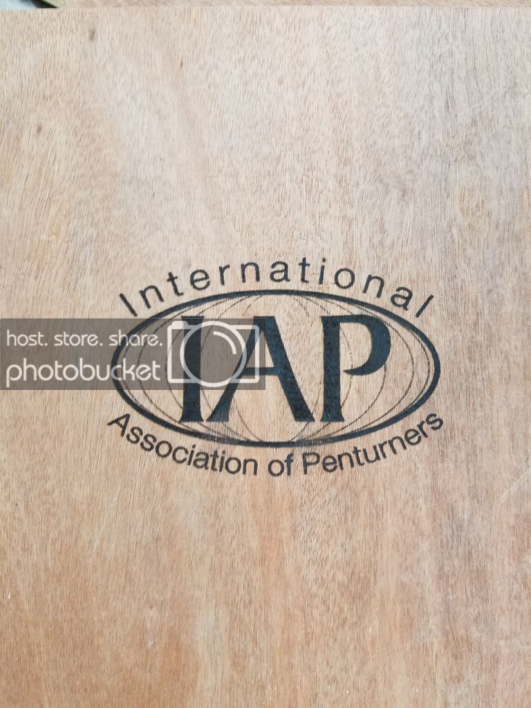

Well I have to say after about 5 minutes I was engraving my first piece of wood. I have done a lot on this thing so far and I love it. Simple to learn the basics. I am still playing around a bit before I start to really offer up my engraving services. I LOVE THIS MACHINE....I can only imagine what will happen when I do bust out and buy a quality machine after I learn this one.....I do have to thank everyone here for the input and assistance in gathering the information needed before I purchased this.

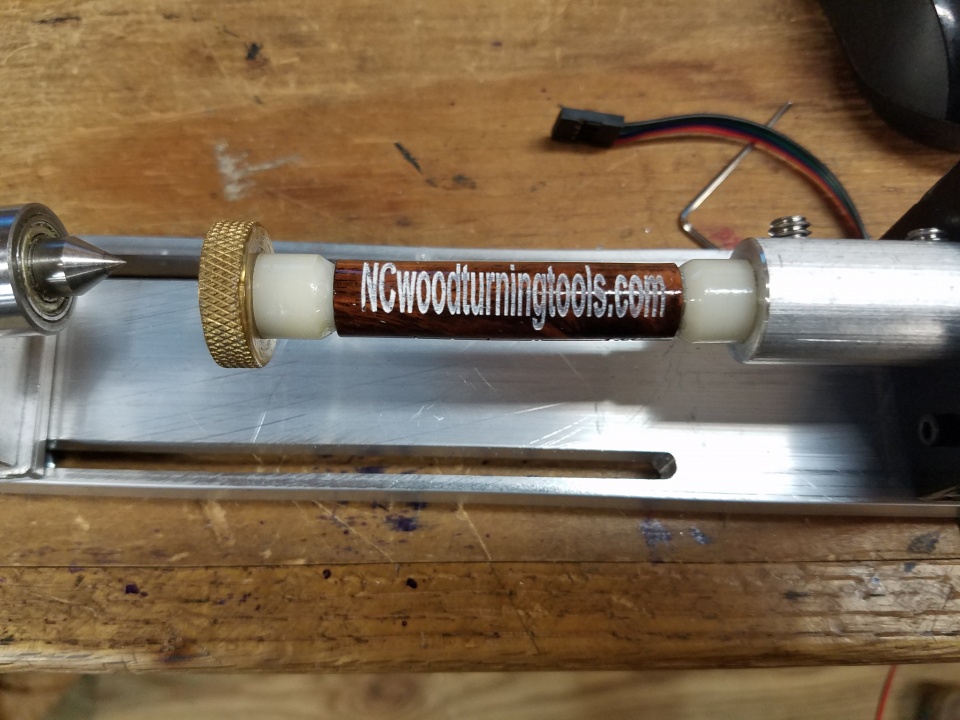

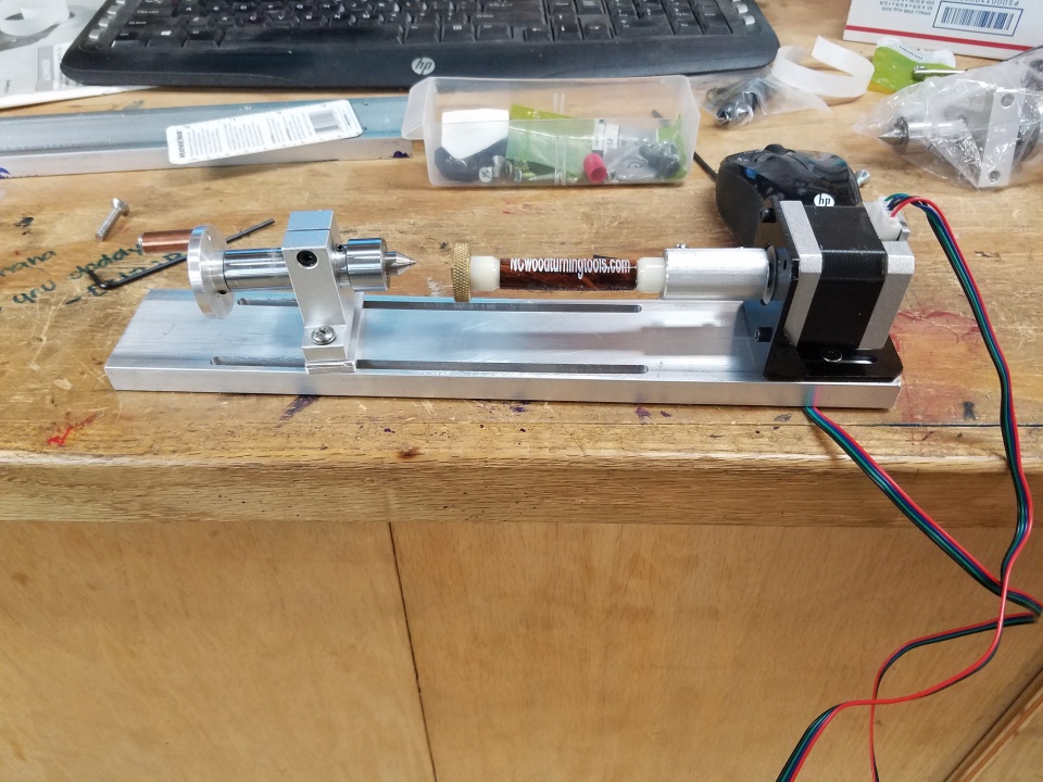

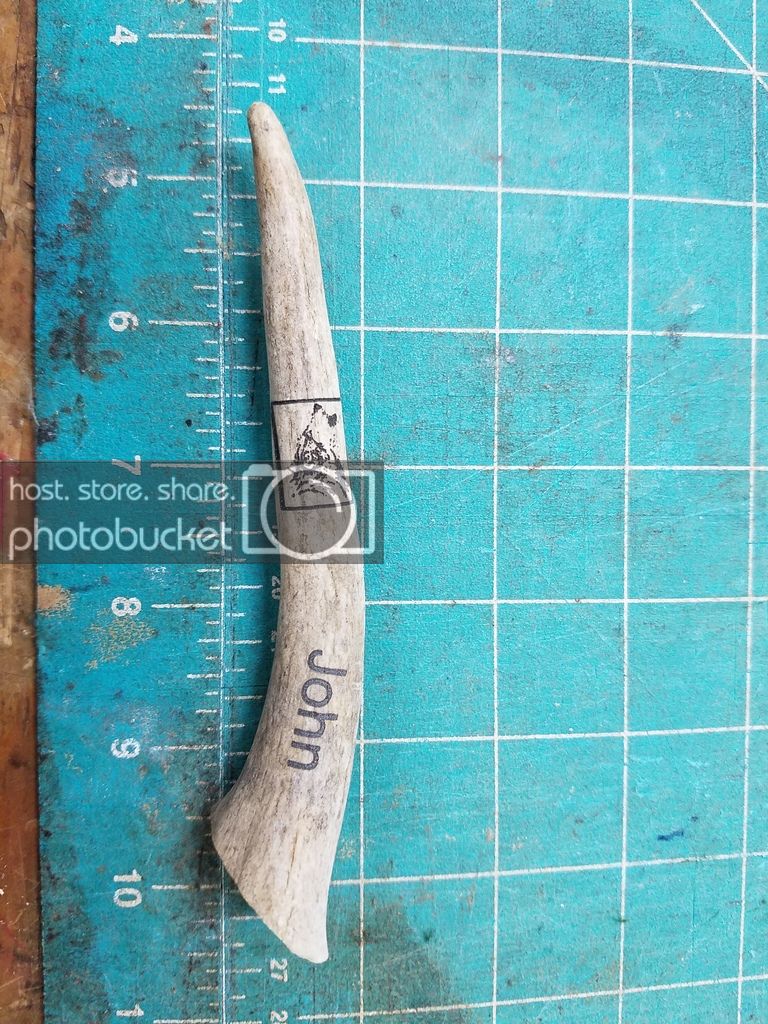

played around with making a rotary for the k40 laser.
short video and couple pictures.,
sorry for the side way view
https://youtu.be/uKqrHjh1lE8
Just filled it with white acrylic paint, was hard to see against the wood.
Nice! Did the motor just replace the y axis on your laser? Did you have any issues plugging it into your board on the laser? Did you have to use a special motor? I have seen some advertised but was unsure if the motor would be compatible with the board...
I used a nema 17 motors like the ones that are in the laser. I just unplugged the y axis and plug the rotary motor in. No issues
Now this is just a experiment, there is some issues which I didn't really think about, it was me just trying to see if it will work. If you look at the lettering it is elongated. I will try a few different things and see if this can be corrected.
