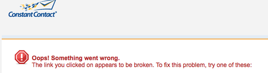

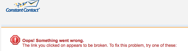

I clicked the logo in your signature line (here on IAP) expecting it to take me to your website (I hadn't read your line about it being the newsletter sign-up), instead it directed me to the ConstantContact visitor login. Once I got there, the sign-up process failed. Here's the screen I got:
