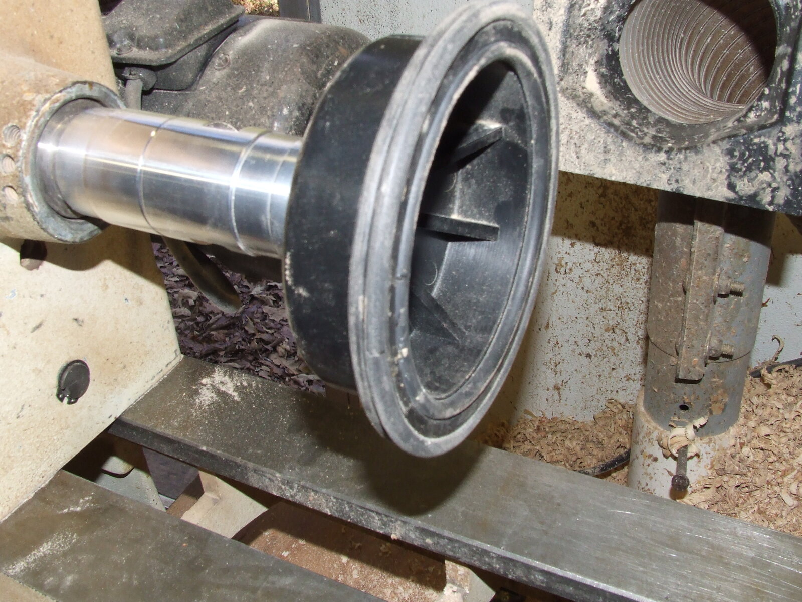

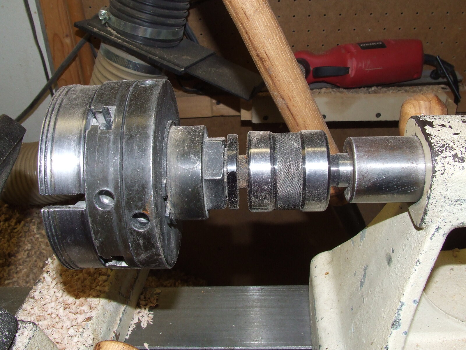

here are the pictures of my vacuum system...

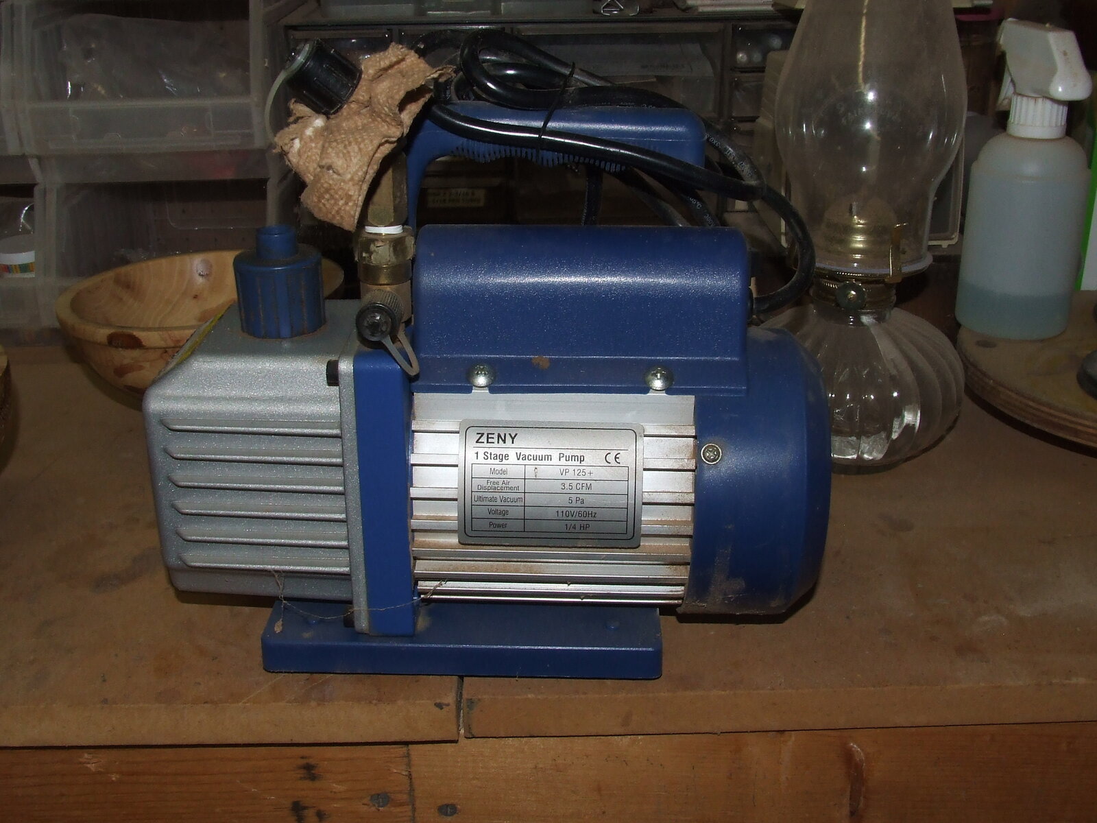

The pump is a Zeny 3 cfm that I bought from Amazon.... currently listed for $76.99

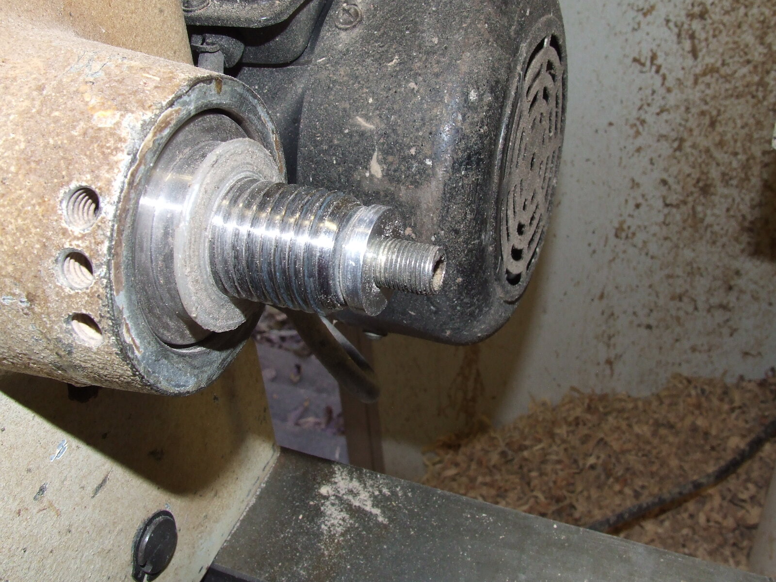

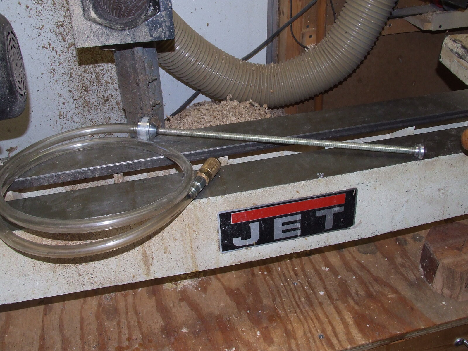

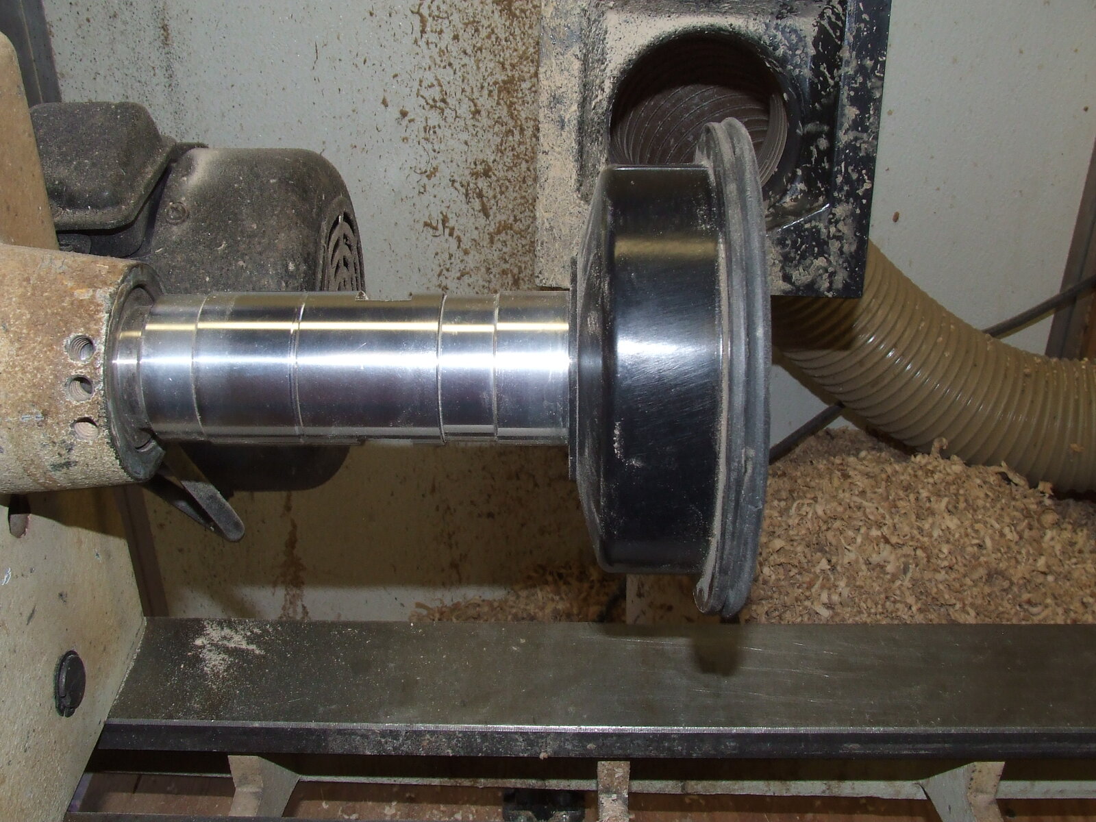

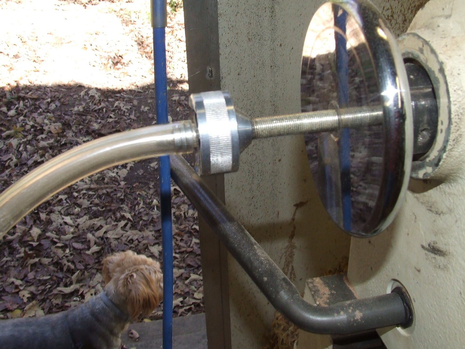

These show the rod through the spindle, primarily a lamp rod attached to a bearing at the handwheel, where the air hose will attach.
second picture is the bearing flush to the hand wheel, third is an overall picture with the hose attached.... I already had the hose from another project.. you'll need one with an I.D. that will fit snugly over the nipple on the bearing... my hose is a 5/8 O.D.... didn't take it loose to measure I.D..... last picture is the nut that fits over the end of the rod and secures it in the spindle... the nut has an o-ring on it to make a good seal.
This is called a vacuum adapter kit and is by Hold Fast.... Price I found was $63.95

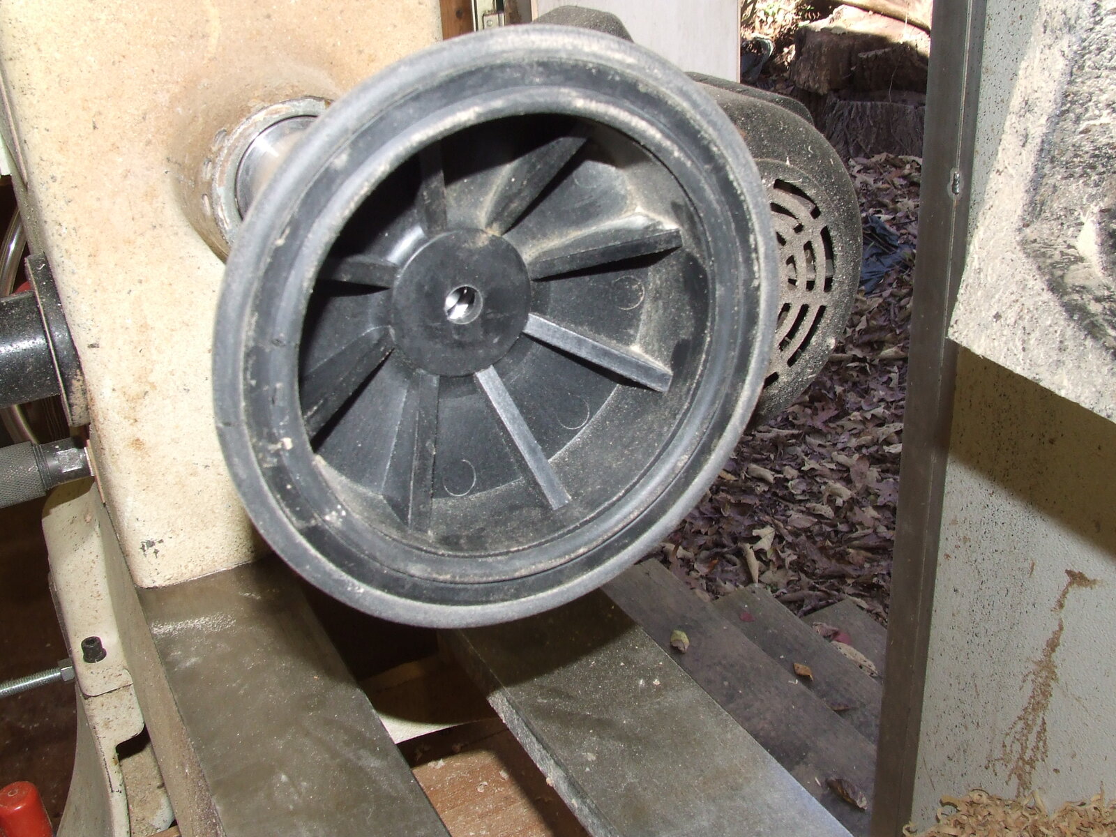

This is the chuck itself, a 6" HoldFast...I also have a 3 1/2 inch....Not sure where I bought them, but if you look up Hold Fast Vacuum chucks, I'm sure you'll find several listing on the net.... Prices I found were $71.95 for the 6" and $59.95 for the 3 1/2".. there is also a spindle extension behind/between the chuck on the spindle... you might need that to move the rim of your bowls away from the headstock or headstock motor... my motor is to the size of the headstock and protrudes to the right a couple of inches.

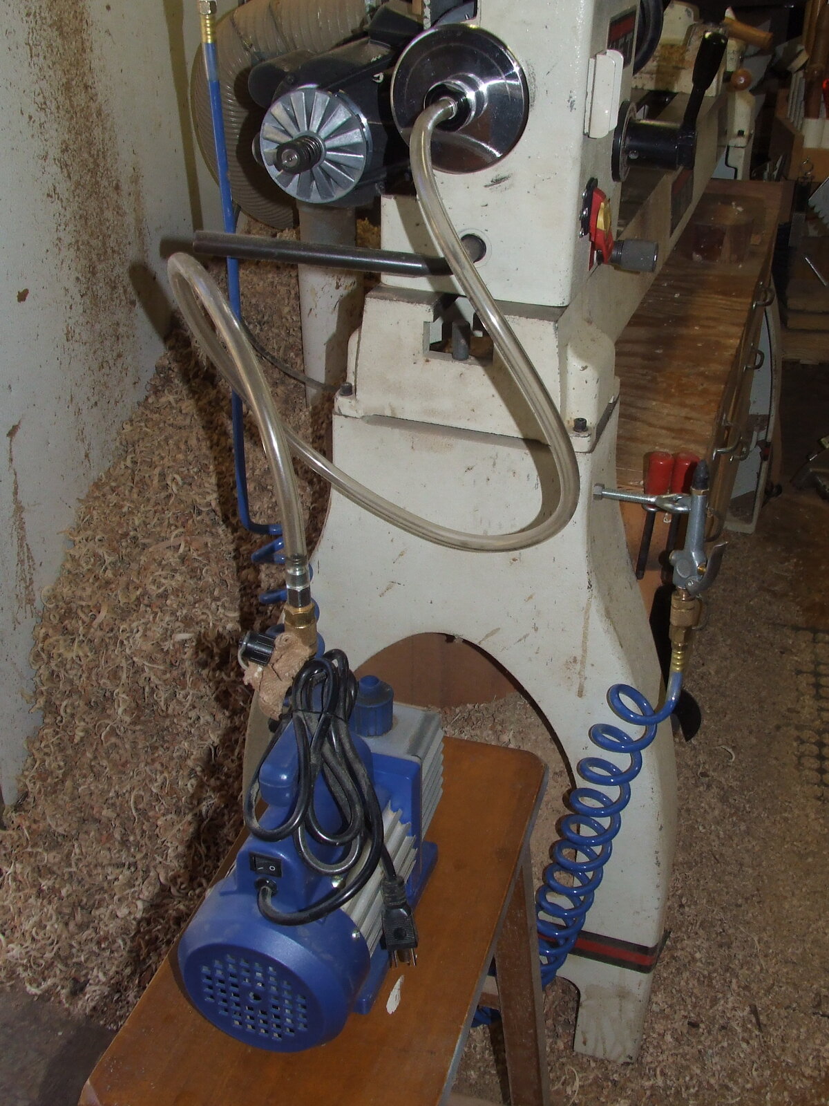

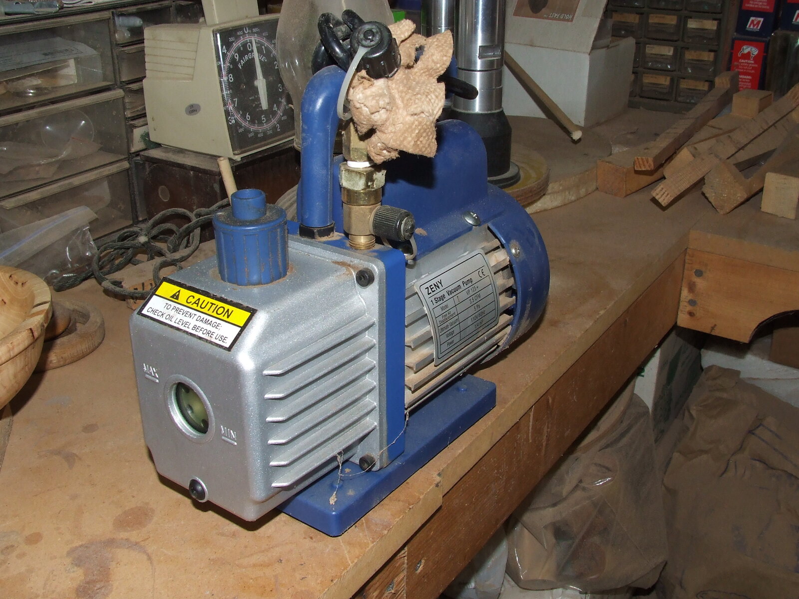

The pump and adapted hooked up.... I set the pump on the stool so I don't have to bend over to reach it on the floor (and not sure my hose will reach the floor.... you will need an air connection on one end of the hose to attach to the pump... also make sure you watch the oil level in the pump... there is a little window on the end towards the lathe that shows the oil level.
All told using current pricings, I think this system will run about $364.73 plus tax and shipping. Not sure if I paid these same prices, I've had most of this for over a year, maybe a couple of years.
