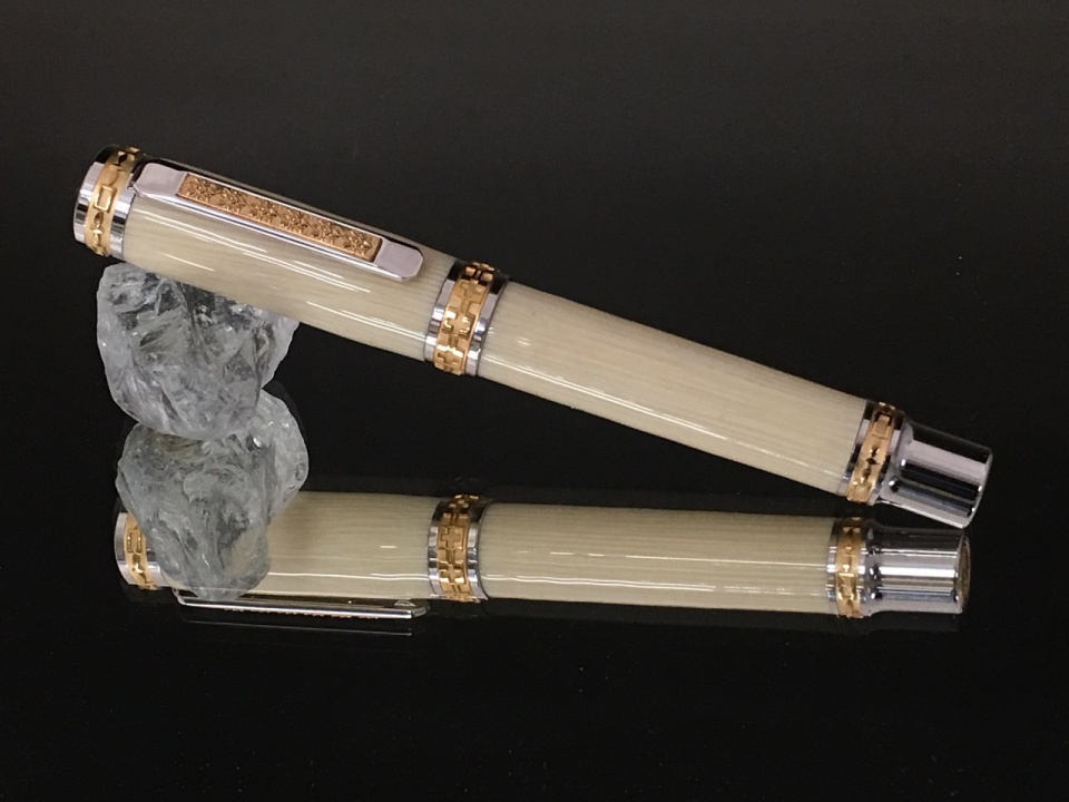

The first one is an ivory celluloid from American Art Plastics (identified courtesy of Bill (bmachin) and others when I asked for help (the blank shot fire when I sanded it). Turned with my special grind on a roughing gouge, MM 12,000, Scratch Free, Huts Plastic Polish, Ren Wax.

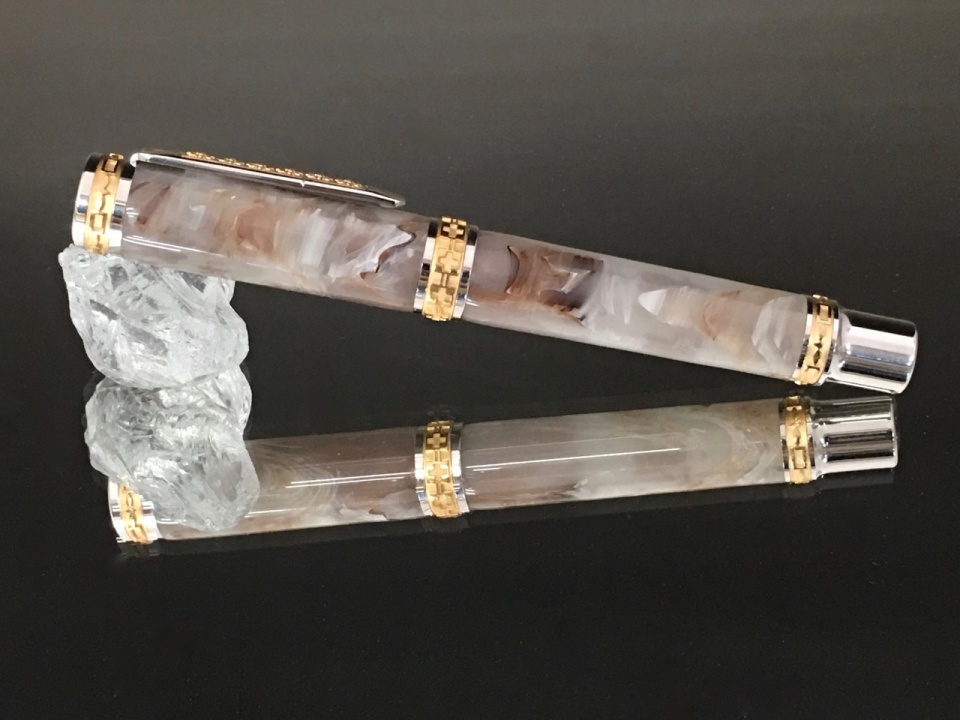

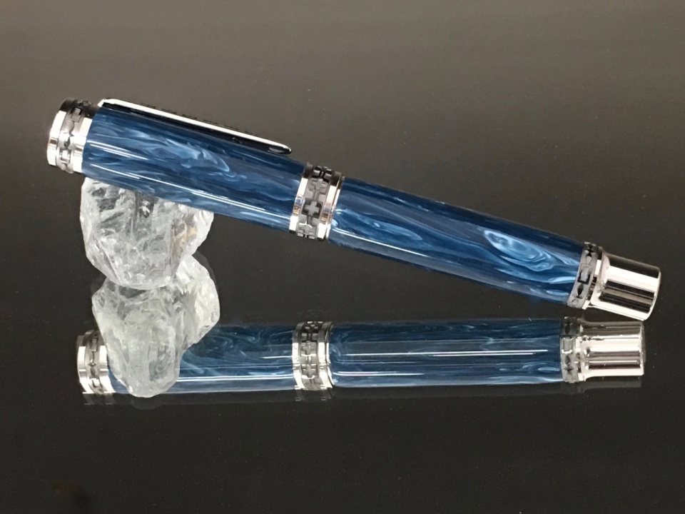

The second is from a piece of blue cebloplast that I had. Thanks to Ed4copies on how to drill a blank where the drill bit is almost as wide as the blank! Finished as above.

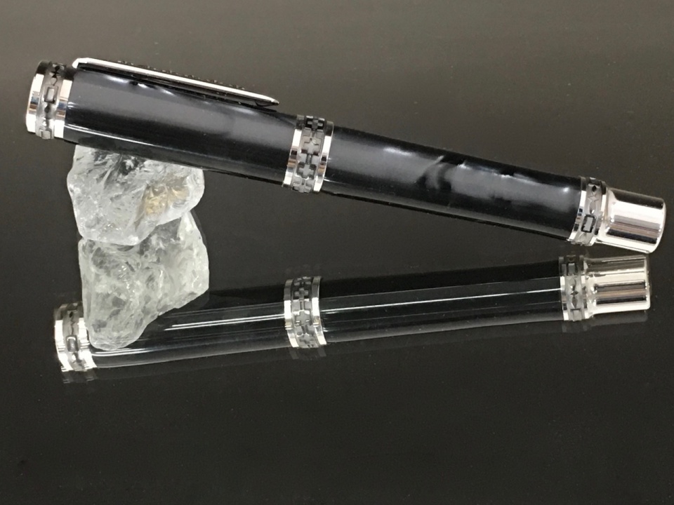

The third is from something labeled Rocky Mt. Marble. Some kind of acrylic. Finished as above.

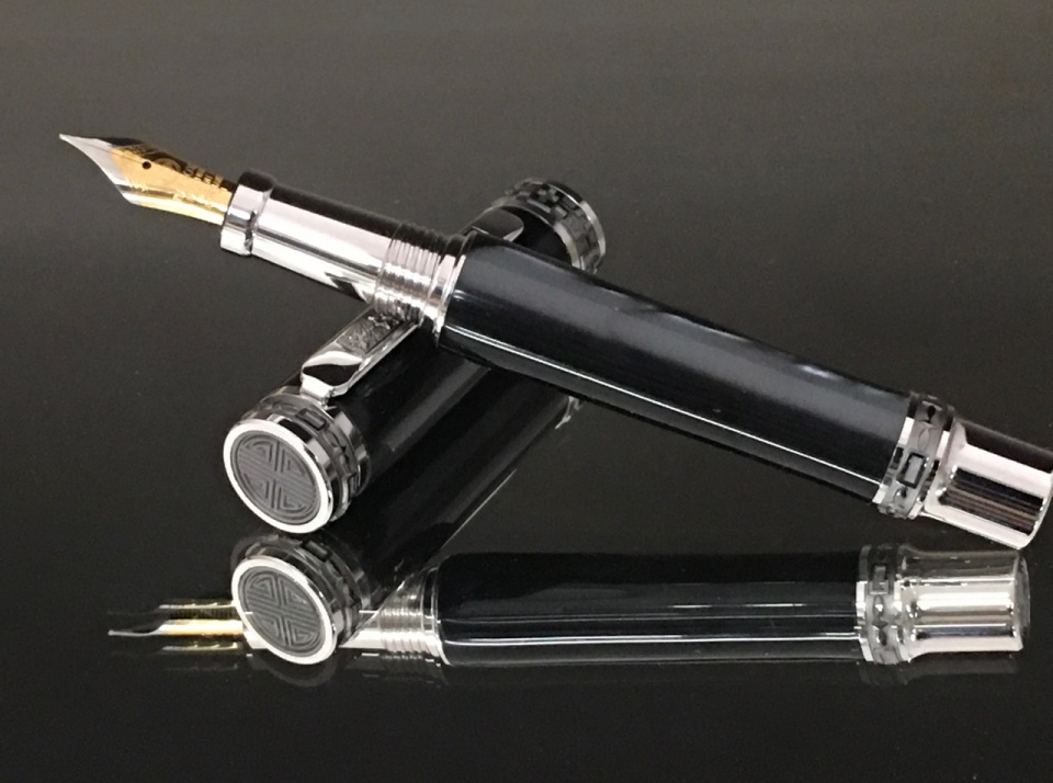

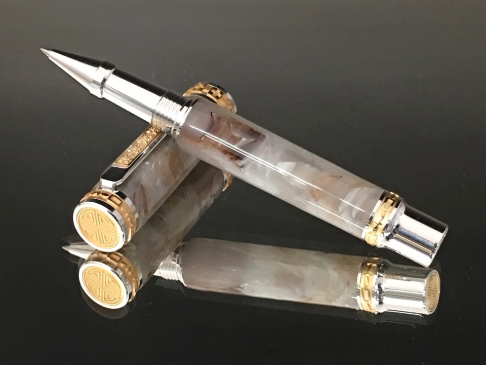

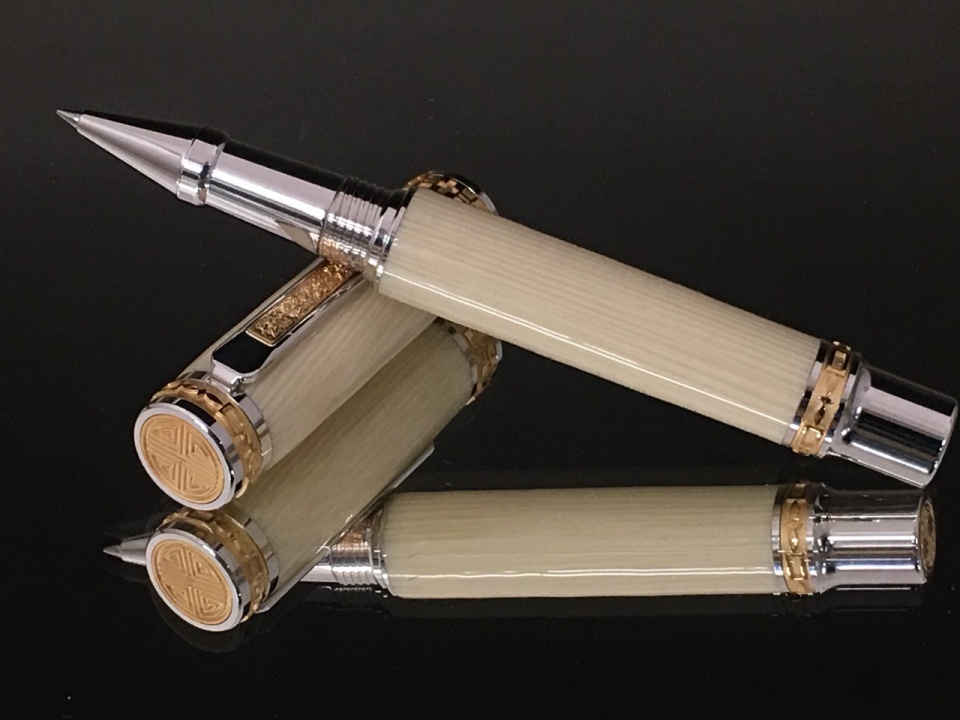

4 Kings Open

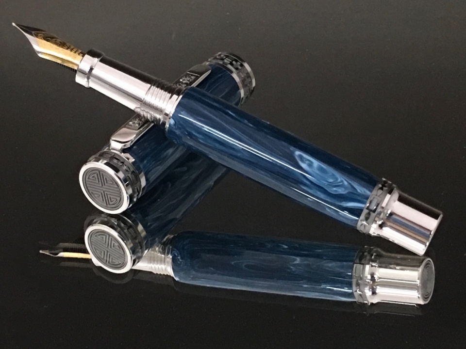

Here are the 4 emperors I just posted (closed position) in the open position. I didn't know how to post all of them at the same time, so I did it this way. I hope that's okay.

Tattooed, thank you. The blue one was the biggest challenge. The blank wasn't much larger than the drill bit. Then the tube got stuck 3/4 of the way in (even though I tried them first without glue), so I had to glue another tube from the other end. But it all worked out in the end.

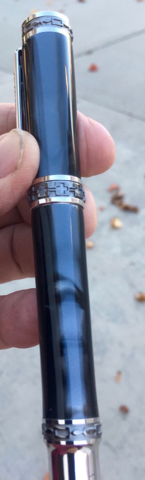

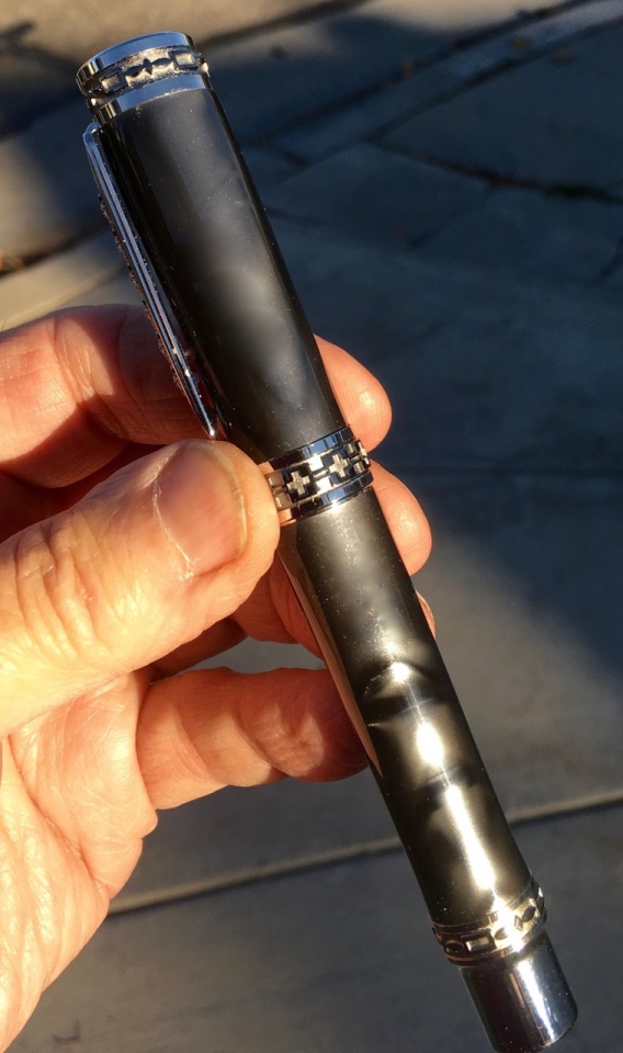

D.E., thank you! I wish I could get a better photo of the black one. There is a silver pearlescent strip on both sides that is just beautiful, but hard to photograph. I may try some other angles to see if I can get a better shot. Here's to you:coffee:
Here's a retake of the black marble ice pen, trying to show the pearlescent stripe.
I tried to take these in the sunlight, handheld, so I'm sorry for the quality of the photos.
