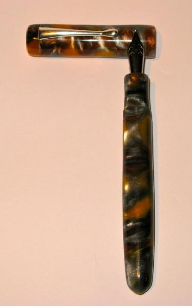

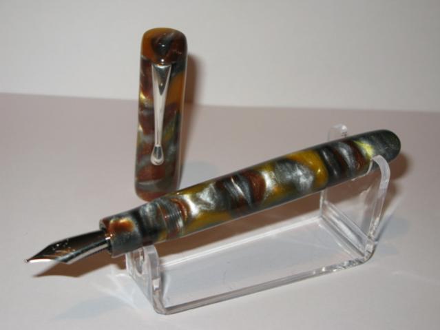

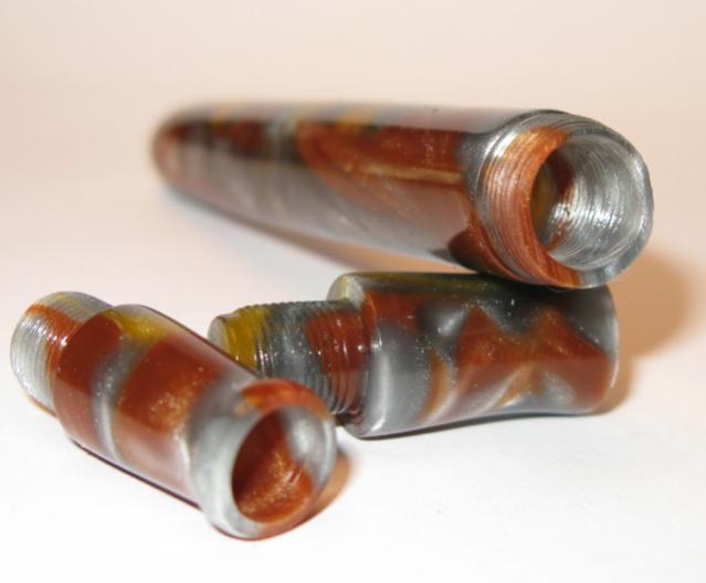

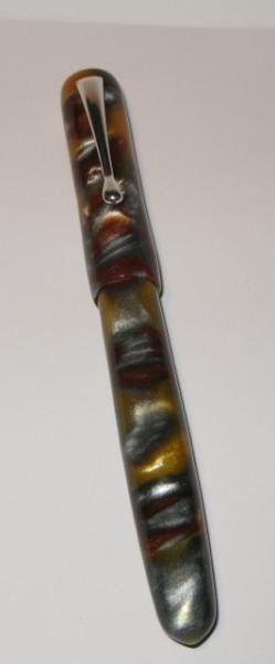

Lots of disasters between my last pen and this one, including one that I ran out of matching blanks for. This one took multiple tries to get it right. My main problem was keeping the workpiece true and centered. Turns out I was moving things around in the collet too much. Lesson learned! I've included a pic of the tragedies -- 2 section attempts, one barrel attempt, all off-center. Comments welcome, as always!
Material: Liquid Metal acrylic
Nib: Meisternib #6 Steel
Dimensions:
  • Capped: 147mm
  • Uncapped: 133mm (includes nib)
  • Cap diameter: 16.62mm
  • Barrel diameter: 13.7mm at section, 15.2mm at widest
  • Section diameter: 12.7mm

It turned out very nice in the end!
Yes, that's a lesson I think most of us probably learned (at least I did). Once you've got a piece in a chuck, don't remove it until you're finished with the piece. There is just no way to get things right after moving them.
Very well done! :highfive:
Excellent progress Renee. Your pen looks nice. Congratulations!

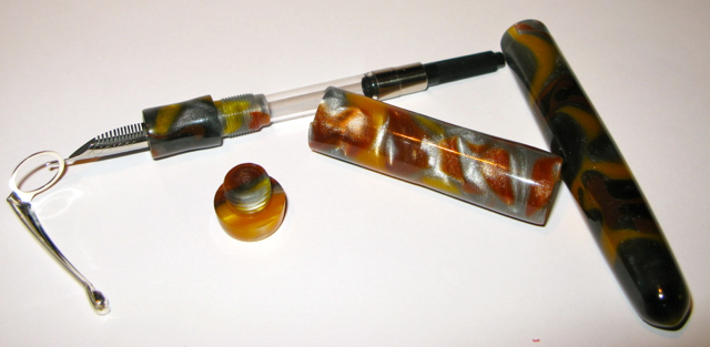

Beautiful Renee!!! Did you reverse paint stuff, paint tubes? You make it look so easy!!
Thank you!
Jim, no tubes or paint. This is totally kitless. I certainly wouldn't call it easy, but it's not that difficult. It does take a lot of elbow grease, patience, and persistence, especially when things don't go as planned.
