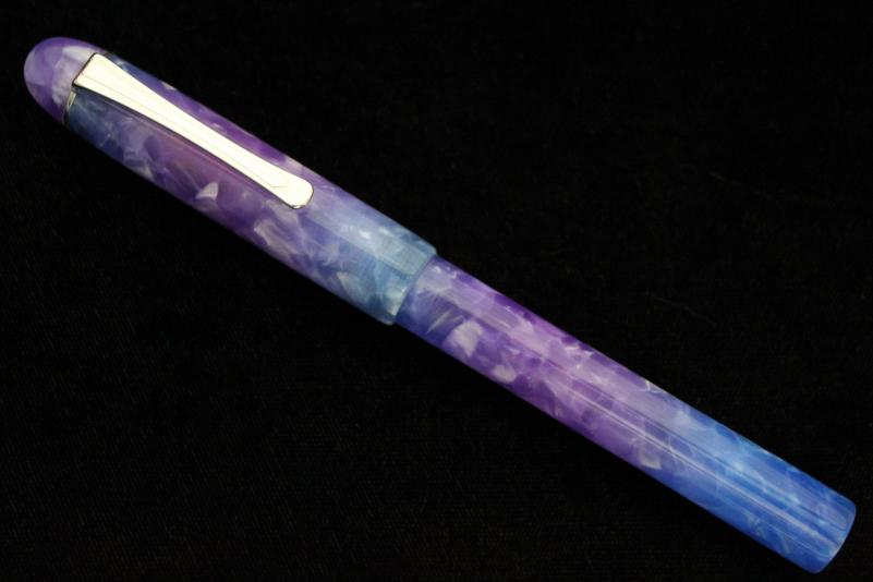

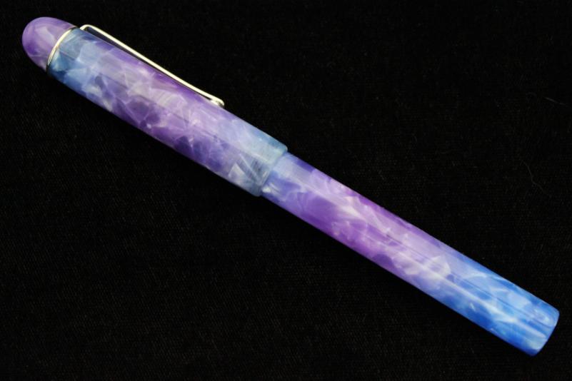

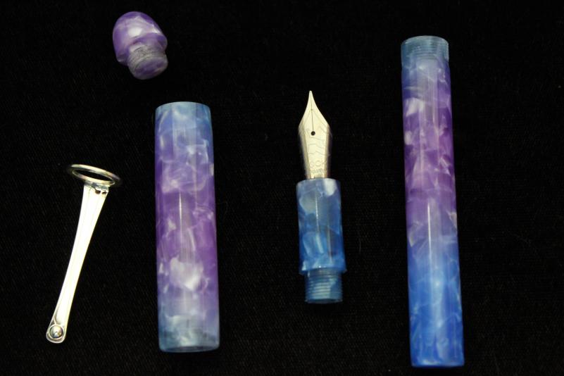

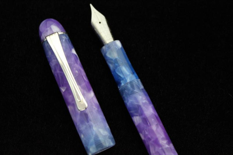

Here is my third kitless attempt. It is finally starting to get a little less frustrating. This one has a #6 bock nib M9 X .75 threads on section to body and M12 X .75 threads body to cap. The clip is held with a finial with M10 x 1.0 threads. Please give me any comments good or bad. I'm finding the design part and what looks aesthetically pleasing is really tricky. I could use some feedback. Also, does anyone have a suggestion for a kind of "standard" combination of threads for each individual part of the pen? Once you get a few taps and dies it gets hard to decide what to do. Last question is what does everyone suggest for number of body threads? My wife says my pens are too long winded... like me:laugh:

Design is the hardest part of it all. Personally, It looks like the cap is a little long. You might fatten it a little more and hide the clip ring by recessing it.
Good point. I wondered that the first time I screwed the cap on. It seems like my section ends up being long compared to other people's pens and I think that combined with too many threads makes the cap too long.

If you have to shorten your finial or drill it out after threading to allow the nib to fit up into it. I dont mind the long front section at all.

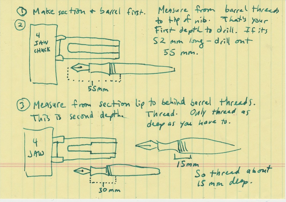

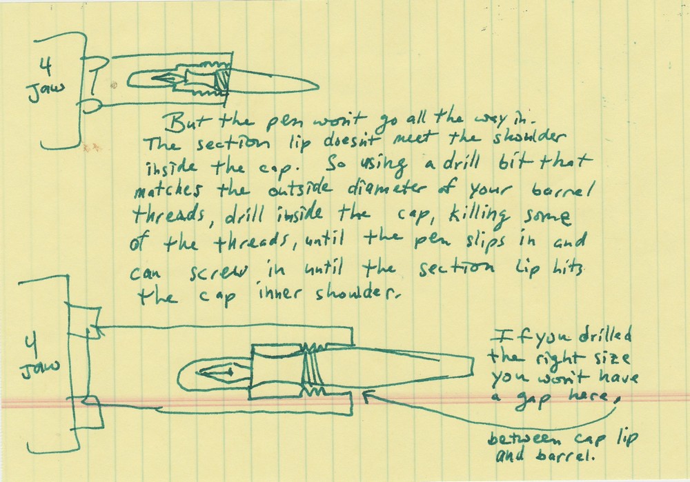

For the cap - I might put 10 or 12 threads in the cap...
hold on - I'll draw a picture.
