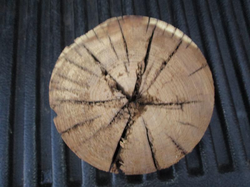

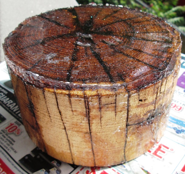

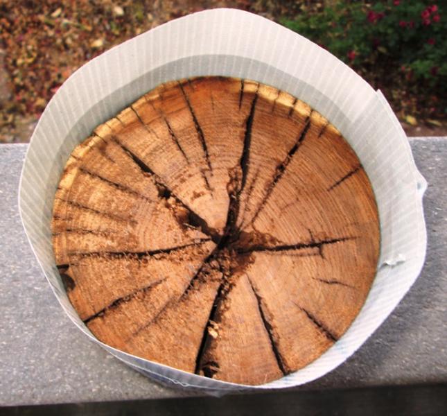

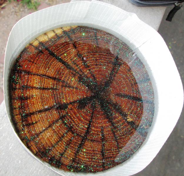

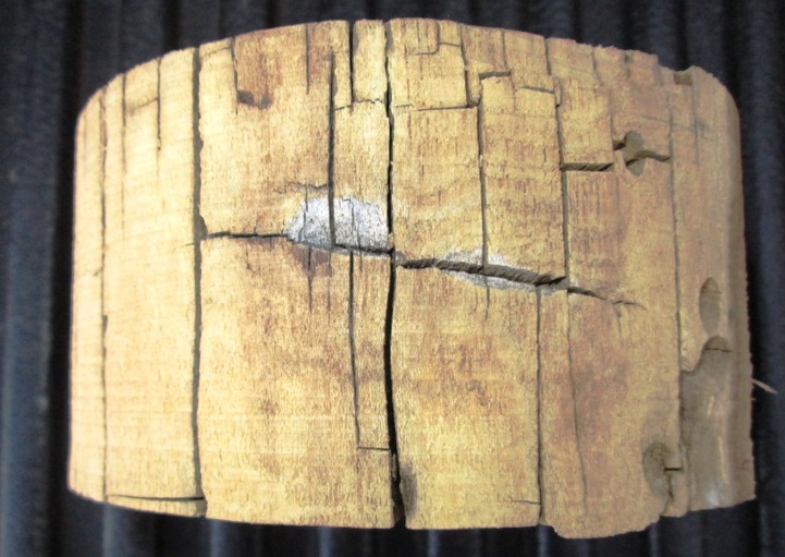

I made a bowl from a butt end of a mulberry limb that was old and full of cracks. I will show you steps I did. First I did a rough rounding, then wrapped it in duct tape with a collar on it. Then I mixed up a batch of similar 41 with some blue sparkles (for fun). I poured the resin over the wood letting it soak in. The next morning I removed the tape and have a nice bowl blank. Next off to the shop to do some turning.
