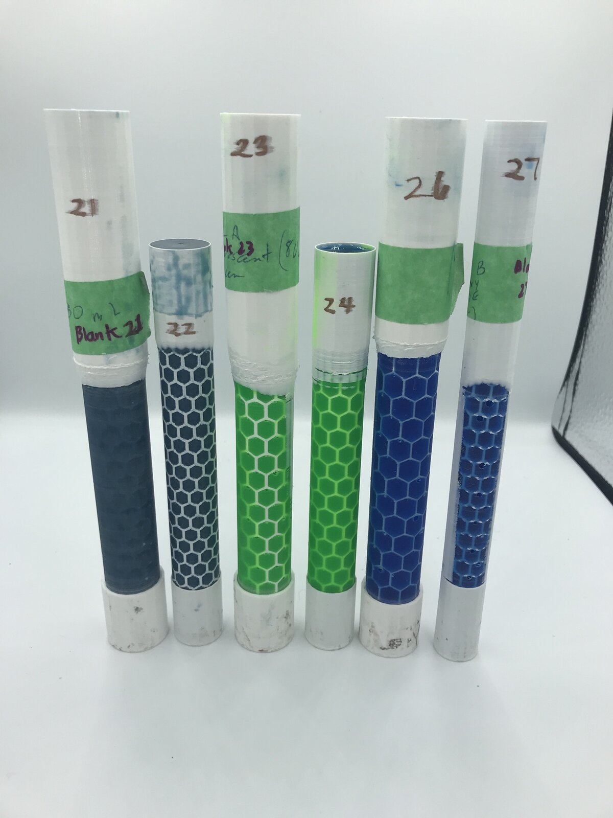

Hi Mike,
Here are some STL files for some round hex skeletons that you can cast. Print them in PET-G because it is more temperature resistant when machining. PLA will work but you have to be careful when drilling. You can modify these in Tinkercad. I printed my own outer molds as you can see in the attached photograph. Don't print the molds too tight or you will trap air bubbles on the outer surface. When vertical pouring make sure to fill the mold halfway and then rotate the skeleton as you push it down in the mold or you will trap air bubbles.
