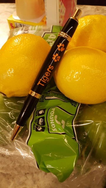

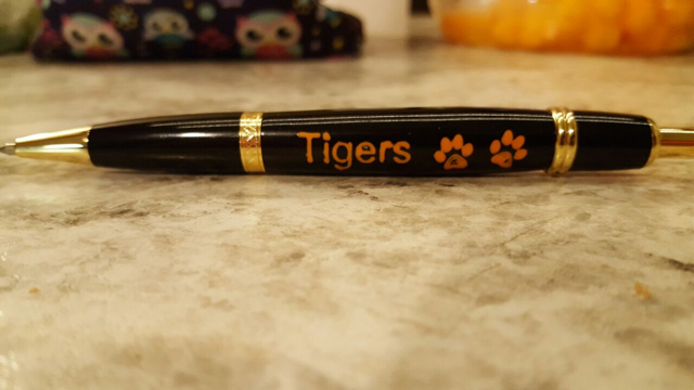

I have been playing around with 3D printing text and simple images. Made this one for my wife who teaches and their mascot is the tigers.
magpens
Feb 2, 2011
15,911
Canada
That's really cool !!
So did you 3D-print the whole barrel ? . And in its final shape and size ... or did you also have to turn it down to shape/size ?
ecrouse
Nov 8, 2012
84
Houston
That's actually pretty darn clever. You 3d printed your mold with built in embedments. Assuming print times are reasonably low and consuming the mold each time is cost sustainable, that is a really great idea.
