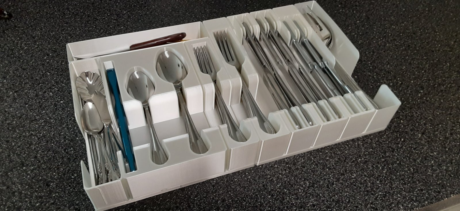

Yeah, I second the Gridfinity. I plan on getting my tools organized soon. I photo'd the silverware to make custom pockets for gridfinity silverware organizer. It was a full week of printing.

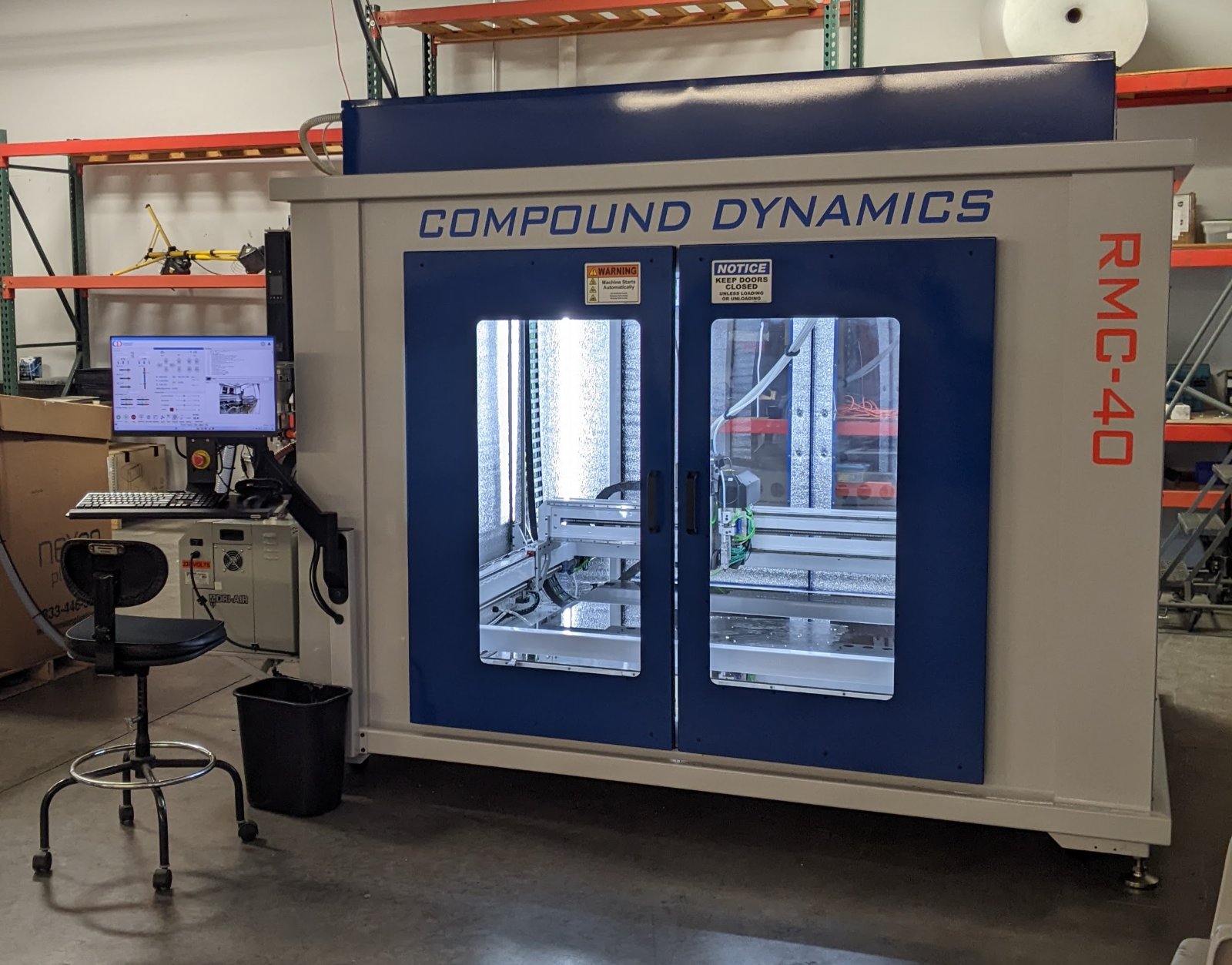

This is the one I run at work. It might be a little overkill for what you need lol. It has a 60"x60"x40" build capacity. We print full scale thermoforming patterns and prototypes with it. I run a lot of pelletized carbon fiber ABS through it but can run filament through it as well.
We also have several desk top units as well but I am currently looking at buying a Bamboo X1C with the AMS so I can run high temp material like PA6 with 25% glass fill as well as run trickier prints with dissolving supports. The two that we have that get used the most are an Ender 3 Max Neo and an Anycubic Kobra Max. The Kobra Max is a work horse but Anycubic customer service is painful so I would not recommend their machines for someone just getting started.
