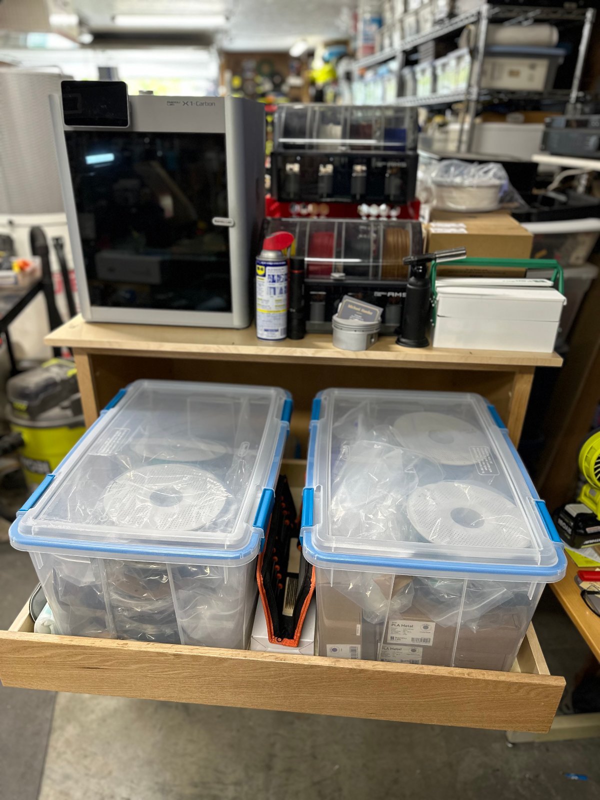

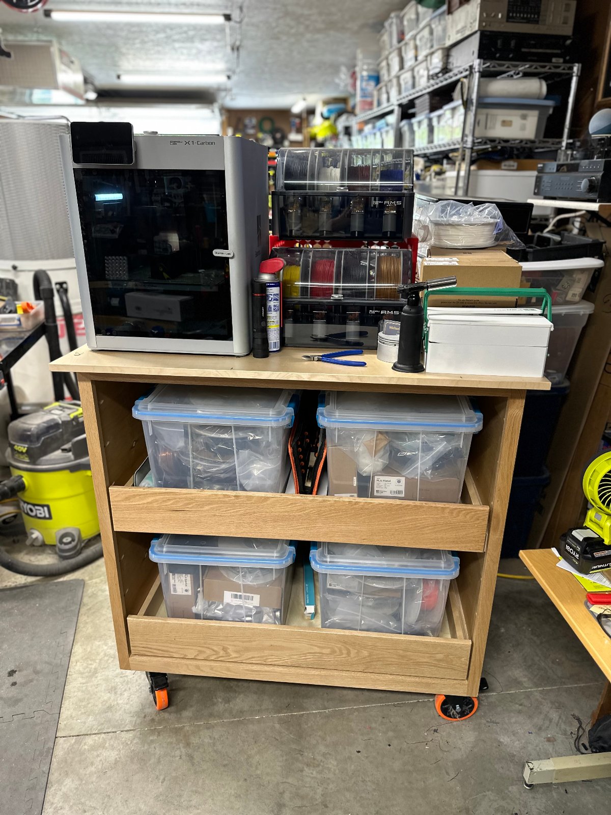

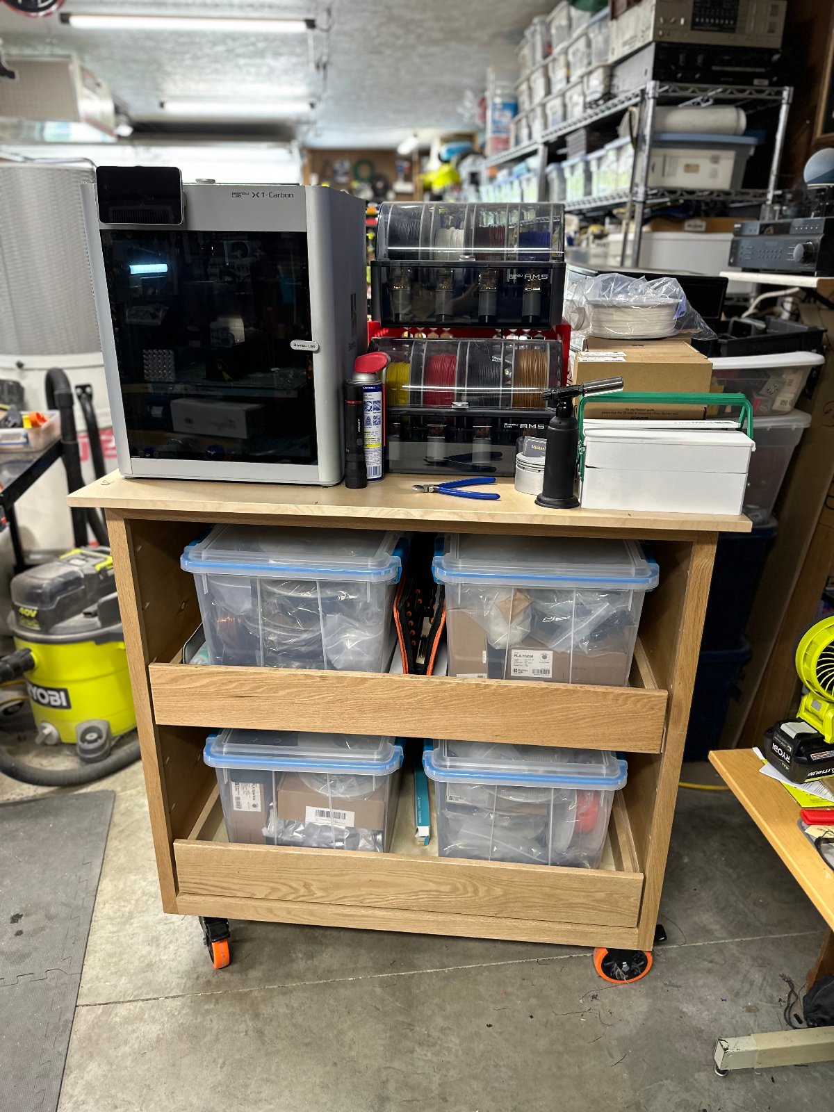

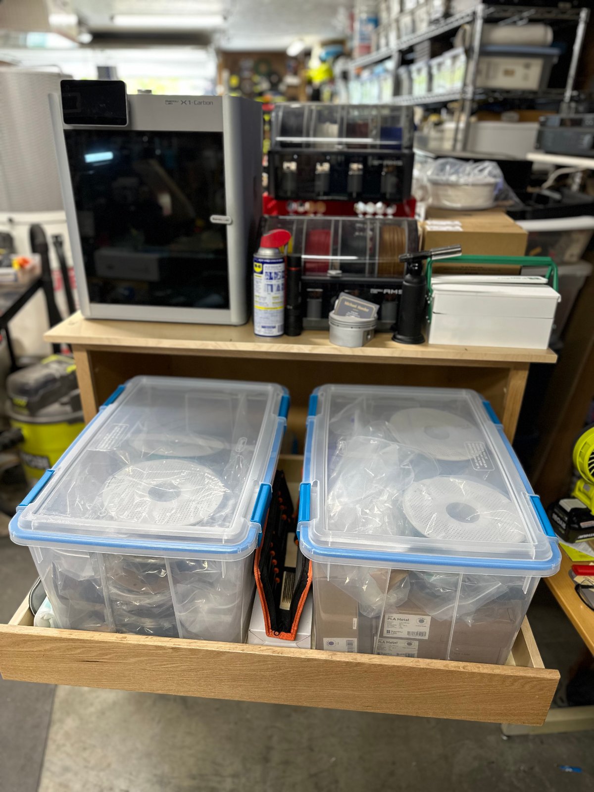

I built this cart a months ago...I made it too large, but I did it on purpose, for when and if the totes are resized when they need replaced...the Cart is on large wheels, and the drawers are full extension to allow access to the filament easily. After the filament is opened it goes into a huge zip lock freezer type bag with desiccant in it. That bag is then put into the totes which have a gasket and snap lock for further protection. I like it a lot but have outgrown it, so now I have some of boxes with new unopened filament on top. ( they are just replacement colors)
Nice cart!!! I like the setup a lot! With the suggestions of using some totes for filament storage, I got a funny feeling a project like this might be in my future! I've currently got the printer in a homemade enclosure with filter fans in it on top of a commercial tool chest. It doesn't have any space for the filament storage, as it's a drawer unit, so printer parts and supplies are spread around the garage. A roller cart might be the next home! Thank you!
Kevin
Go for it JJturner! I certainly would not be the size of mine...that is too tall...IMO. I made it that size because they will probably change the size of the totes somewhere along the line and I should be able to adapt...but I might have gotten it too big...I have 4 or 5 inch clearance on the top of each drawer. Also used 6" wheels to go over cords...they are sure nice wheels, but add to the height...and I really don't move it over cords...so that would not be needed either.
