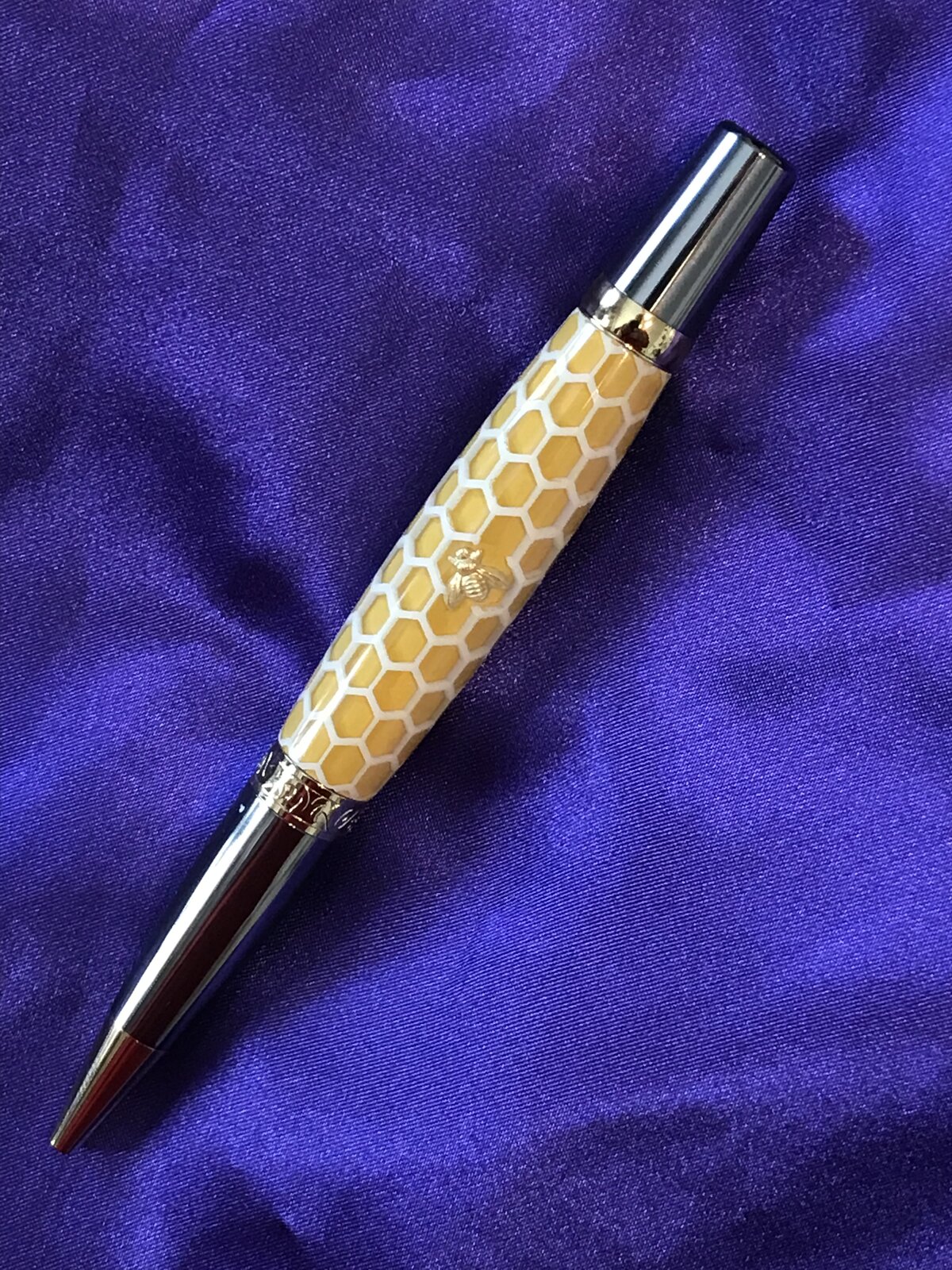

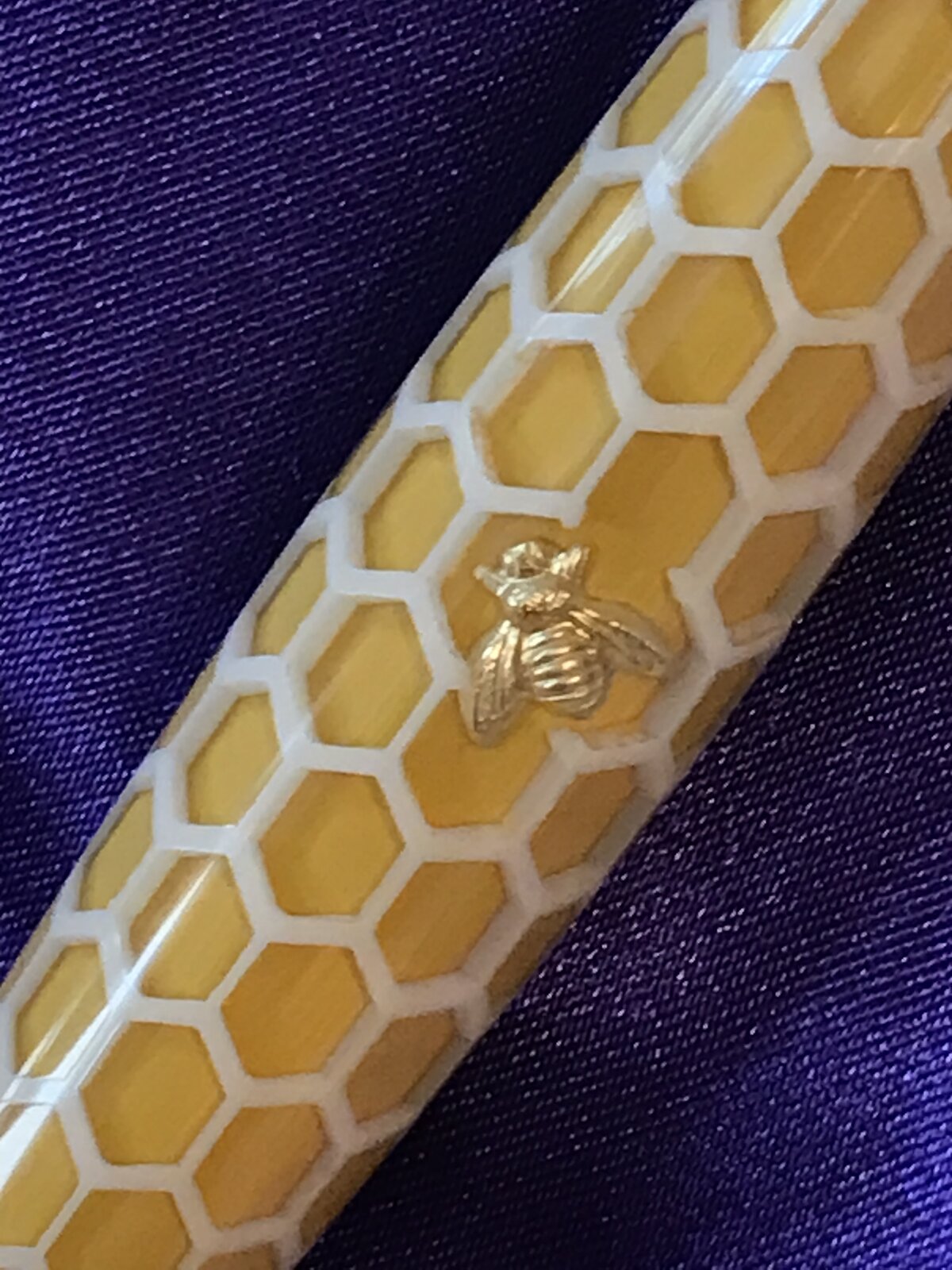

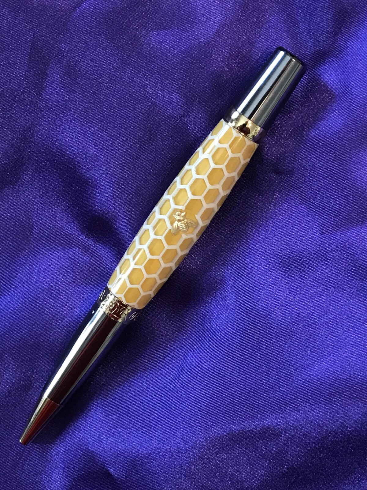

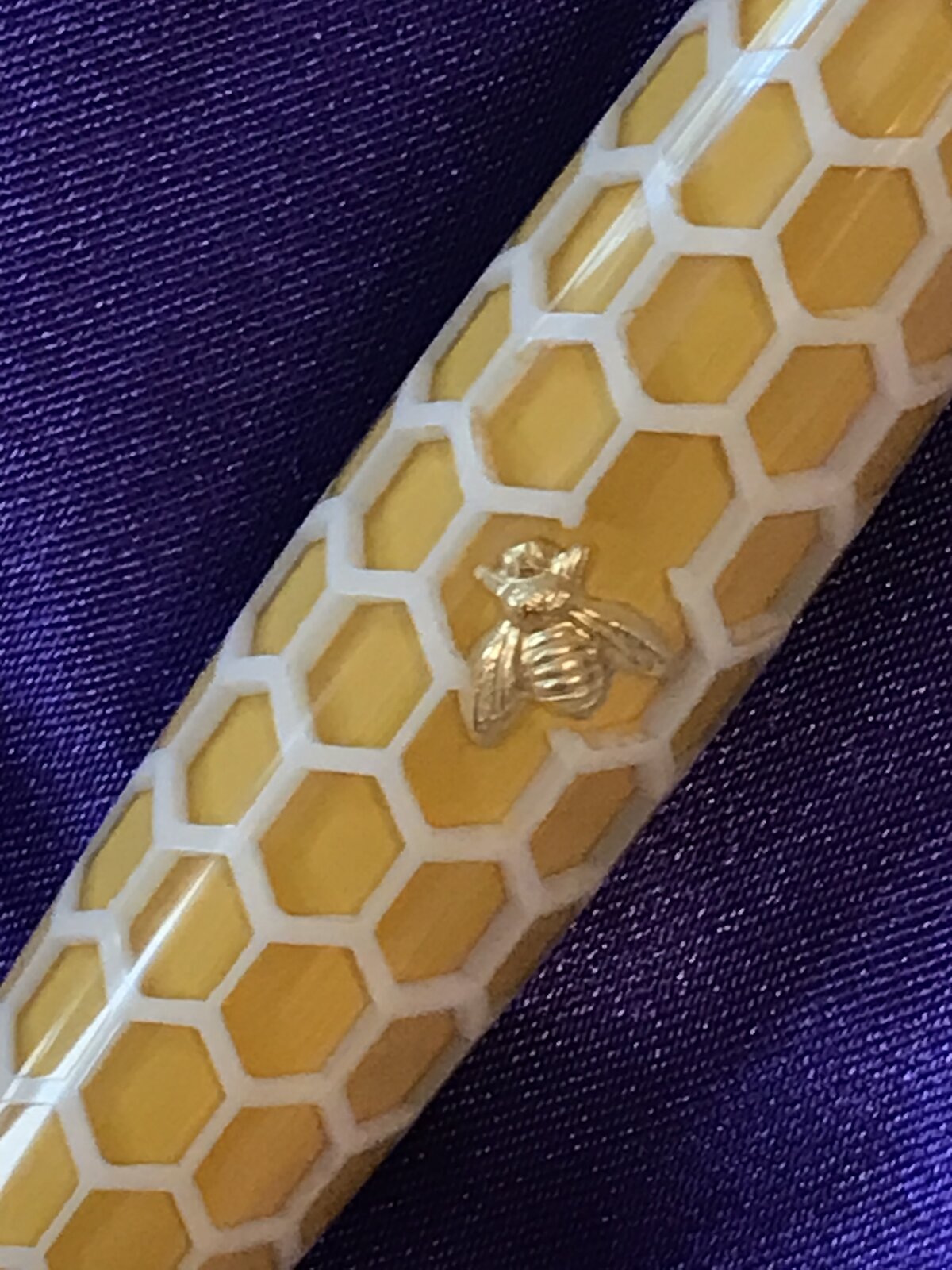

I'm not a 3D printer guy but my buddy is. He printed up some honeycomb tubes for me. I told him the ID and OD I needed and he did the rest. I put the tube in the mesh and did a tube in cast. You can't tell the plastic resin from the urethane resin. If you have the ability to 3D print the shystge limit with what you can do.

That blank would look great on a Honeybee kit!
The problem I find with PLA cast prints is after a few days you can feel the difference between materials, like the resin settles or the print expands. There is a "bump" between them. Also, some resins don't bond real well to it. I found resin printers to work better for casting but are much messier to use and make and require curing after printing. I'm not saying they can't be done well, I'm just mentioning some issues I've seen with them. The plus side Is they do open up a new level of creativity. A good CA finish helps with smoothing out the finished surface but it's still not perfectly smooth.
Ok once again I'm not a computer or 3D printer guy. Thanks for the scare John U. After reading his post I got up to check the pen pictured above. After wiping off the dust it's still smooth as the day I finished it. Any blanks that are solid resin I don't use a CA coating. I just sand and polish. Back to John post I do know that the honeycomb was made with a resin printer not a filament one. Thanks for the added information.

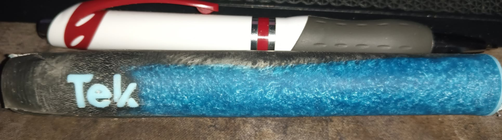

Just tried out my first Custom Blank 3D printed mold. Just some text for company gifts, it worked well. I made some noob mistakes with the text. Its not reversed on the back for instance so spinning the pen looks a bit silly. My resin didn't fully cure and I am not sure if its the type of material I used for the Blank or if my resin is just expired.
0.4mm hotend with 2 walls to get the blank to not leak resin. Going to play around with it but so far its been good.
