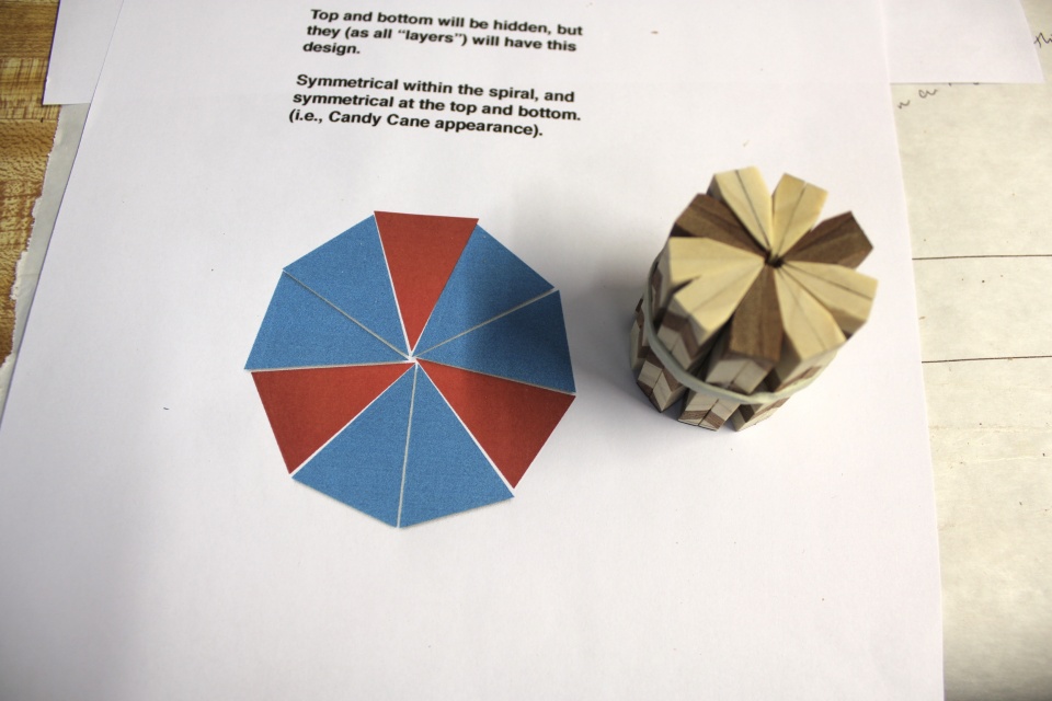

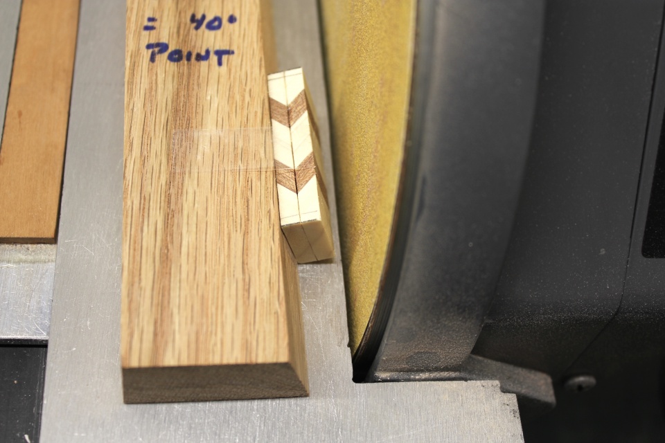

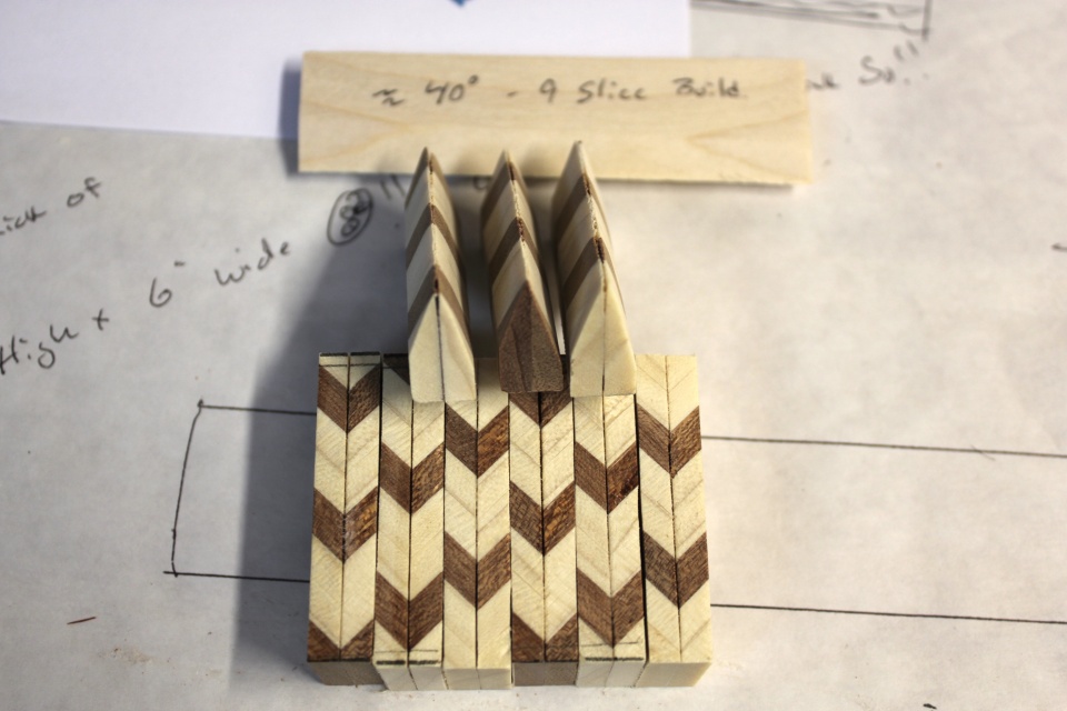

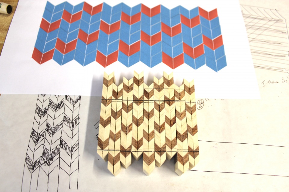

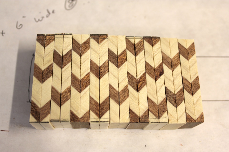

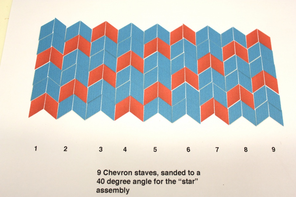

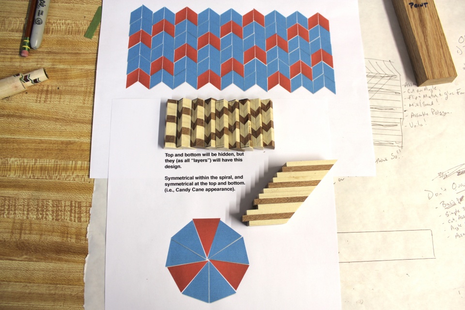

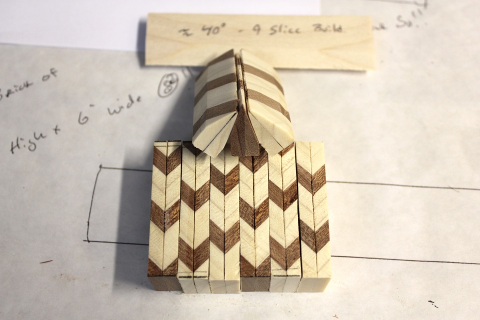

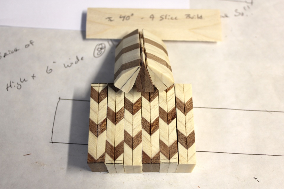

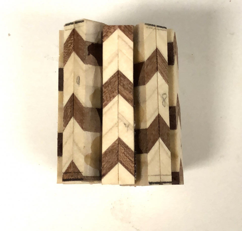

To get a better pattern for the Chevrons to spiral, I went to a 9-sided configuration. This then used a 40 degree point.
I'll put a finish on this and maybe assemble it (Sierra); there are some minor flaws, so we'll see.
Happy segmenting! Discussion encouraged.

Hi Charlie, One design seems to lead to another. This opens another entire black hole for me to get sucked into if I start to add more colors and veneers. I also really enjoy seeing others expanding and adding their own elements. As much as I like the design challenges, my precision is still my weak point, (OK, also my finishes). But I'm having fun.

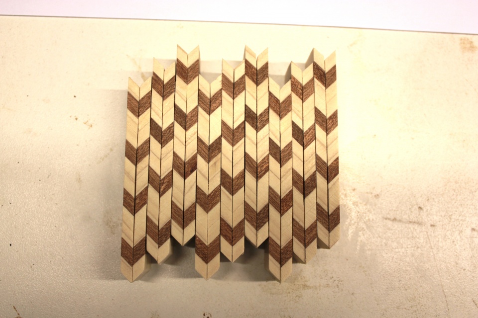

Looks good Mark. You must have tightened up your measurements.

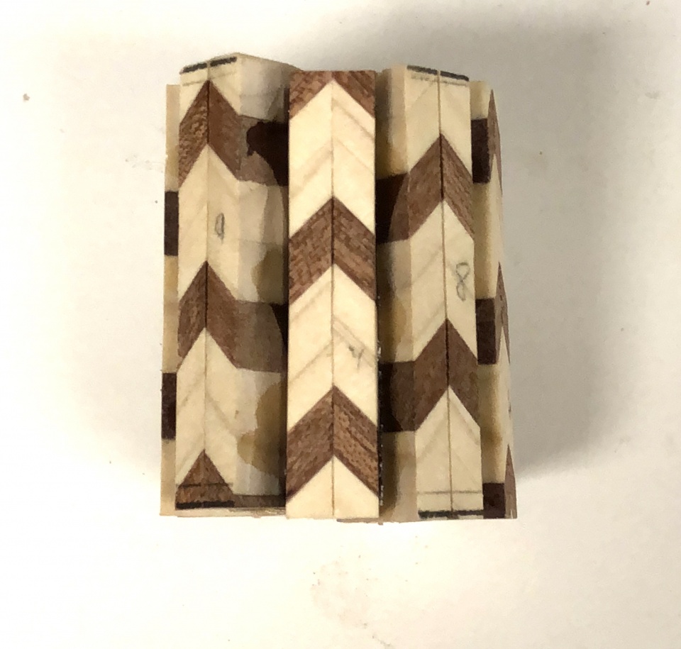

As with the last blank, it is better than I expected. Here, two of the staves are not as equal in width as the other 7, but this is close enough I may assemble it.
