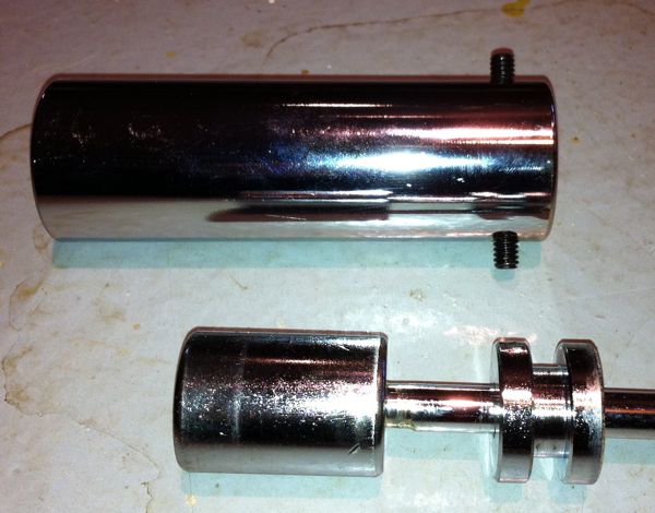

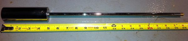

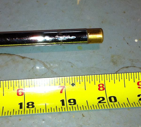

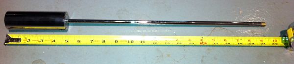

Posted this on your thread "over there" too but in case this helps someone else in the future....
Easy way is just to go buy a 3/8" or 1/2" brass rod long enough to reach through the headstock. Turn a handle for it and glue it on. Done.
The stock one is a 3/8" steel rod with a brass tip and a large steel handle that can move about a 1-1/2" to act as a momentum hammer. But just sliding the brass rod would work too.
Here are some pictures:
Closed
attachment.php
Open
attachment.php
Tip
attachment.php
And here is a photo of the handle disassembled to see how it all works:
attachment.php
Please pardon the lack-of-quality iPhone photos.
