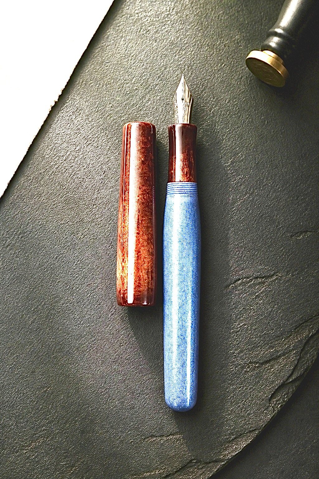

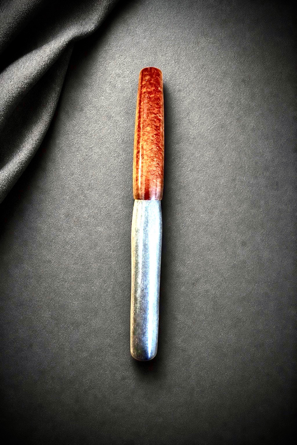

It worked well. The pen has a different feel that resin, heavier and solid
