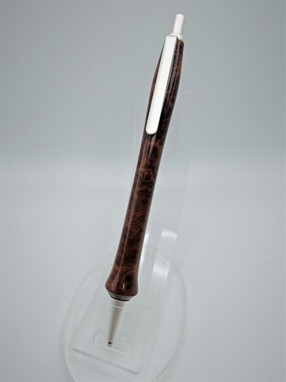

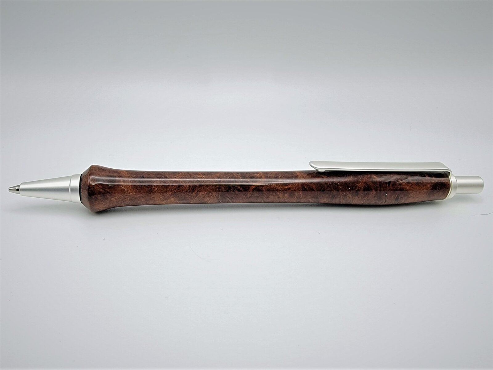

#32 - modified old slimline pencil in Redwood.
See more from Painfullyslow
Painfullyslow
Mar 5, 2022
378
Connecticut
I purchased some gorgeous redwood from @rockb recently which I just received. I had to give it a try and as I had a request for a mechanical pencil I thought this would be a good time.
I just replaced the standard "2 tube and midsection" of a slimline with one continuous 7mm tube.
This wood is absolutely stunning.
Finish is abranet to 600, Zona paper down to 1 micron then CA, micromesh, Zona, and Novus 3,2, and 1.
Painfullyslow
Mar 5, 2022
378
Connecticut
Looks great! Gorgeous wood, nice finish! Wlo's kit is that? I like the smooth, wide clip.
Thanks, I picked this up at my local Woodcraft. I think it is a discontinued model as I only see the gold version on their website and it is on clearance.
