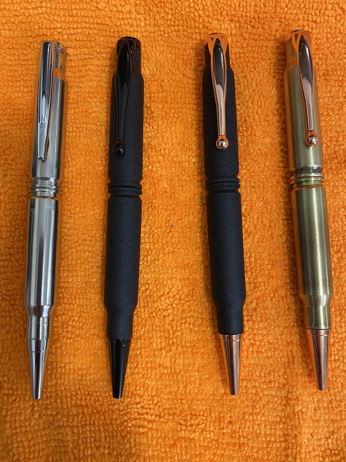

No turning on these except for polishing the brass. The two on the right are fixing to be delivered shortly. They are being traded for a used Wen dust collector.

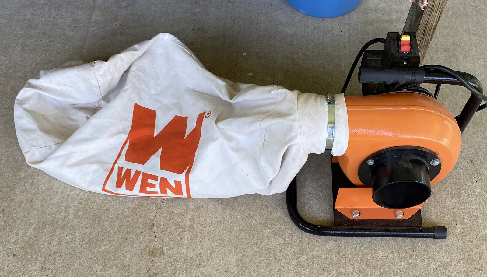

The two pens on the right was traded off & delivered yesterday. Here is my dust collector that I traded for. It is a small dust collector that will be setting up behind my lathe.
