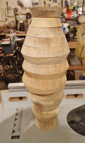

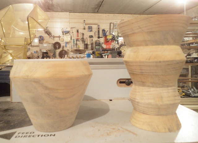

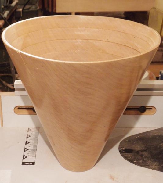

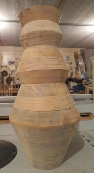

Here are a few items I made on my Shop Smith mounted Ring Master for a woodworking show demo about 30 years ago. Other then the large Curly Maple vase, that is only finished on the outside, all items are as I cut them way back when. No sanding, no finish, and most rings were never glued together. Only one ring was broken in the box in 30 years of being moved around the shop, and none have warped in that time even though they are cut from Pine. The couple pieces that are glued into shapes were done so with the old yellow glue of the time when they were cut. I guess my point is that they stood the test of time with no damage. So, Bill, you can rest assured that your fantastic creations will be around for quite some time!! These were my first attempts with my new Ring Master, so don't expect anything like the ones Bill is putting out today. The last photo is just random rings stacked together to give you an idea of how well they stayed over the years and still fit together perfectly. Each ring is 3/4 of an inch thick, so by counting the rings, you can tell how tall the object is. Large vase is 11 1/2" wide at the top, with a 1/4 " thick wall, and is made from one 12" square of Maple. Small objects were cut from 1" by 6" Pine boards. A blast from the past. Jim S
