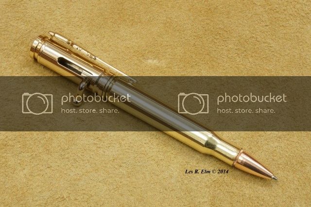

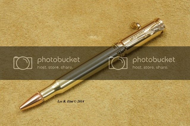

Thought I would try and convert on of my rifle cartridge pens I make from a Twist Action to a Bolt Action.
Had to drill and tap the casing primer pocket and cut threads to match on the Bolt Section to thread the Bolt section into the casing head.
Modified the Cross refill and couple of Parker refill springs.
A work still in progress.
